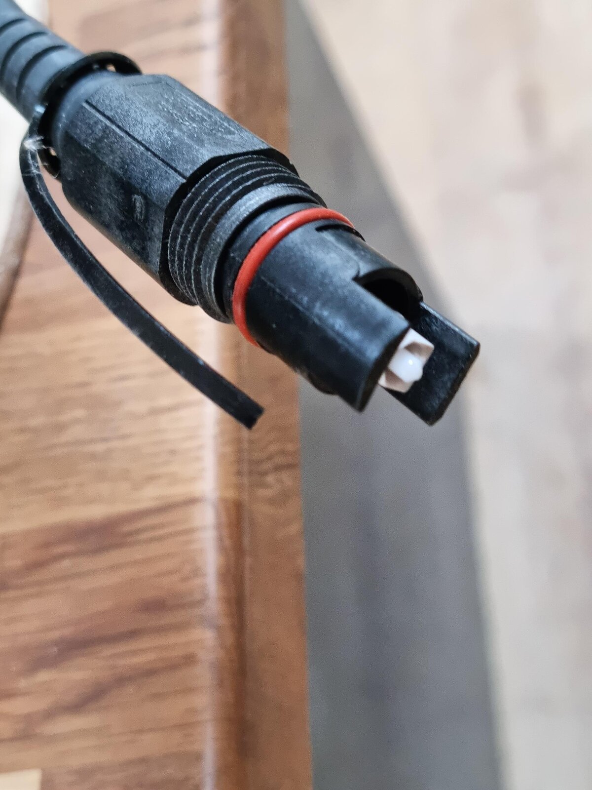

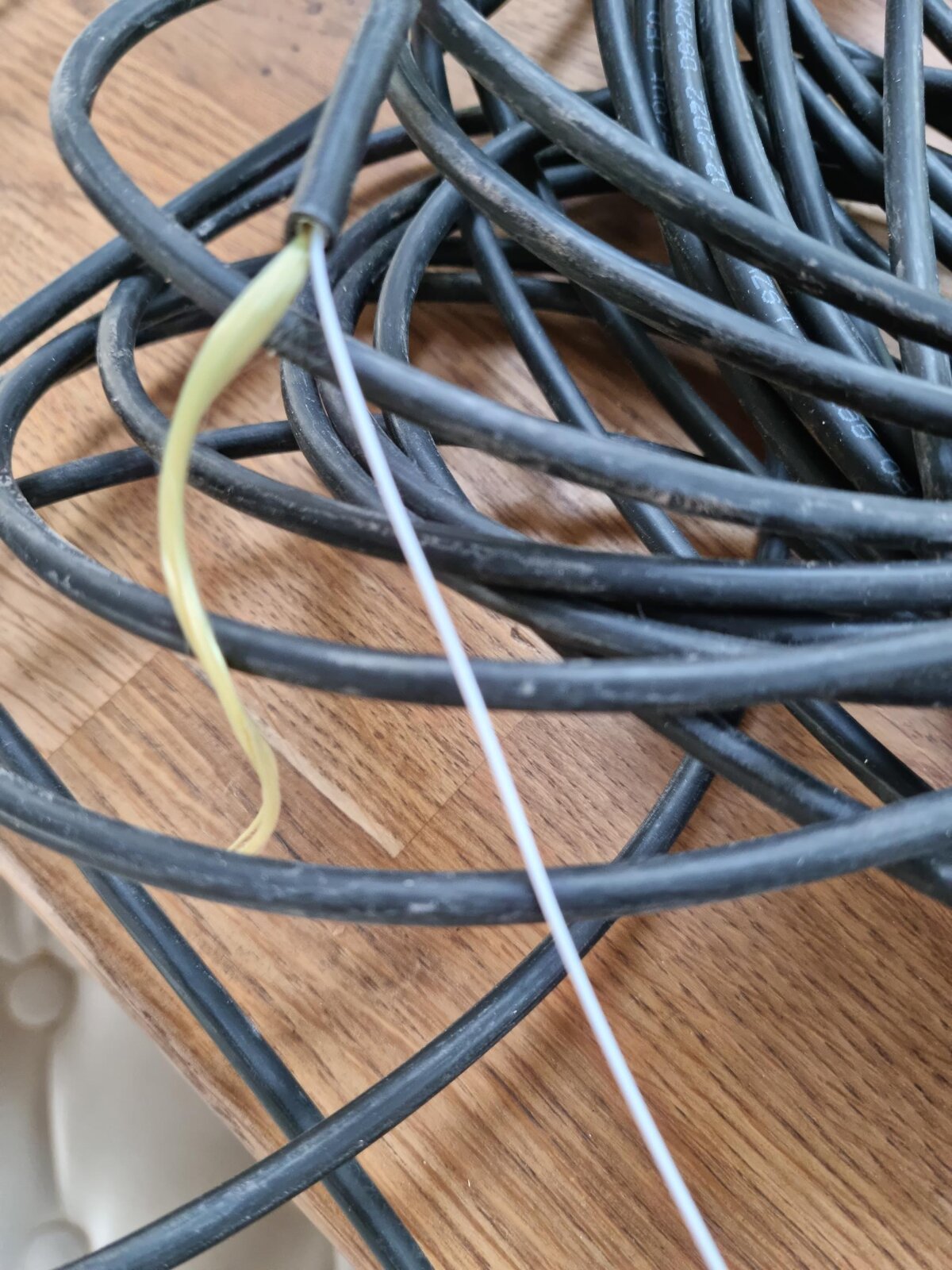

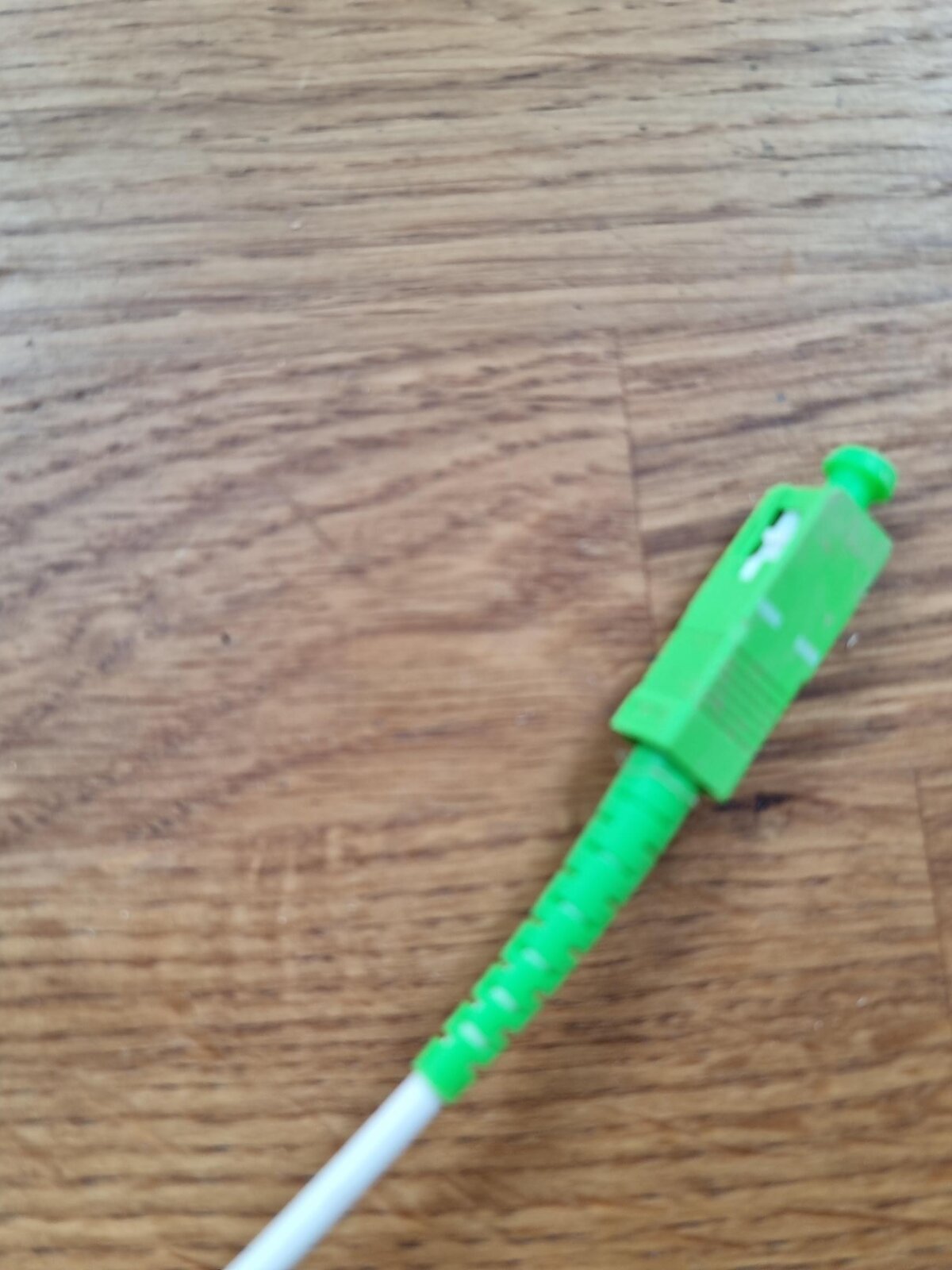

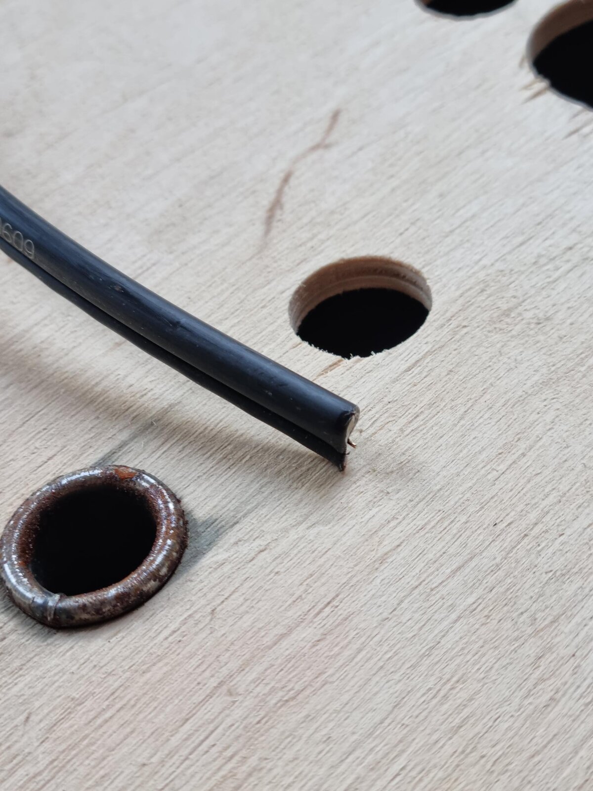

I'm currently renovating a property so while I can get access under floors etc I want to run my cables. The one I'm confused on Is how broadband fibre is installed. I know the green connection goes into the box that's fitted in the house, this box would then be connected to the router. I'm not sure what the other end connects to and also how the other length of wire I have is installed.
We don't yet have fibre in our area but I want to get this installed to avoid having to run surface wires in the future.
One of my cables has a green connector then bare wire the other end.
The other cable has a large black connector with bare wire at the other end.

The black barrel type connector is meant to connect to the fibre distribution point on the telegraph pole.
You shouldn’t do anything with the fibre side of this yourself. You need a new installation or the existing installation fixed by Openreach (or whoever the network provider is, but it looks like Openreach) arranged by your Internet provider.

That's the reason I'm installing it myself. I spoke to a guy from openreach who gave me the cable with the green connection and told me to route this to where I want the router. I was hoping this cable would be long enough to reach to the front gate but it's not. Does anyone know if the bare ends easily be connected together by an installer?
Install ducting, and when fibre is available it can be pulled through that.
That sounds like the best idea, I'm installing underground ducting anyway from front gate to house, I'll install the longer cable with the black connector in the ducting and have the other one running from the hall to where the ducting comes in. That way they have 2 bare ends, if they can connect them together then great, if not then maybe they can pull the new cable through the ducting using the one I've installed. I just don't want wires running along my external and internal walls when I do eventually get fibre
The fibre you have with the green connector on is the Internal Fibre. Run that from where you want the ONT and Router to be located to a suitable point on the outside wall; normally either under where the drop wire attaches to your house or where the underground cable rises but as you are installing the internal fibre cable yourself you do have a degree of flexibility. The internal and external fibre cables are spliced by OpenReach chaps and the excess is coiled up in a grey box attached to the outside of your house.

That sounds ideal, so I can get this 100% in my head. I'll run the internal one to a discreet place on an external wall. I can then run the external one from that point to the front gate.
The installer can then connect the 2 wires on the outside of the house and then they can connect from the street or wherever to where my cable goes to the front gate. Sounds simple enough
