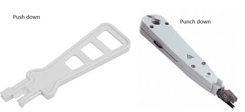

I pressed down the insertion tool onto a module on a bathroom scale and gradually built up pressure until the wire went into the IDC slot.
Was that a push down tool or a punch down tool.
The mechanism in the punch down tool produces a short pulse of a much higher insertion force than can be achieved with a push down tool.
The short duration but powerful force from the punch down makes a far better joint and the prongs of the fork are much less likely to deform into a wider slot for subsequent conductors
