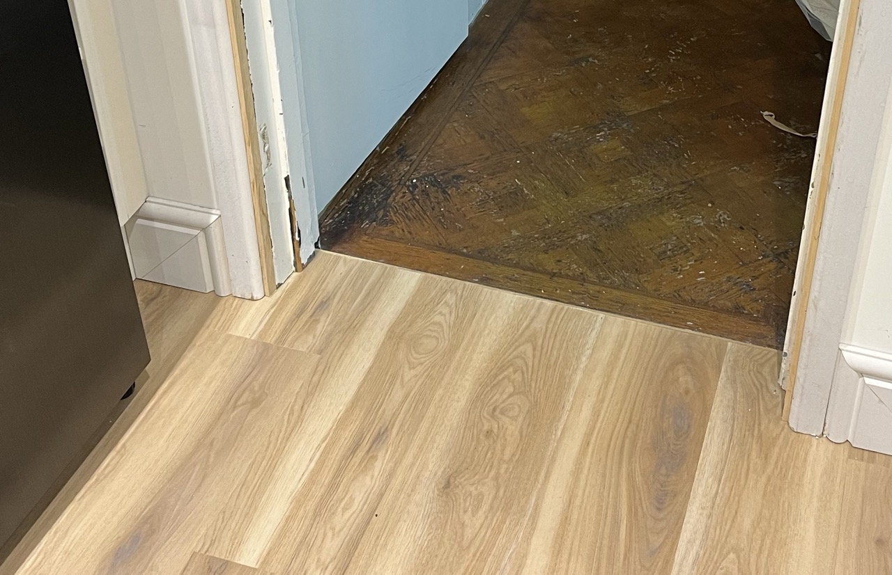

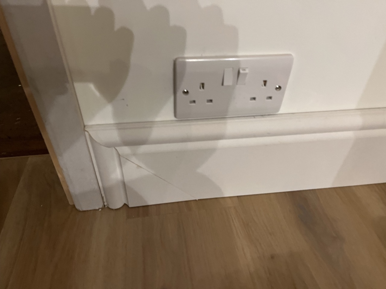

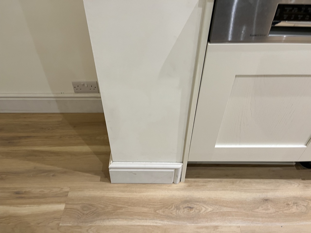

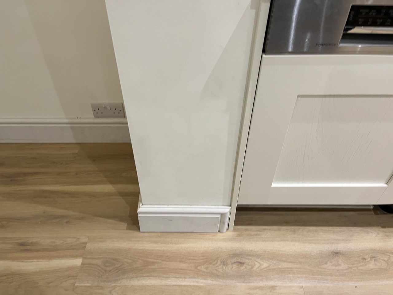

Has anyone seen skirting laid this way before? Not my DIY. Was the builders carpenter son, but I may have to fix it DIY.

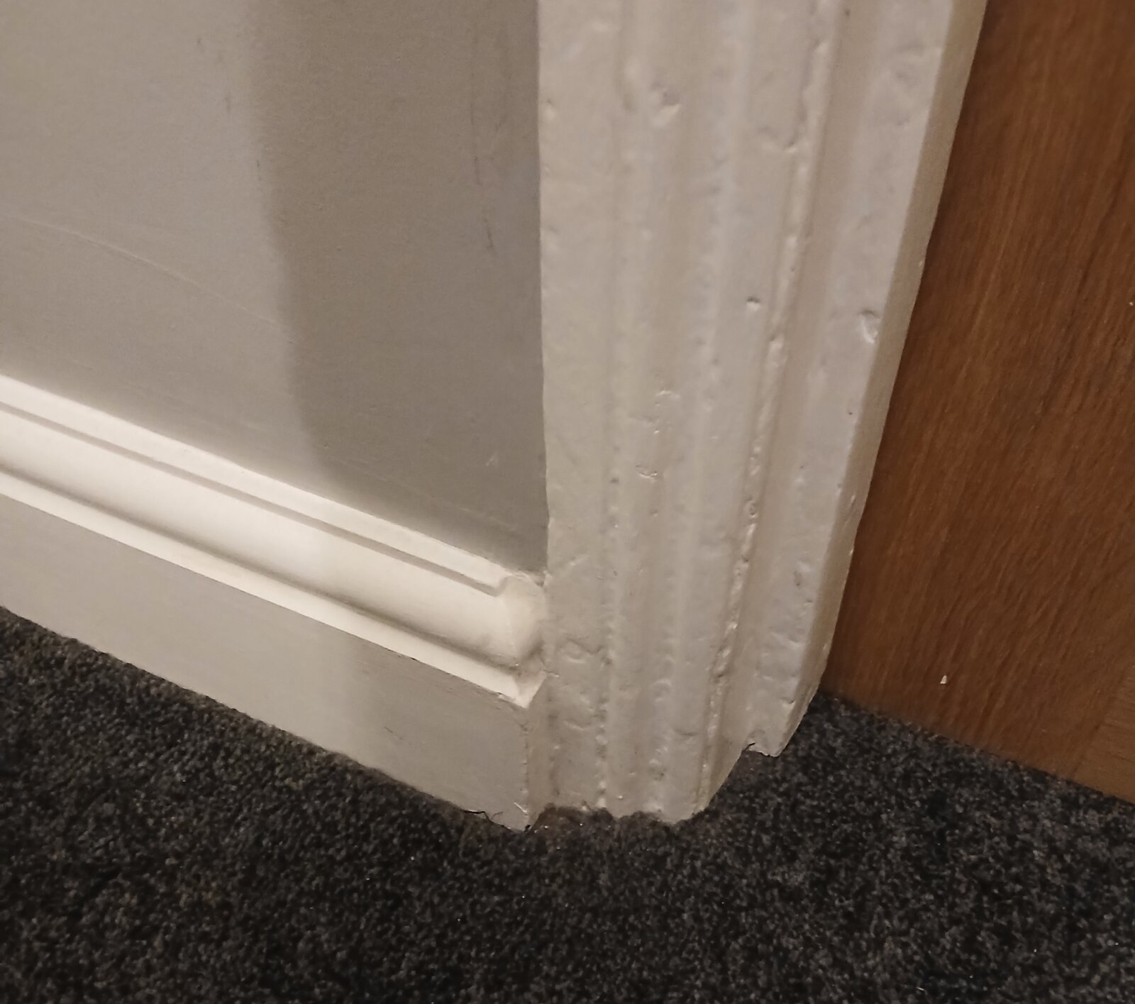

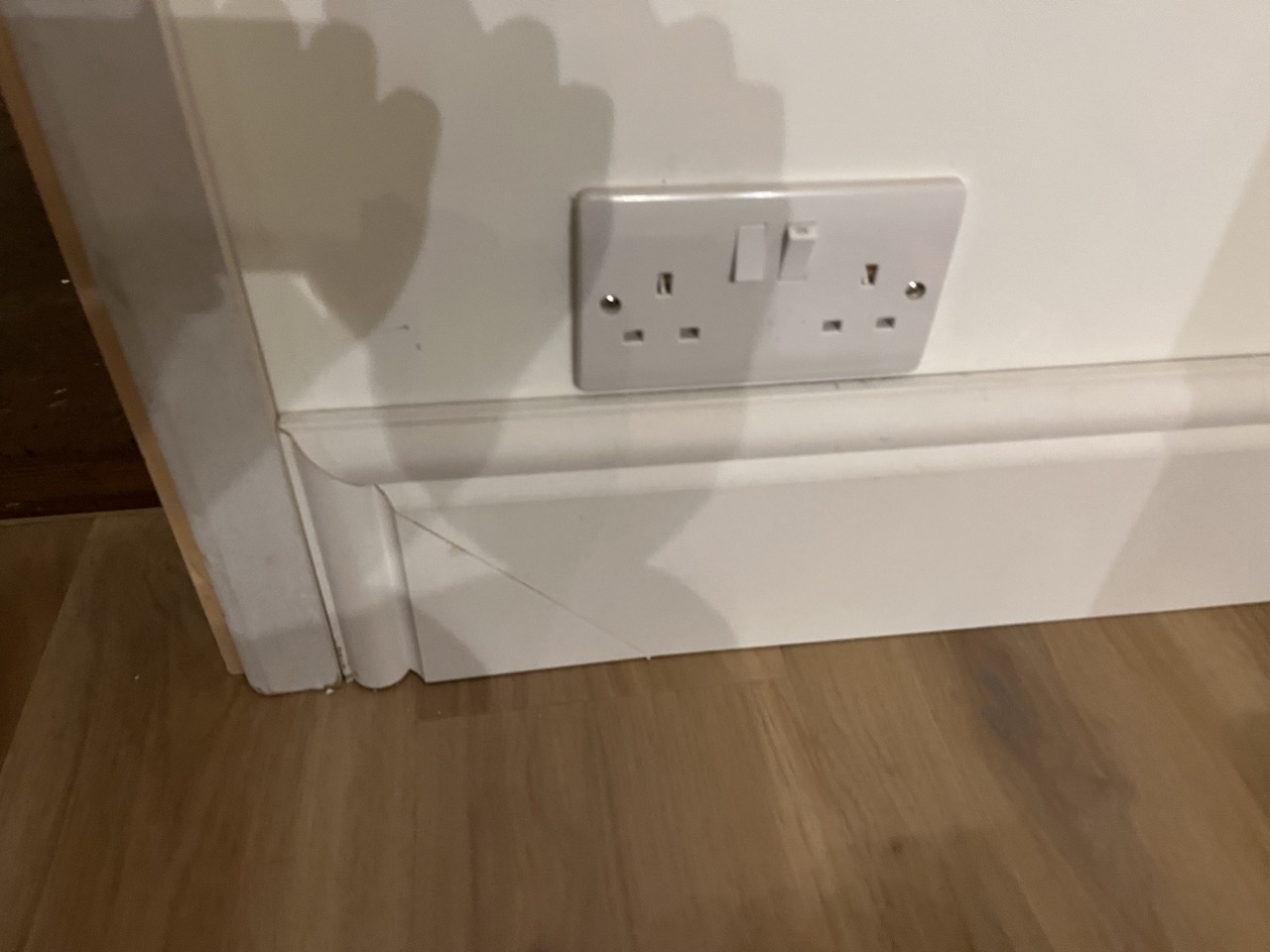

It's a feature to be sure but like you, not sure that I like it. Amongst other things, you're left with that big join running diagonally which needs filling and sanding.
Yeah, I think it looks crap TBH, but I'm trying to be objective as maybe it's just me and I've never seen anything like this before?
It is done like that because your architrave is smaller in depth than the skirt otherwise you will just have a cut off end showing. It could of been done with the join being disguised by the profile
2mm thicker! Surely it’s not just me that finds this odd?

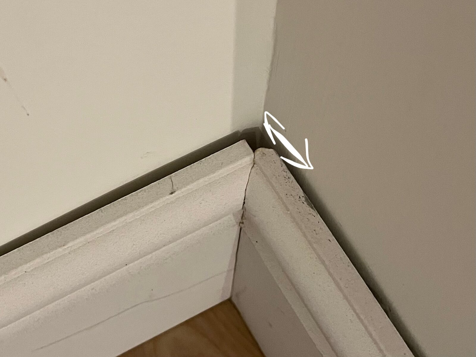

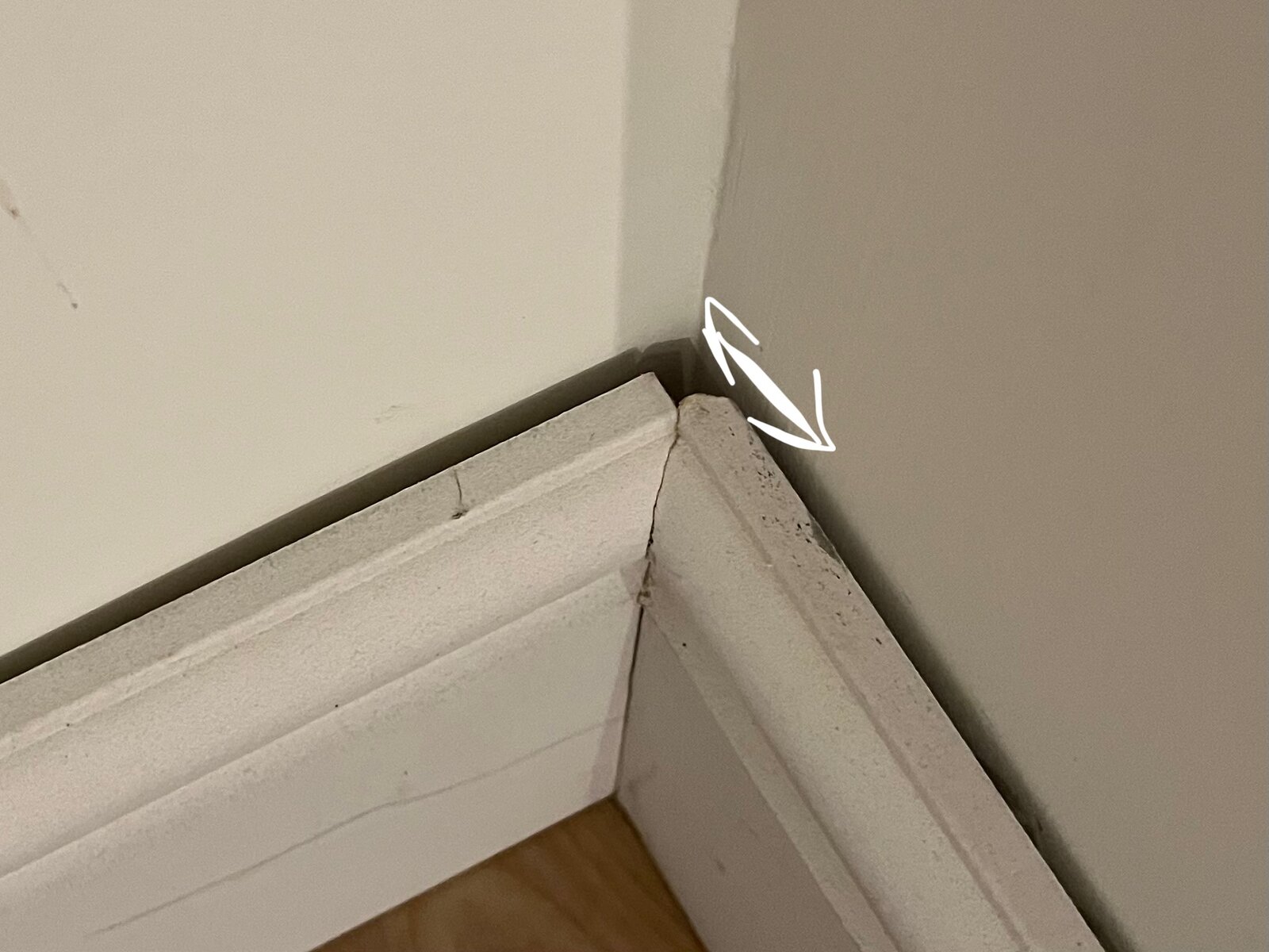

A couple of lengths cut short too.

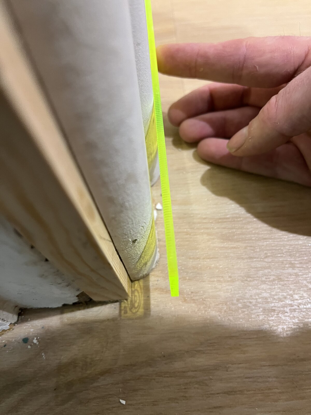

this looks to me like they have attempted to do it correctly via scribing and not mitring so its actualy the one on the left that is too short, internal corners are best done with one cut square and the other scribed
Thanks. I’m learning too. I think it’s something that I’ll sleep on and decide if it will drive me nuts or not. A fair bit of effort to change and I really don’t fancy the builder sending his son back round.

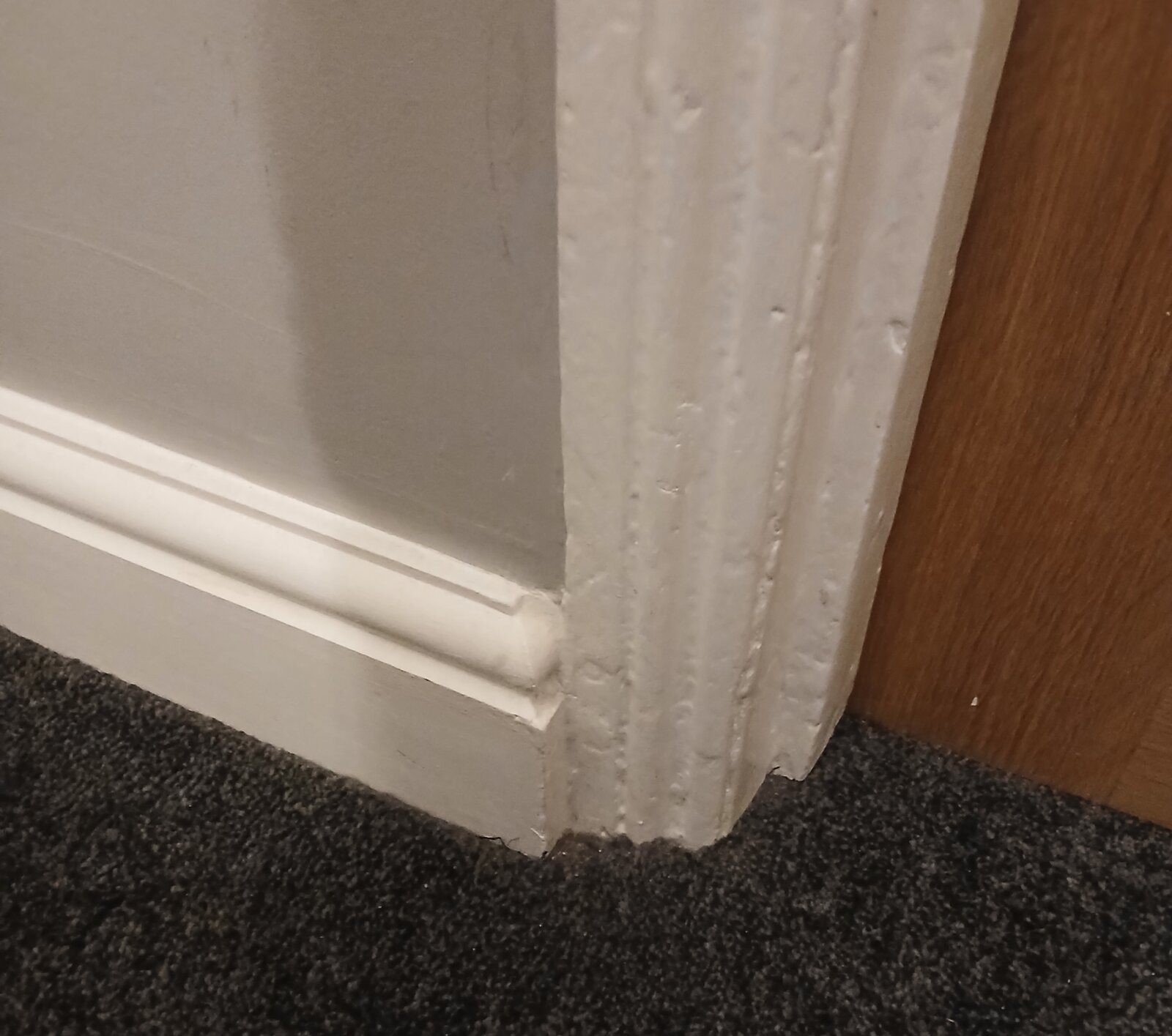

As you will be painting it then that big diagonal at the architraves can be sanded and filled but I do think what they were trying to acheive was the right way. Or a shallow bevel from the architrave away may of worked or better yet new architrave in a tourus profile to match the depth of the skirting with then no need for the fancy bit.

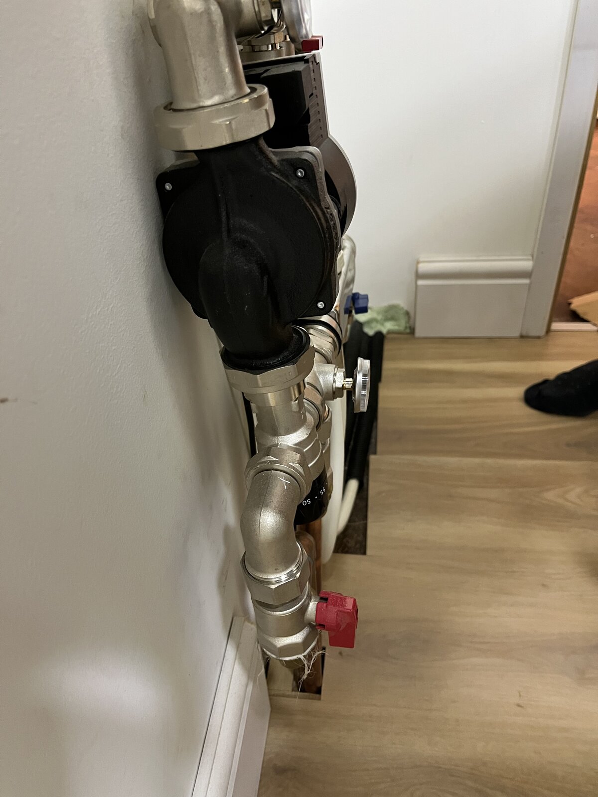

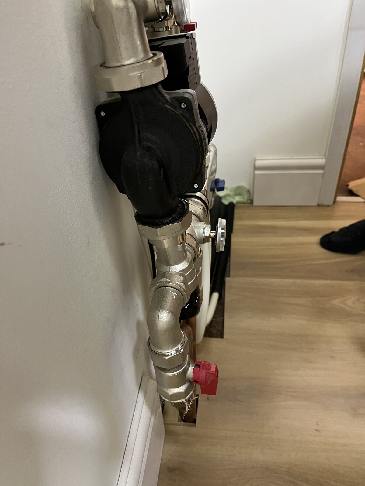

The second pic, they clearly intend to box that pipe-work in. The laminate has been held back as well as the skirting.
The first pic, yes the skirting is slightly short in the corner but, assuming you are going to be painting it then all the gaps can be caulked and you won't even see it. A different matter of course had it been exposed oak etc.

Actually, I’m boxing the pipework in, but not that far out. I found a discarded length of skirting out front that will allow me to sort that at a later date. You’re right, I just think that communication is important when you get to some of these interior decisions. And also common sense by looking at what the rest of the house looks like.
