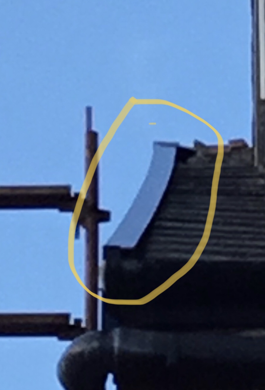

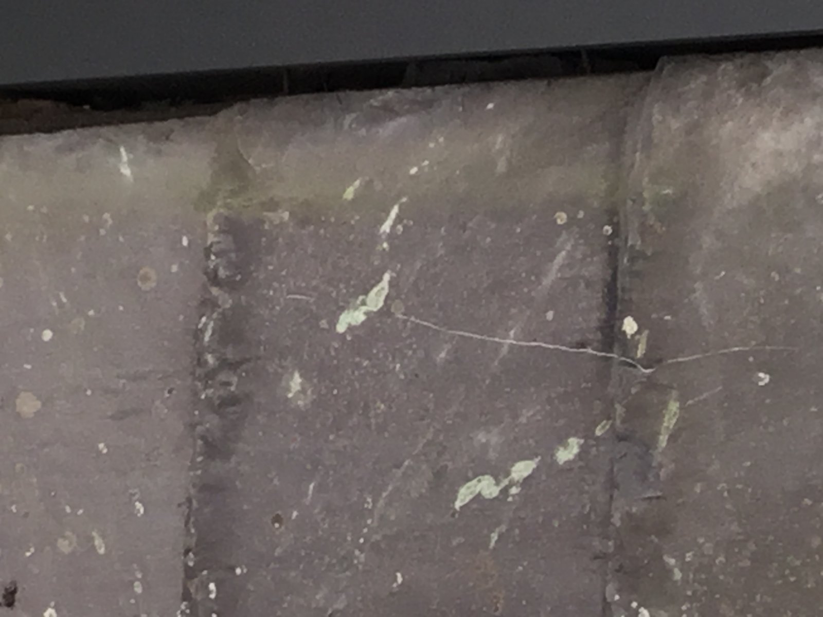

Hi there
Having plastic fitted to house but not to impressed shouldn’t capping meet up with the slate ?
What’s your views before they ask for payment

Looks like a mess to me, How about a picture square on.
I see nothing so far worth paying for

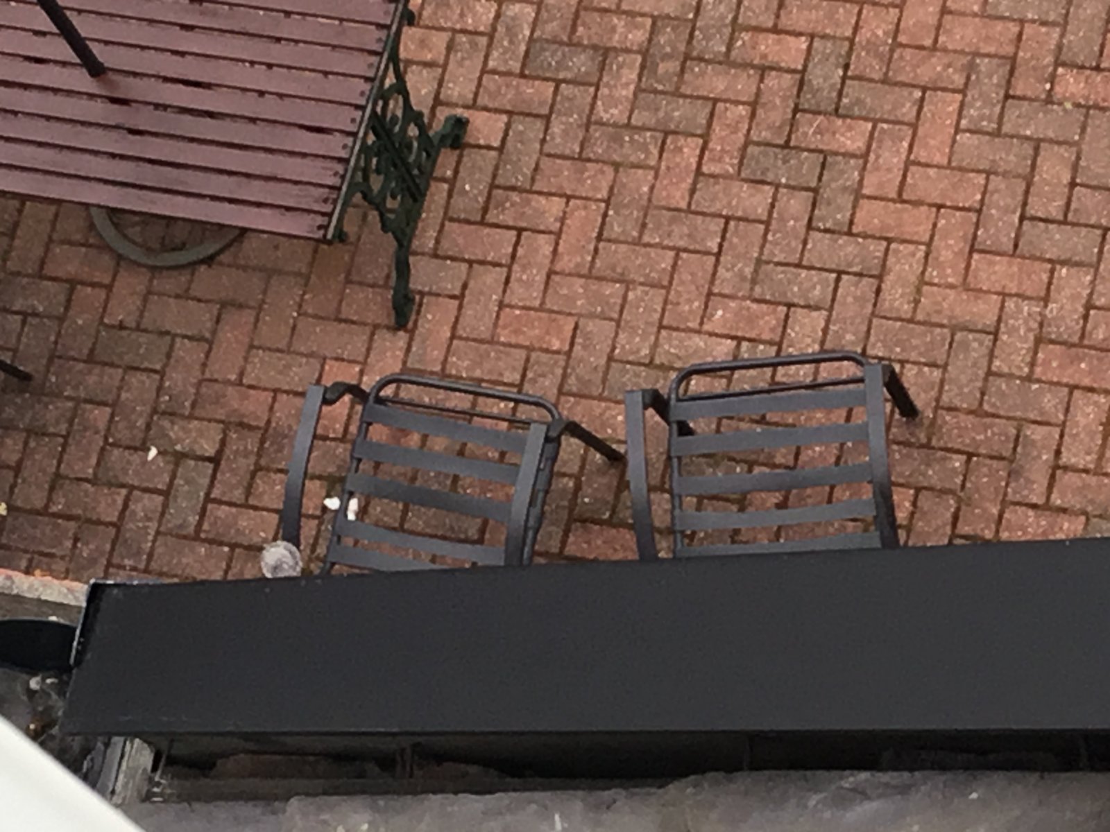

Best photo i can take as through an open window
From the ground

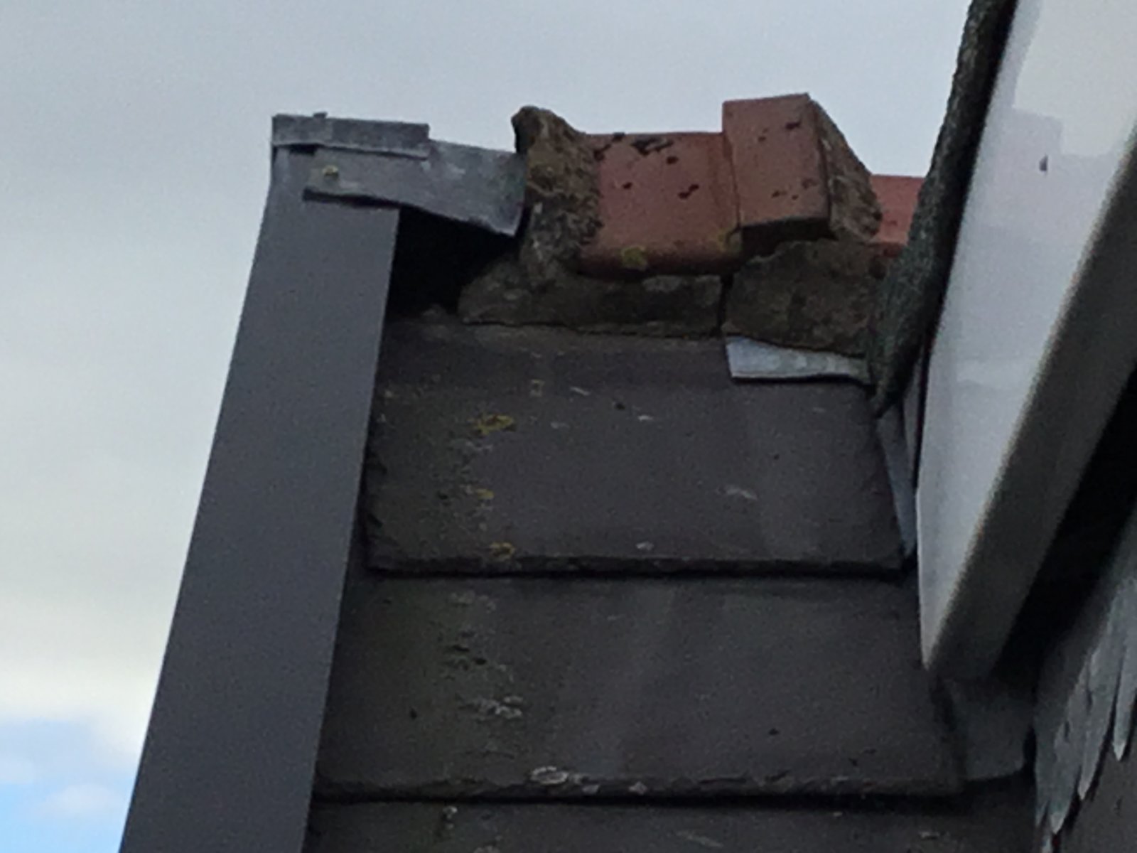

Had fascia and capping board replacement

I’m still trying to work out what’s been done. Do a far away pic showing the gable front on.
Hi gable end covered fascia and top cap
Will put up front on pictures tomorrow as got to go into neighbours
Back gardens
You dont pay anything for that.
Where did you find those people.
Looks like they've installed some dry verge system? But it looks like a pile of ****.
I wouldn't pay.
