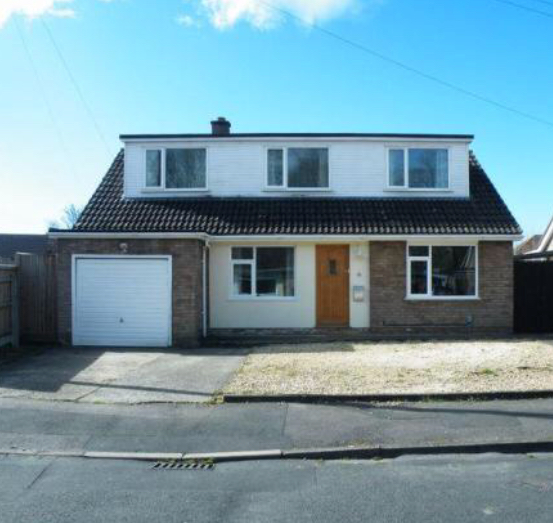

we would like to fit some oak wood cladding onto a section of wall on the front of our bungalow which also has a window in it.
The wall is plastered.
Is this a fairly easy diy job?

Apologies.
Its a detached bungalow. In the centre is our front door and dining room window.
The wall is set back slightly from the rest of the house. We want to wooden clad this wall including around the window and front door.
Have a search for timber fladding detail.
https://russwood.co.uk/exteriors/cladding/cladding-support/#3.8
Assuming horizontal boarding:
You need 50 x 25mm tile battens, fix them vertically. Stopping at dpc (about 150mm up).
The battens are important, they create an air cavity allowing the back of the boards to breathe and dry out.
You may need a bigger window cill.
Mesh at the bottom keeps the cavity open to air movement but stops insects nesting.
You will need cheeks at the sides of the window -you may be able to use cut down cladding. The cheeks are wide enough to come just in front of the cladding. The cheeks stop down to the cill
You can just get a upvc over cill or aluminum pressing.
