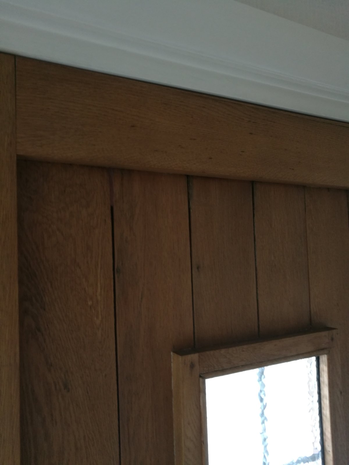

Hi all,
recently moved into a house that has a draughty front door through the gaps in the timbers, see photo. Any suggestions on what product to use to fill these gaps?

Probably been neglected and over dry, generous coats of thin oil and allow to penetrate then wax.
the joints look pretty close to me. I have a LBF door clad in T&G, I had to lift it off its hinges and lie it flat to get the treatment into the joints.
Come damp weather, yours should close up.
thanks, i`ve bought some dark gap filler thats in a sealant gun so hopefully can just fill the gaps.
