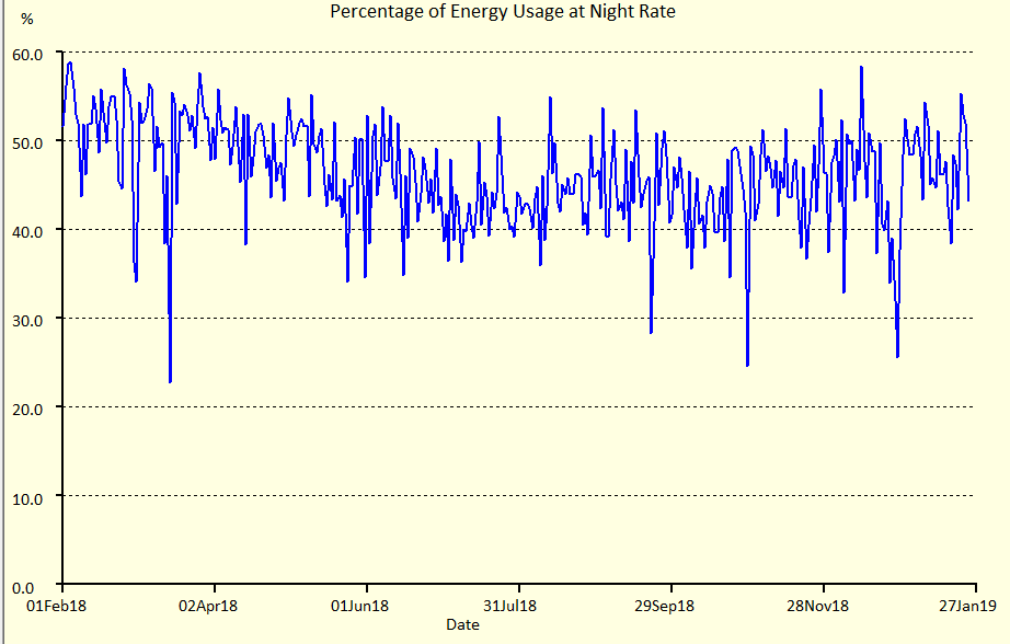

I agree that, in the absence of night storage heaters, it is almost always going to be cheaper to have a single tariff. However, as I've pointed out before, that's not inevitable, so it's probably worthwhile looking at one's individual circumstances before deciding to get rid of a dual tariff, even if one doesn't have storage heaters.
I am probably extremely atypical. However, as the below graph for the past year shows, with cheap-rate electric water heating and given our semi-nocturnal lifestyle which enables most high-load appliances (WM, DW, Dryer) to be used at cheap rate, we generally manage to maintain 40%-50% of our usage at cheap rate. With the financial break-even point being about 35%, the effect of this pattern of usage is that our electricity bills are 10-20% lower than they would be without the dual rate (in our case, E7) tariff. (The dips down to low cheap-rate % relate to days/periods when daytime usage was high {usually because of visitors} - which can be seen most dramatically over the recent Christmas period)

My energy usage is monitored automatically, 24/7. The above graph (and many others) is derived from the resulting stored data, which consists of measurements taken roughly every 12 seconds - although the graph above obviously relates to day and night totals on a 'per day' basis.

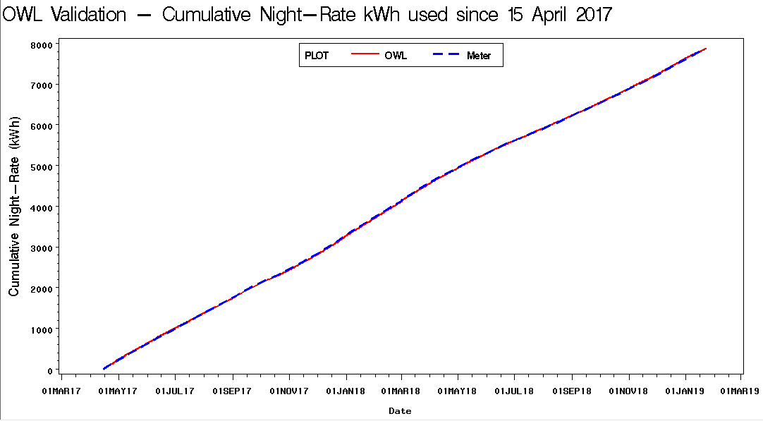

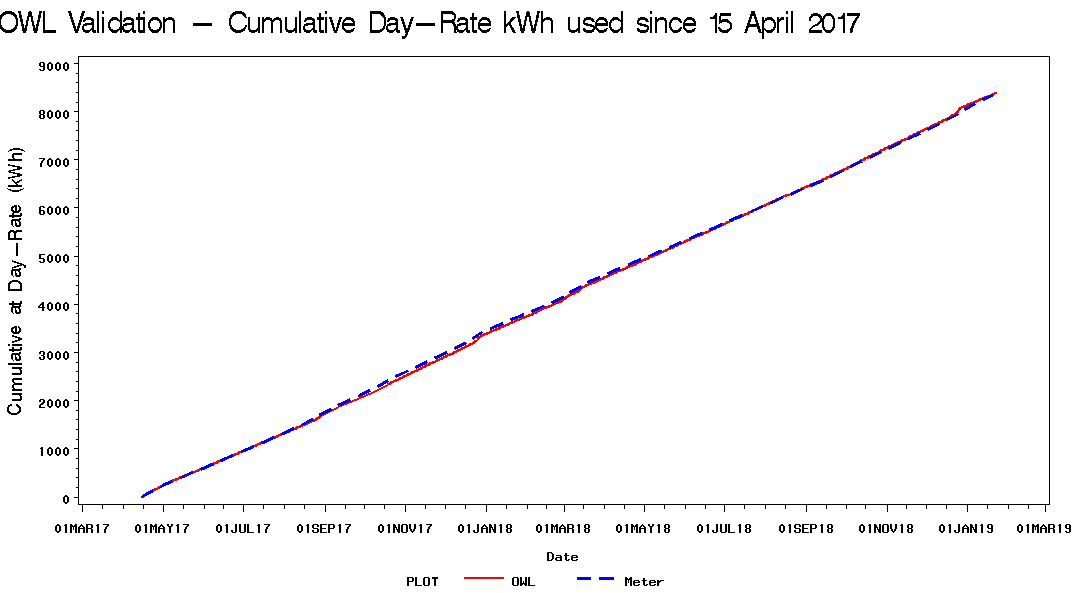

... However, it is more than adequate for my purposes and, despite the shortcomings I've mentioned, has produced results extremely close to those of my supplier's electricity meter (which measures true kWh, constantly taking voltage and PF into account) - I'll see if I can find the graphs that demonstrate that!
Here you go ... separately for day and night usage, a comparison over the past couple of years of my cumulative usage as indicated by my supplier's meter (true kWh) and the OWL system (kVAh, converted to kWh with assumptions about voltage and power factor). As you can see (and despite what some might expect), they are as identical as makes no difference!
Kind Regards, John
It's accurate enough then!
Indeed so - more than accurate enough for my purposes (probably almost anyone's purposes!), and almost perfect. Over the period of those graphs, the totals for meter and OWL were 8336 and 8344 kWh respectively during 'day' (<0.1% difference) and 7830 and 7833 during 'night' (<0.04% difference).
I already knew that my average supply voltage was about 240V, and sticking with that figure throughout seems to have worked fine. For the first few months I had to keep my eye on the power factor I was assuming, and tweak my calculations appropriately, but eventually settled on 0.940 for 'day' and 0.978 for 'night' (very high, since night usage is dominated by immersion heaters, which are virtually pure resistive loads, hence a PF of ~1.000) - and I've now stuck with those figures for well over a year.
