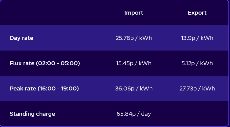

The problem is, one can't forecast how much sun. With payment for export, the Octopus Flux tariff looks good Oct tariff.jpg so three stage the highest cost 4 pm to 7 pm, I looked as far back as I could, and only found two days when battery run out before 7 pm, so seems good, and standard tariff is less than either rates with British Gas.

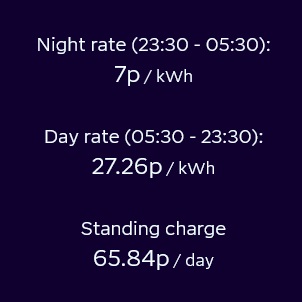

@StephenStephen the Octopus Flux I showed the rate #3 the Octopus go 1744011015537.png does not seem to give an export rate, It is similar to the British Gas EV rates slightly better 8.5 v 8.95, 30.17 v 31.31 but 67.38 v 59.14 on standing charge. Octopus EV Oct tariff EV.jpg is far better, don't understand why only offered to EV users, but with both go and EV it does not state export rates.

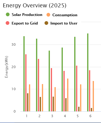

I have 6.4 kWh of storage, but yesterday produced 35 kWh of solar, exported 18.6 kWh, I could not get batteries large enough to store that, 12.8 kWh is limit on my inverter, also the inverter is only 5 kW so if I use more than that is taking it from the grid.

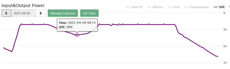

Typical when charging overnight showing state of charge of battery and this

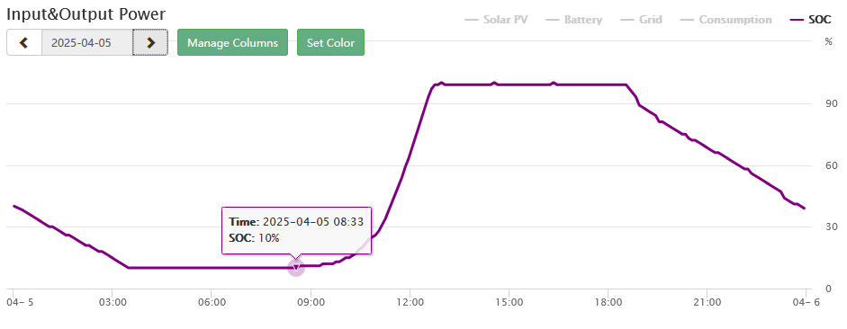

When not charged overnight, so 3 am to 8:30 my battery was down to the reserve of 10%. So imported 2.2 kWh for the day, next day imported 1.7 kWh and today solar just keeping pace with background use, 9:15 am so seems likely I will use around 0.8 kWh this at a standard rate, where when using off-peak only 8.95p per kWh, but with off-peak, not seen less than 6 kWh used. Since often washing machine, tumble drier, and dishwasher ran at night, looking at around 8 kWh off-peak used.
The flux off-peak is more expensive, so it may be that I will not charge for the full 1.5 hours it takes from 10% to go to 100%, but at 2 am battery between 22% and 37% so even 1 hour charge, will likely fully charge the battery, get around 30% in half an hour, so that's at least 2 kW every night. And then come winter, will it run out?

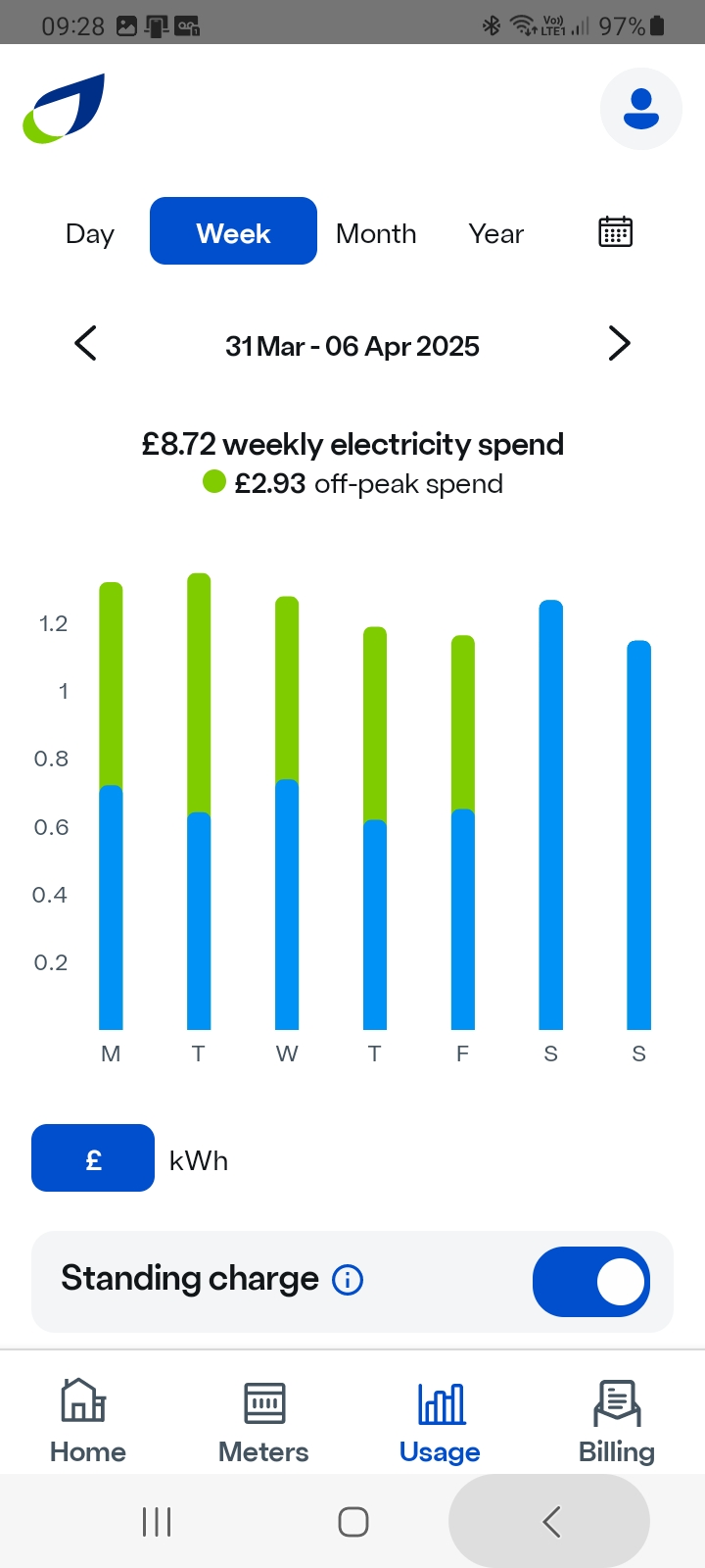

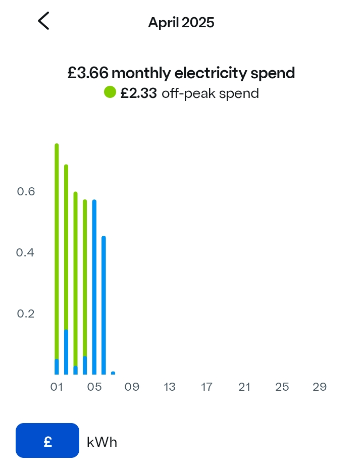

Well, this screenshot BG Energy WE 6th April with SC.jpgshows what happened when my off-peak contract ended. It includes standing charge, as that also changed. This time of year it seems off-peak or not makes little difference.

I was worried about the cost during the transfer, having returned to standard single rate while the transfer is going on, but the cost seems about the same.1744110415243.pngSeems I have been charging the battery with off-peak, then exporting without the SOC dropping much. Just crossing fingers now.

This is the problem, even when one is paid for export, the rates are not the same, so for example Octopus Flux, you import at 15.45p overnight, but export is 13.9p later in the day, so for every kWh more than required, it costs 1.55p which is not so much in the grand scheme of things, if you can export 4 pm to 7 pm then 27.73p, but if you run out 36.06 to import.

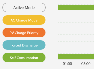

I can set time 1744290024822.png to charge batteries, and for that matter discharge, but it does not seem to give an IFTTT option of charging until at 50% or discharging until 50% so I could set it to only charge for ½ hour, and how much they would have would depend at what was in them when they started.
