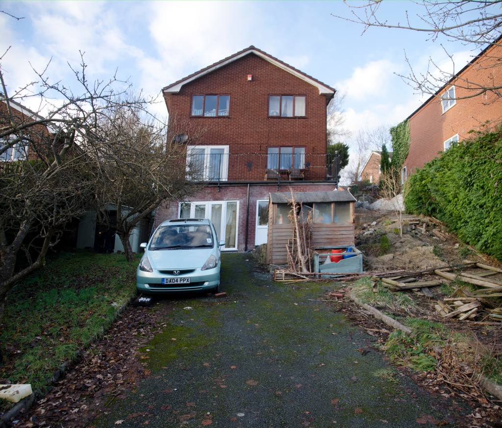

I live on a hill Lights to bottom of house overview.jpg the garage has the consumer unit and central heating boiler in it, with no internal access to main house, the garage has been turned into a flat, so the whole ceiling has been done with plaster board, so we have plaster board, insulation, the original ceiling and then a void and finally floor of main house, which had problems, so is now double thickness with plywood over the original sheets.
The RCD's for the freezers are in the main house, with SWA around outside the house to feed them, all other RCBO's are in the flat, but should one trip, it would not be urgent to reset it, we could survive without any single RCBO, except for central heating, we have an open fire, but to get wood to burn would also mean going outside, and the whole idea of having UPS on the boiler supply was to reduce the chance of the central heating failing even with a gird power failure.
So to fit a RCD seems on reflection counterproductive. I have had a handrail fitted since the picture, but that was because I fell, going down to flat, with a little ice on the steps, so danger of falling is real, danger from electric supply to boiler, seems very low in comparison. On reflection, I was really only fitting a RCD as a precaution against a very low risk.
