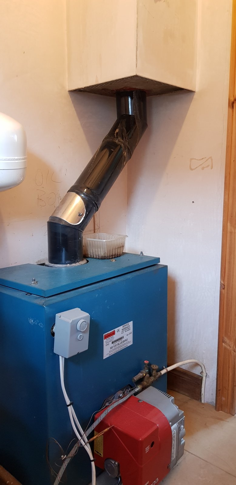

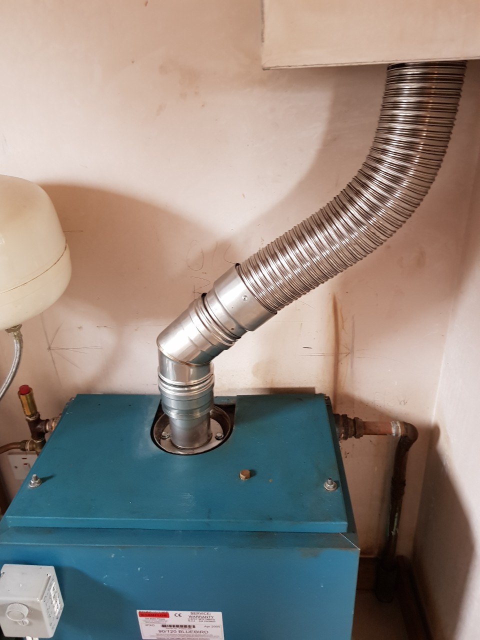

Attached old black/new silver fittings photos
A liner is meant to be enclosed within the flue.
The joint onto the SS does not appear to be sealed.

Thanks for the feedback...so the stainless steel liner should have been put inside the original black piping?
Is it dangerous if this isn't done??
Please turn off your appliance immediately.

I have a Co2 detector in the boiler room and there is nothing showing. The smell could be from the heat resistant silicone he used? or the liner itself??

Thank you Terrywookfit, I'm going to ask him to put back the black enamel pipe or a new one, and have the liner just coming down to the bottom of the chimney. Now I just have to hope he will do it and not get p'd off with me.....

So, he came back today. He said he couldn't smell anything, but it must be the rubber seals in the joints, took it apart removed them and put silicone in joints...saod that should fix it...... he wouldn't listen to me about putting the black enamel pipes on.
Smell is still there when oil burner kicks on.

He could SHOULD have used the stainless steel flue pipe into the chimney .
An access door for flue cleaning would have been useful ..j I c.
What terminal is fitted on top of the flue?
