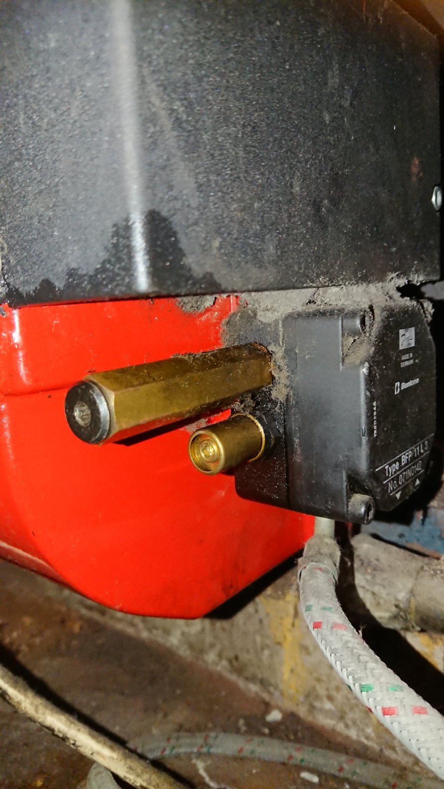

Can any one tell me what the smaller of the 2 allen keys screw are on this part of the oil burner?

It's for adjusting the pump pressure. Do not turn it unless you have an oil pressure gauge attached and know how to use it
