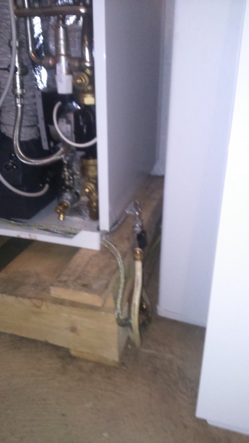

Hi guys,
Just had a message from the missus saying her friend has just had an oil boiler installed and she said that they have had to put it on a pallet otherwise she would have a hole in the wall!
Now am I right in saying that this is far from acceptable and what regs would this fall under?

It should have a remote acting fire valve to comply with building regs should ot be on a pallet it should be on a sound base contact OFTEC and building services.Bob

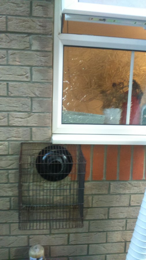

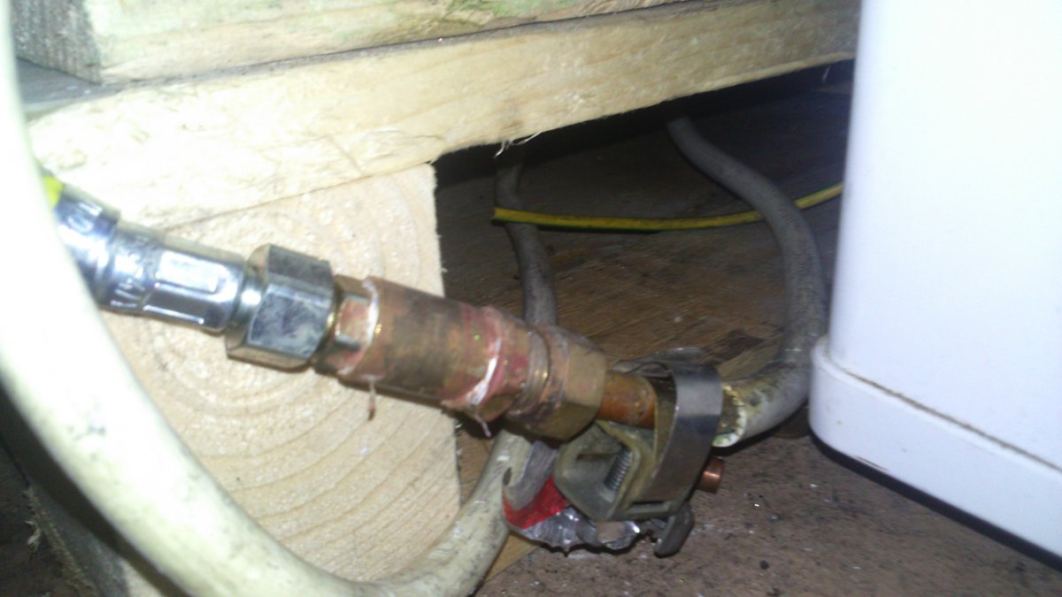

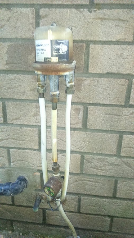

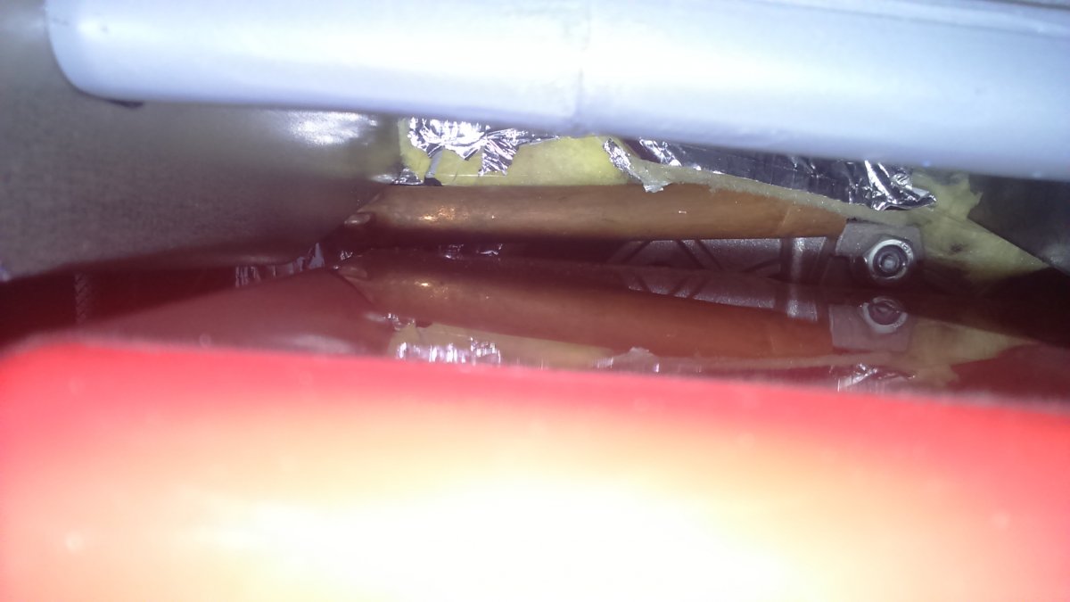

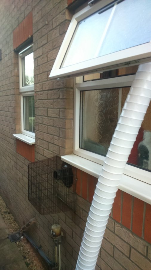

Having now visited to take a look it turns out it is perched on a wooden pallet and it definitely is the final install! oil pipework is shocking, fire valve phial has just been balanced on top of the burner and the flue is non compliant too. Its a Grant Vortex Pro Combi 21e
See pics...(excuse the crappy quality its a bad phone camera)

Well below par ?? IT'S A FOOKIN JOKE !!!
Fookin stood on a pallet !!!!...........They could at least have used Breeze blocks !:whistle:

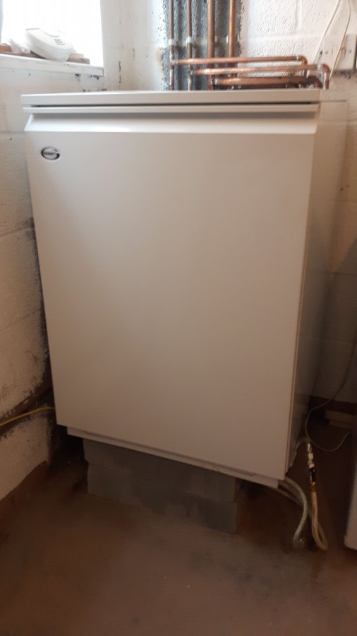

Funny you should say that! They have been back out today and fitted the programmer. Salus RF500, they then redid the base with thermalite blocks just in the middle of the boiler! Flue still not compliant and flexible hoses outside of boiler casing!
Install now classed as complete but no CD10 or CD11 filled in and no company details left although she knows the company's name now. Would reporting to Oftec get a visit asap to check compliance and have them return to rectify faults?
Pics of the new "now compliant" installation:

FFS !! And I was taking the Pi $$.
How long does it take to core a 127mm hole and patch the old one up.

Don't open that window when boiler running poc will flood your home did they supply a carbon monoxide detector like you ahould with an istallation god I could do better with 12pints in me Bob
If they did, it's probably on a couple of breeze blocks too... and in the back garden :eek:
