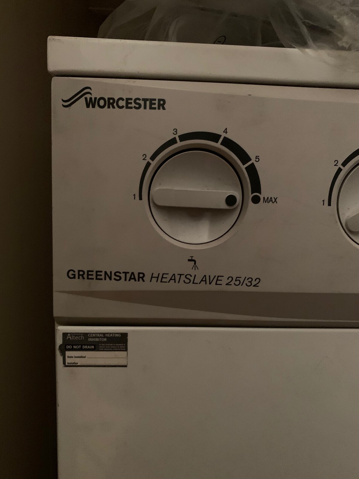

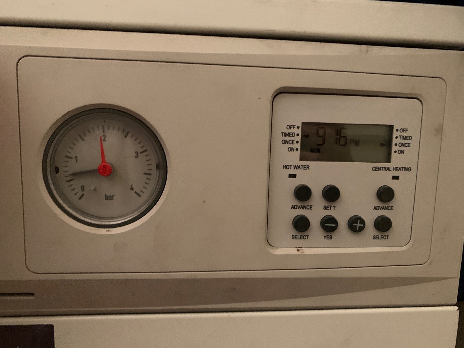

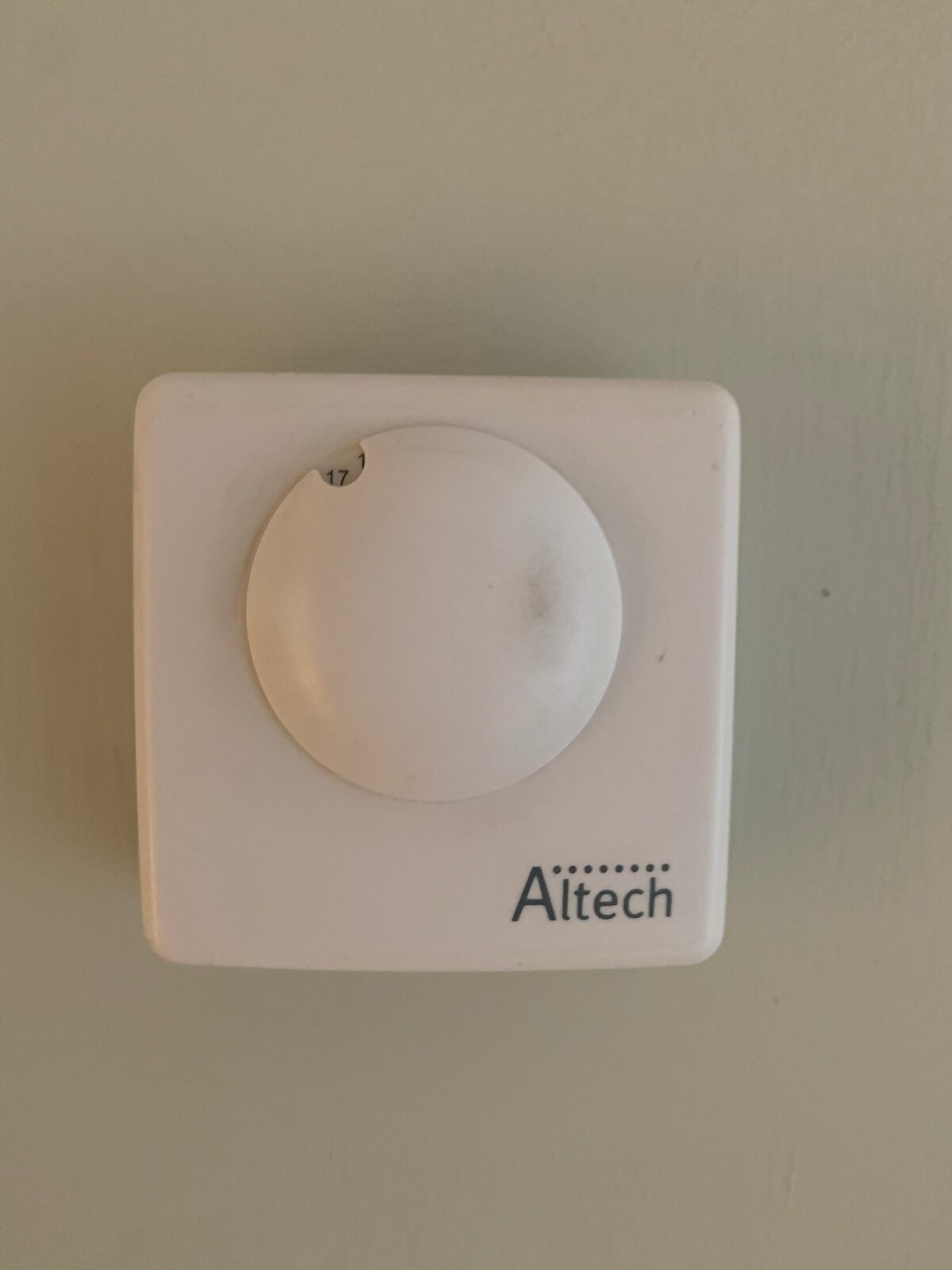

Hi There,
I’ve just moved home in to a house that has an oil boiler. Worcester Greenstar HeatSlave 25/32. The boiler was installed in 2009. I’m looking to install a smart thermostat to control the heating and hot water from phone. We had the Hive system in previous home and it was fantastic, however, although the website says this works with oil boilers, Hive/ British Gas don’t support it. I am struggling to find anyone that can install with an oil boiler. Any suggestions or indeed alternatives? I believe there are ones like Tado, again just looking for support with install. I've attached pics of boiler/ Thermostat

Not familiar with Hive but Nest could definitely be installed on this

That's all you need. The Nest replaces the existing Altech thermostat, the wires from the Altech get connected to the Heat Link's T1 & T2 terminals, and the other terminals wire in to the boiler's supply and demand connections

No, there's no reason why the existing programmer should remain connected. Your Nest can control both heating and hot water on your boiler
