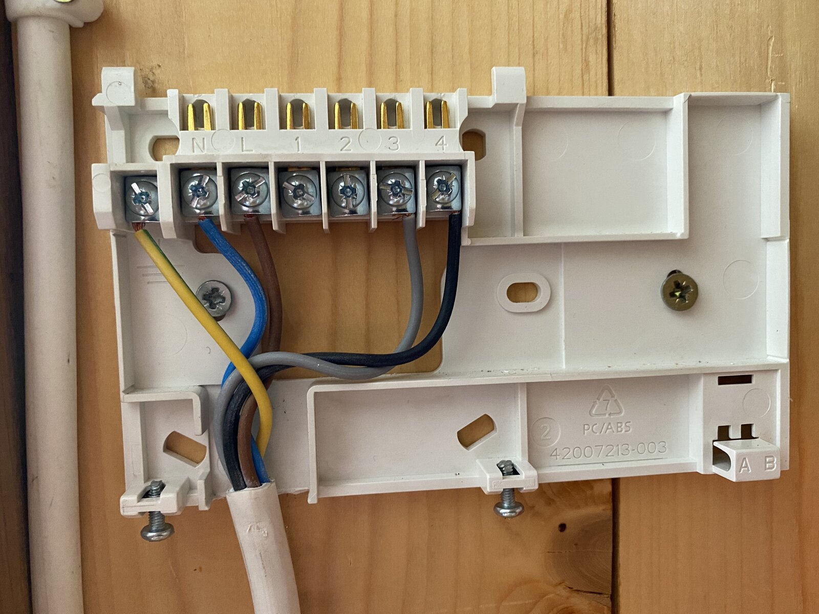

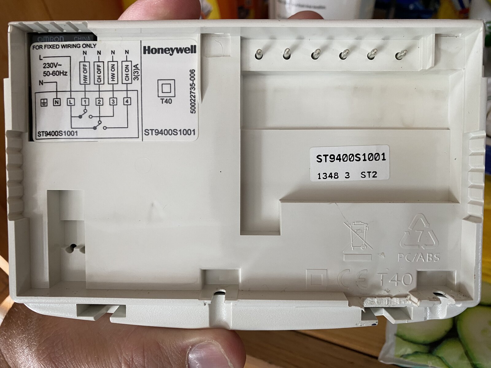

When you switch hot water to 'on' on the timer, does the blue light come on the boiler and it fire up?
isolate the power to the boiler and programmer, remove the programmer by loosening the two screws underneath and take a picture of the wiring and post it.
Here you go!
F6D5E51A-7E96-405B-84FE-139747F4A11D.jpeg 0F76AD1F-8C6E-45E9-ABCC-582EF4EA69E8.jpeg
just connect the wires exactly as they are to the hive dual channel same numbers same colours, oil combis are slightly different to gas combis in that the oile combi will have a small thermal store, hence why it can be timed
Thanks everyone. Dual controller installed fine.
