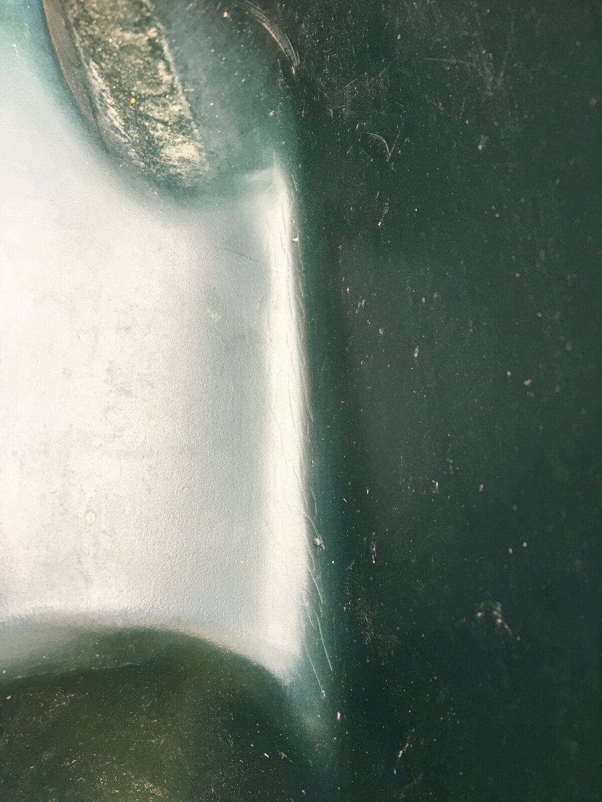

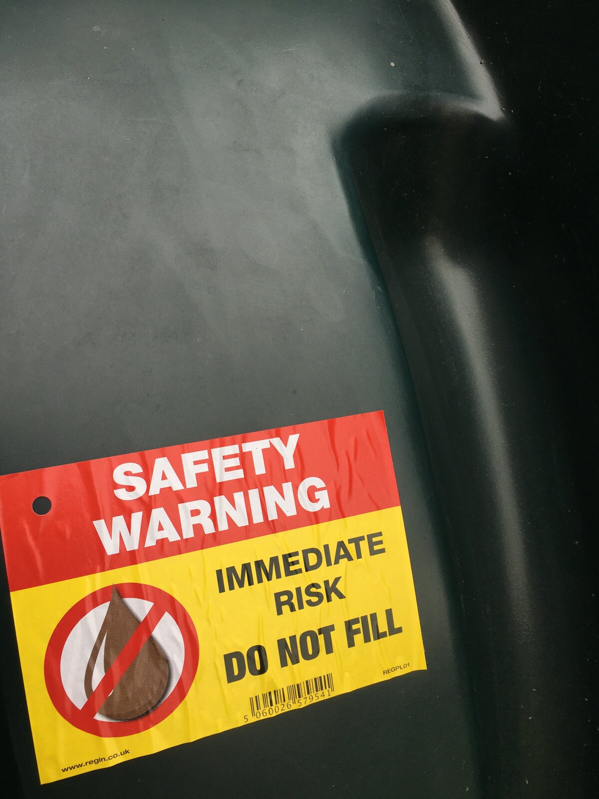

Had the oil tank serviced yesterday and the guy has put a sticker on the oil tank stating, 'Immediate Danger. Do Not Fill'
His explanation is that the tank is developing hair line cracks/splits so the tank needs to be replaced. He showed me the 'split' which looks like a small scratch.
Can any of our oil/gas engineers give an opinion? Marks are on the radius towards the right just above the label near the reflection of light.
Personally I don't think it's of any immediate danger and thankfully we had it filled, (now at the 3/4 level), 3 days ago.
House is rented and I know landlord will get it done but just don't want him being 'fleeced' for something that may not actually be necessary. I don't know how old the tank is but we have been here 6 years.
Contact the Landlord as soon as possible and inform him of the problem, looking at the state of the tank I would guess it is quite old and does not contain an inner tank , so if the Tank splits it becomes a major issue if the oil penetrates water level or underneath foundations . You have been informed of the state of the tank so Insurance Companies will not be interested in paying out compensation and the pollution would be a criminal offence .
