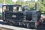

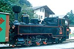

So central heating uses near enough engineering in the main, it just costs too much to have a system which will really control home temperature, there is no perfect system. It would cost too much, and although oil boilers last for years, mine is 18 years oil, and is likely to be 40 years old before it needs changing, gas don't seem to last as well, and at work the boiler was built 1902, and 1900, they really boil the water, and both have about 8 years to run on their ticket. 1666363550051.png1666363520455.png there are some new boilers around
this one at Corris built 2005, this one
not in steam yet as far as I know, also Corris built this year. But boilers should last for at least 100 years if looked after.
