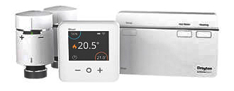

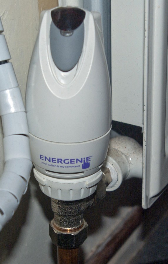

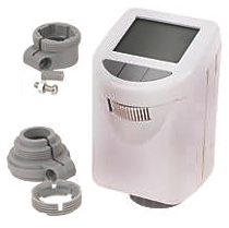

Control of most central heating is done with the TRV's they come in three basic flavours, mechanical, TRV.jpg local programmable, terrier-i30.jpgand linked programmable. Drayton1.jpgThe programmable heads can be direct only or use bluetooth EQ-3 Bluetooth Smart Radiator Thermostat.jpgthe latter is used when two radiators in the same room, but clearly they will not heat up the room unless the boiler is running, so the terrier i30 and the eqiva eQ-3 can be used to turn off rooms when not in use, but need some careful setting up, I turn the main thermostat down ½ a degree for an hour before the TRV is programmed to heat the room then back up at same time as TRV is set to open to ensure boiler runs.

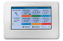

The Drayton Wiser or EvoHome EVO-home1.jpgdo not need you to carefully set the schedule as linked, so easier to set up, but cost more.
I made a mistake, I got Nest which I then found out does not link to TRV's, I was miss informed, I thought it would, but the two programmable heads I have, EQ-3 Bluetooth Smart Radiator Thermostat.jpgIMGP8035.jpg the cheaper actually works better, main good point is I can on the TRV head simply press a button or turn dial, the other one need to use my PC.
If I was starting again I would have two rooms with linked TRV heads and rest the eQ-3 which only cost me £15 each in 2019 for the bluetooth versions.
