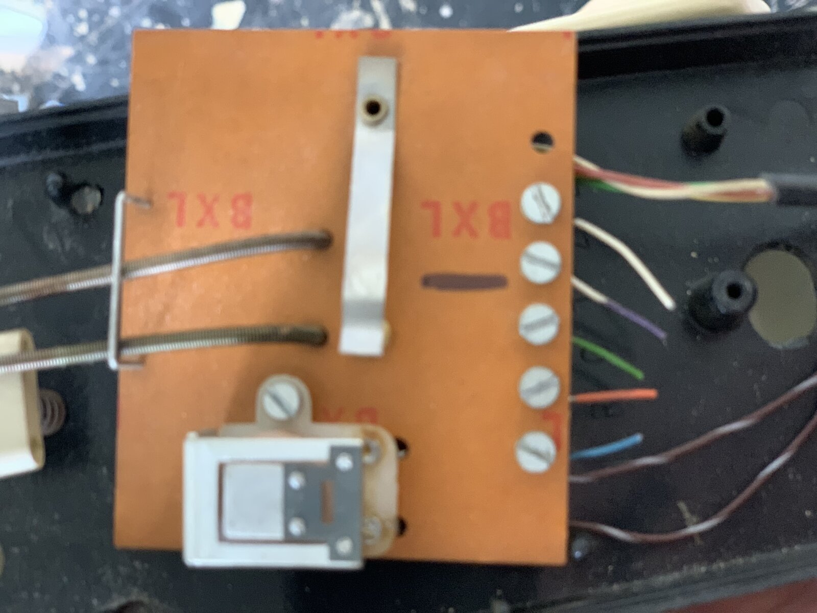

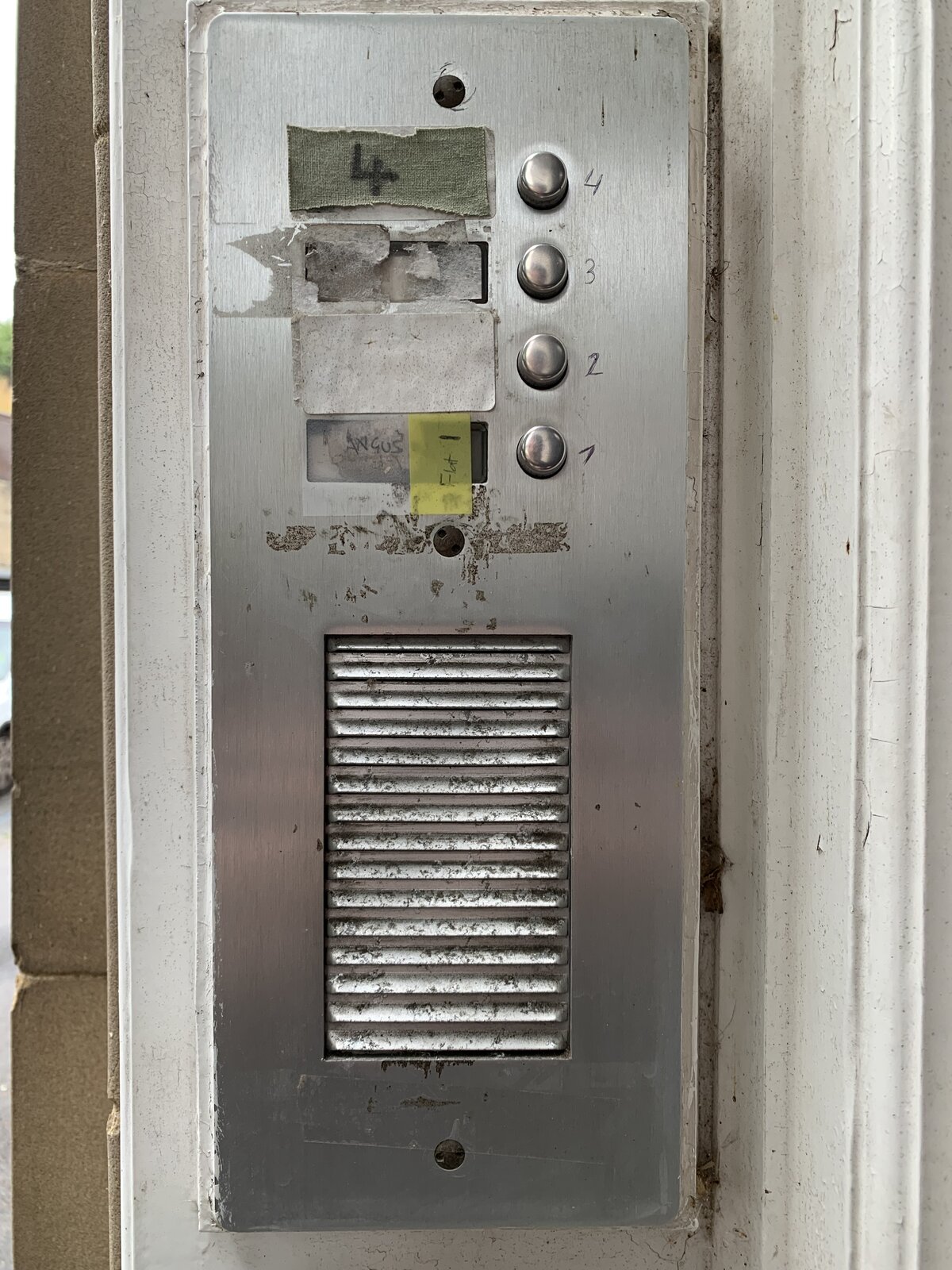

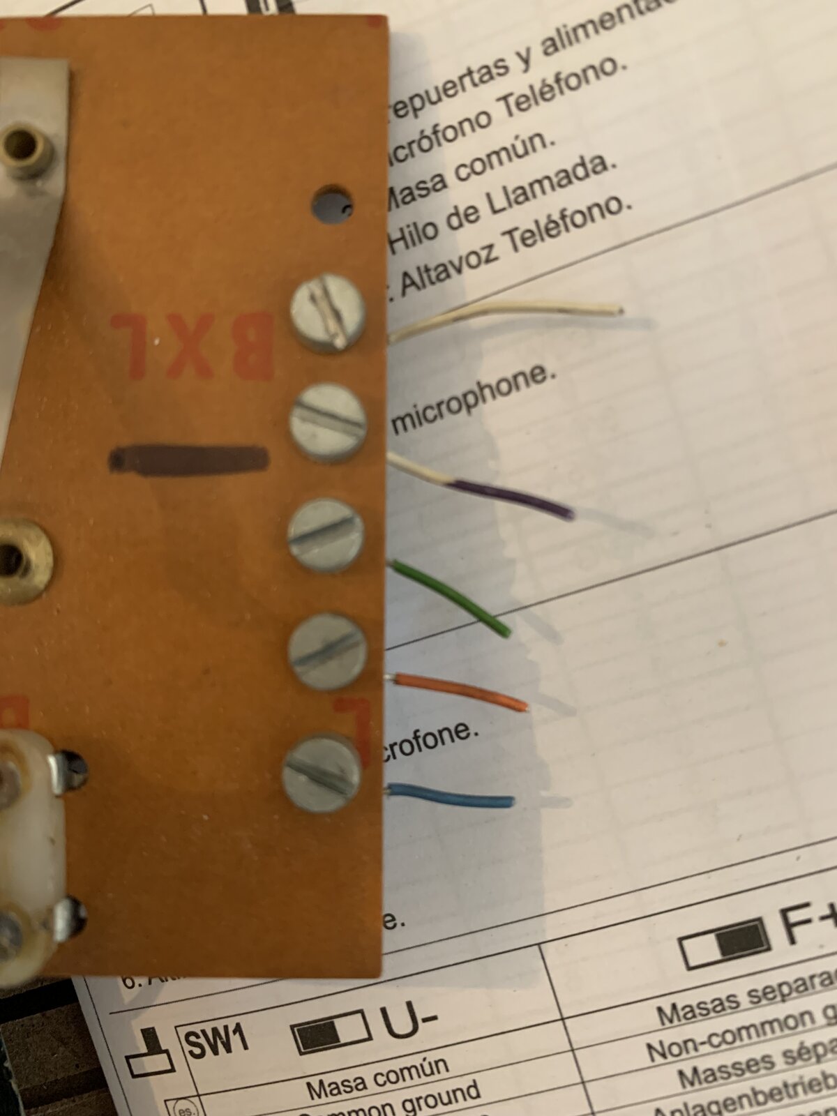

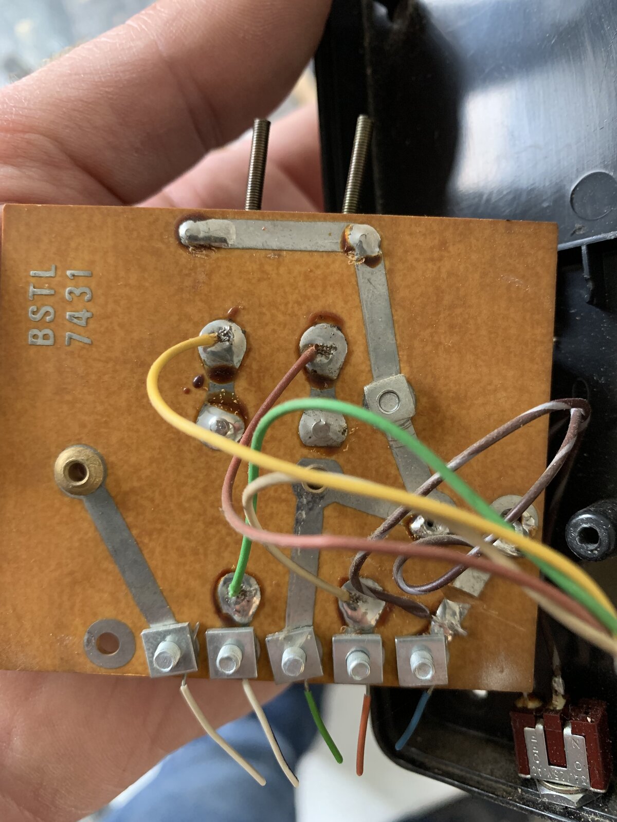

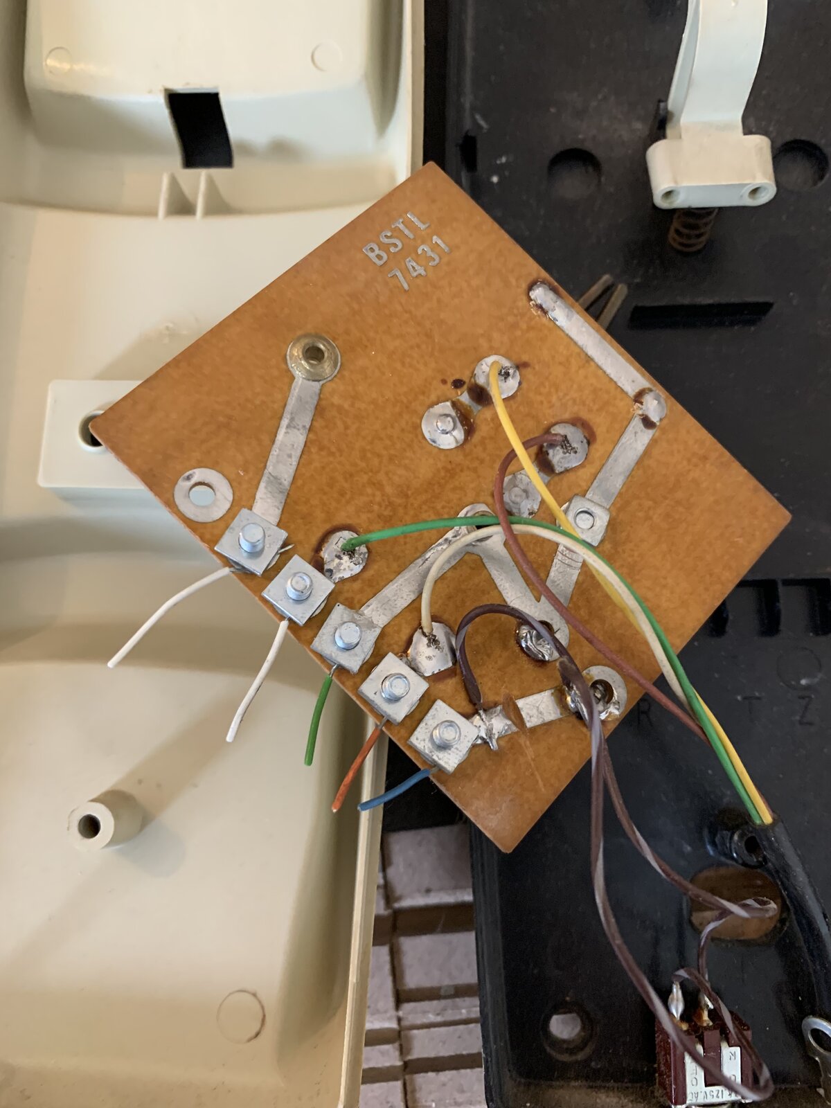

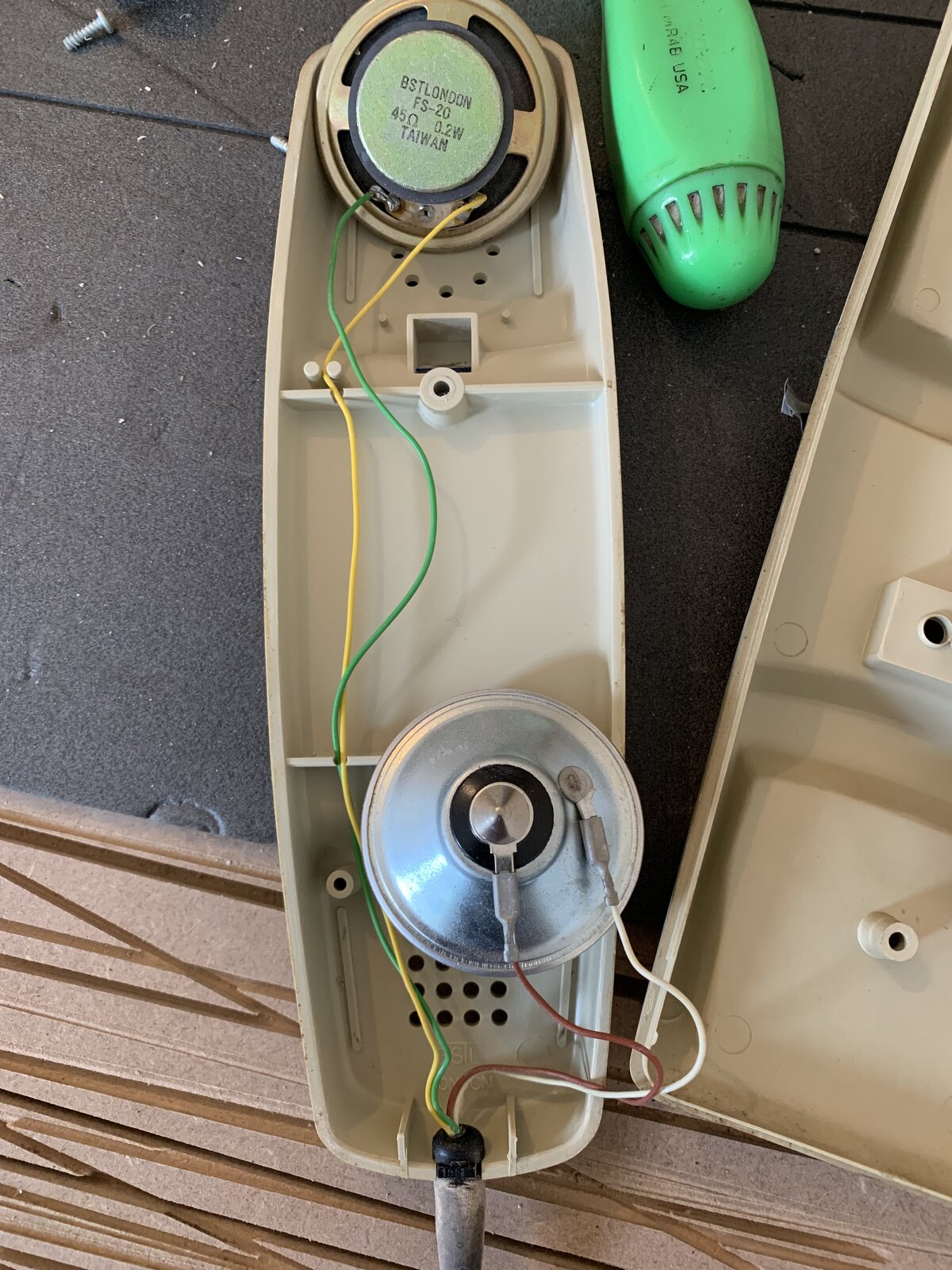

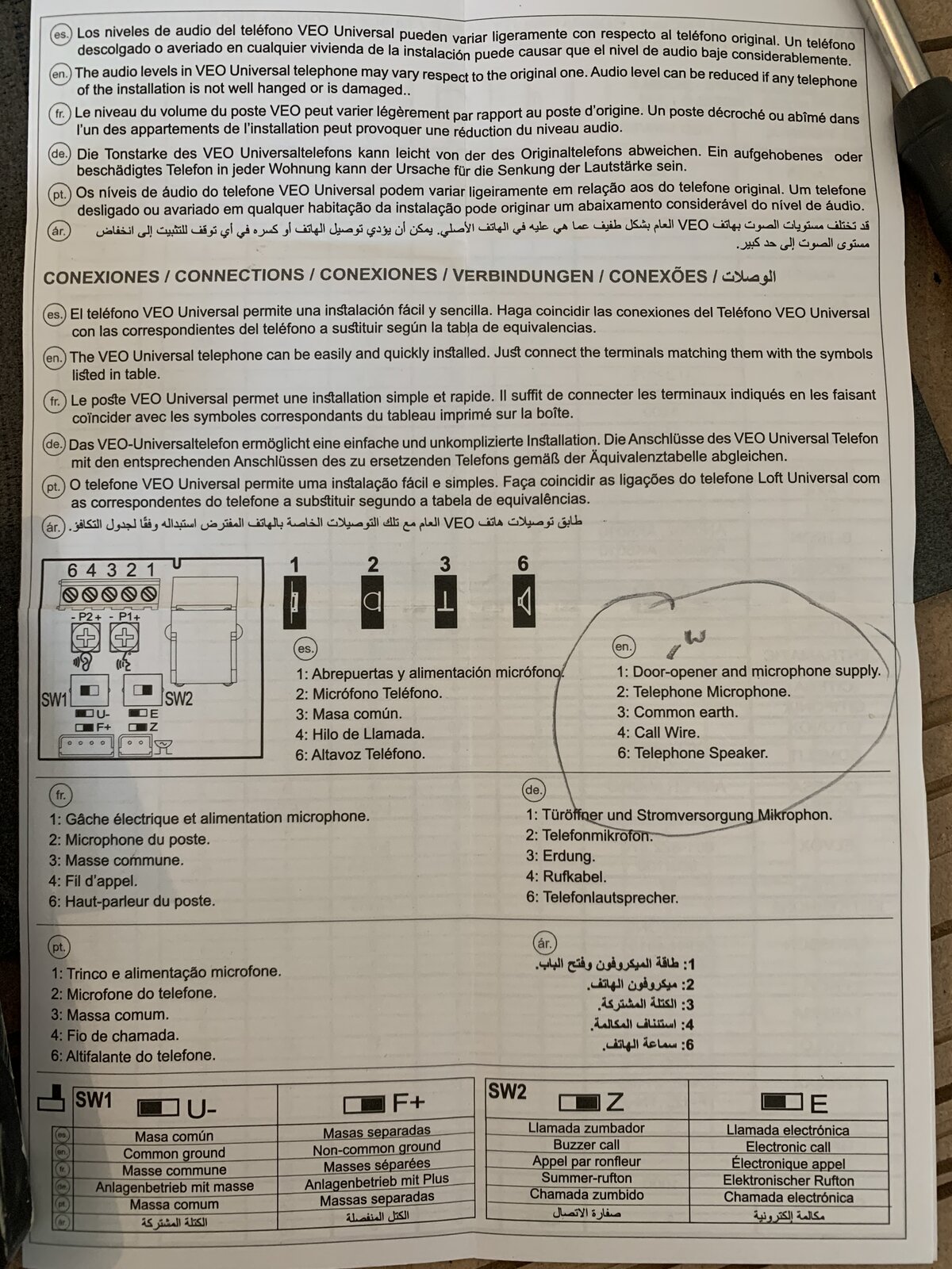

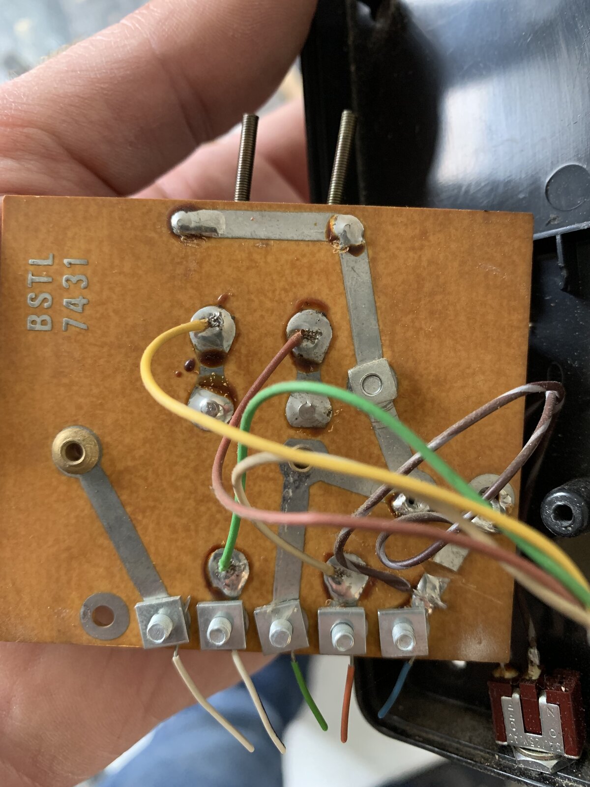

Hi All,
I wondered if someone can help. Ive renovated an old apartment and the last job is to get the door entry system working again.
The old handset was cut off and the intention is to replace with a Fermax VEO unit.
However, I have no idea how to translate the connections from the old wiring to the new handset.
There is no indication of manufacturer on any of the parts of the system so I cannot tell what it is.
I have some photos of below of the old system and of the new wiring connections in the manual.
Would be grateful if anyone knows what wires to put where (this is a UK system).
Thank you in advance!

So, since posting this and thanks to this forum I’ve found out it’s an old Bell system and ‘should’ be easily replaced by a Bell 801 handset.
I’ve ordered one so will see how that goes
