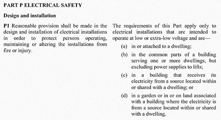

To be honest I dont want agreement or disagreement. I need to know what the law or regulations say
You haven't told us enough to form a reliable answer.
What is the supply power rating of your AC unit?
Do the instructions say it must be RCD protected?
Is there an existing 13A socket nearby?
Do the instructions say it can be plugged into a 13A socket?
The Law:
and in England:
The Regulations:
400-odd page book
