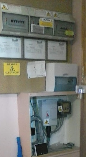

Old style Wylex fuse box and wiring

I’m merely pointing out that an EICR would code a plastic CU as a C3 which would give you a satisfactory EICR
So it’s acceptable
The vast majority of Wylex 3036 boxes fitted in domestic premises in the past would have been non metallic.
So it’s acceptable
I think it's a big shame, even a shambles, that the requirement for non combustable CU's in residential property escape routes appears to have become universally applied to all CU's on EICRs.
My local church hall had an inspection several years back and the 4 plastic CUs with RCD as a main switch
were graded as C1 and the only comments being combustable and single RCD, th same contractor charged ~£3K to replace them with a metal CU without any space for expansion filled with RCBOs (and B32 for SPD which is nearly always in the tripped state).

The private meter and metal switched 80A fuse are 10mm² tails feeding a 16mm² SWA to the smaller hall where a fully populated plastic CU with an extension unit and I believe RCD as main switch still exists and no codes on the EICR
