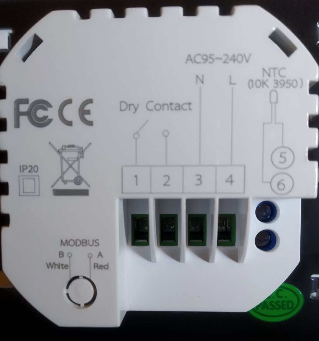

yep makes sense... so terminals 3 is live, and 5 is neutral which has 240 volts... so easy to power up the stat from here.
Boiler 3 (L) to New Stat 4
Boiler 5 (N) to New Stat 3
New Stat 4 (L) connect to New Stat 1
Boiler 4 (SL) to New Stat 2
This correct?

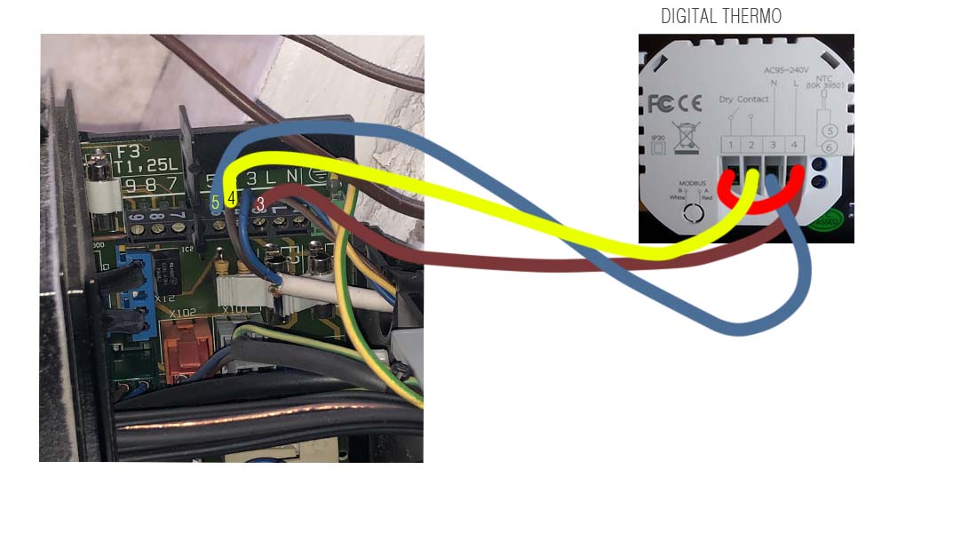

LIKE THIS?
Can someone confirm this, please? I want to take another go at this and rewire from scratch.
I’d piggyback the L and N at the boiler, then 3 to 1 and 4 to 2. Careful as you may need to carry out some safety checks after work on the boiler.

would the above work?

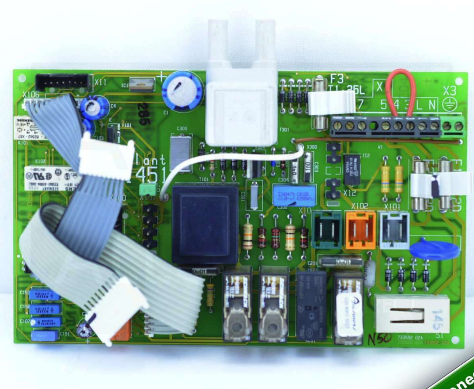

I looked for a pcb images for this boiler and as standard, 3 and 4 are connected...
So why did it blow.
Sorry, I don’t under stand .. just jumper from 3 and 4 ... I wanted to omit the thermostat, I just gave up and took it out.. so I connected 3 and 4...

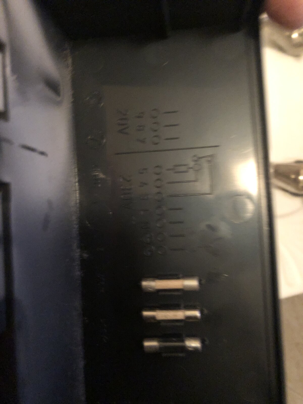

The black cover over pcb shows a small diagram. See attached

I did not do anything apart from remove the 3 and 4... made a small jumper wire from 3 to 4... even a new pcb on ebay has the same... see attached.
