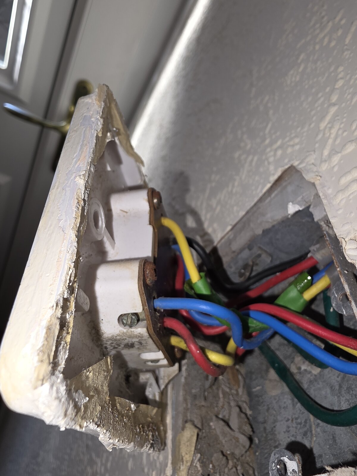

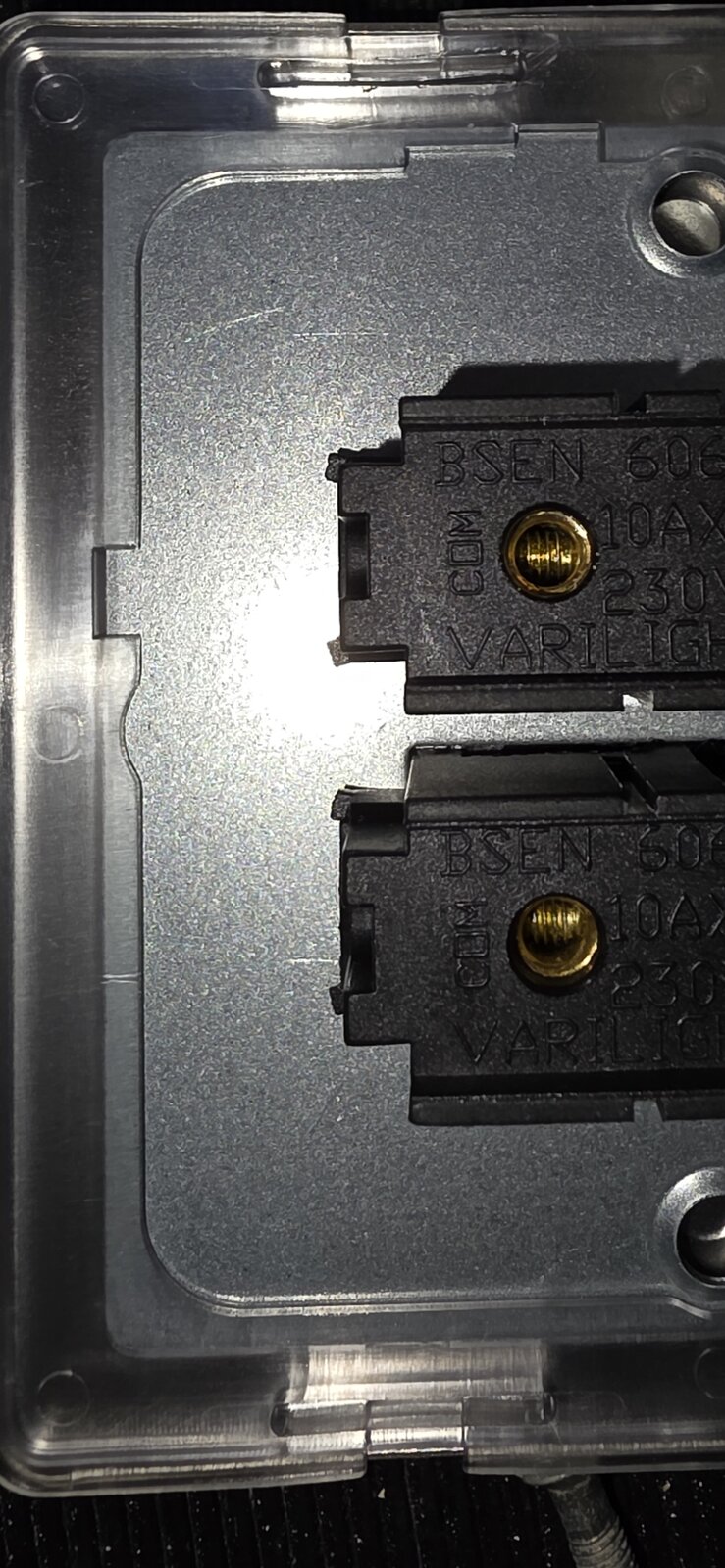

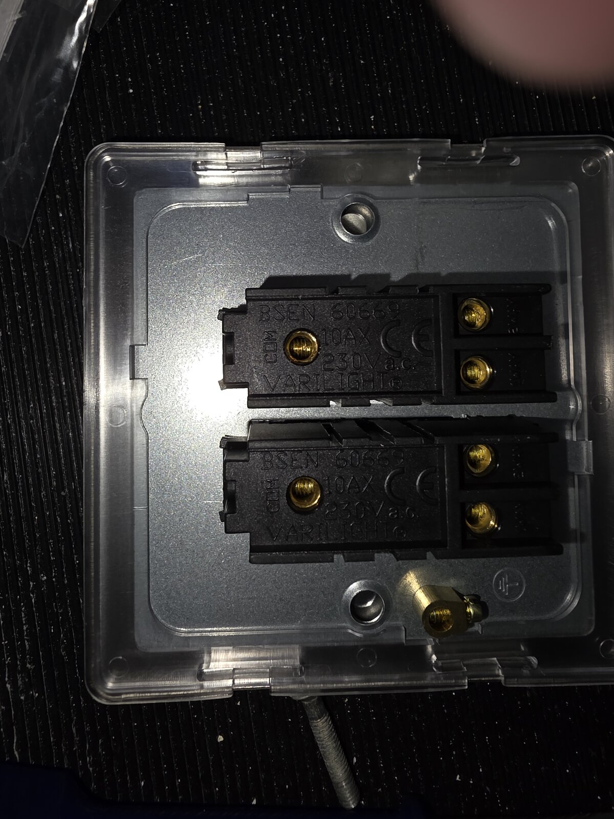

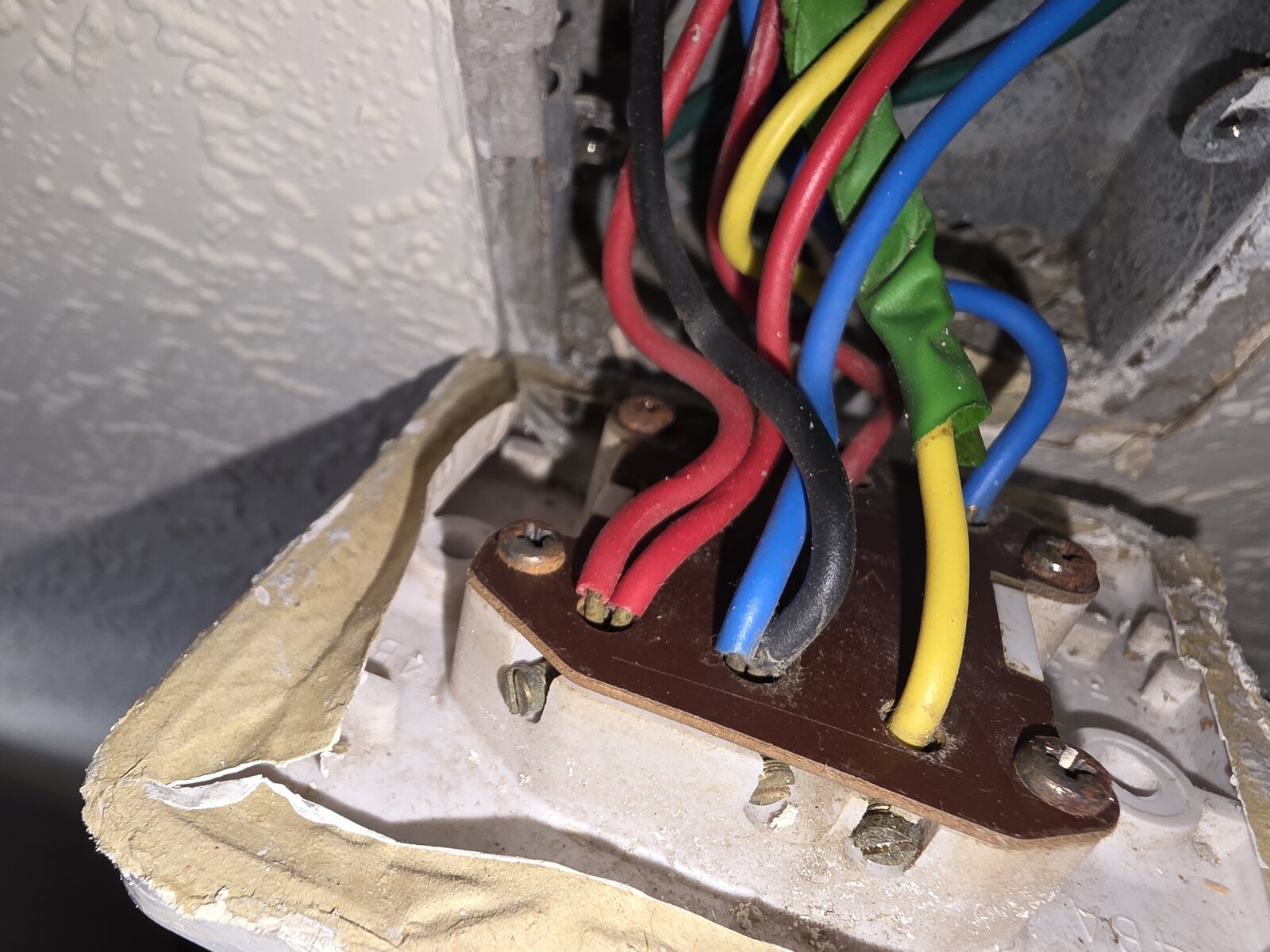

I need to charge this light switch but I'm not sure on which wires are which.
Can anyone help
The last photo is back of the new switch the wires need to go into.

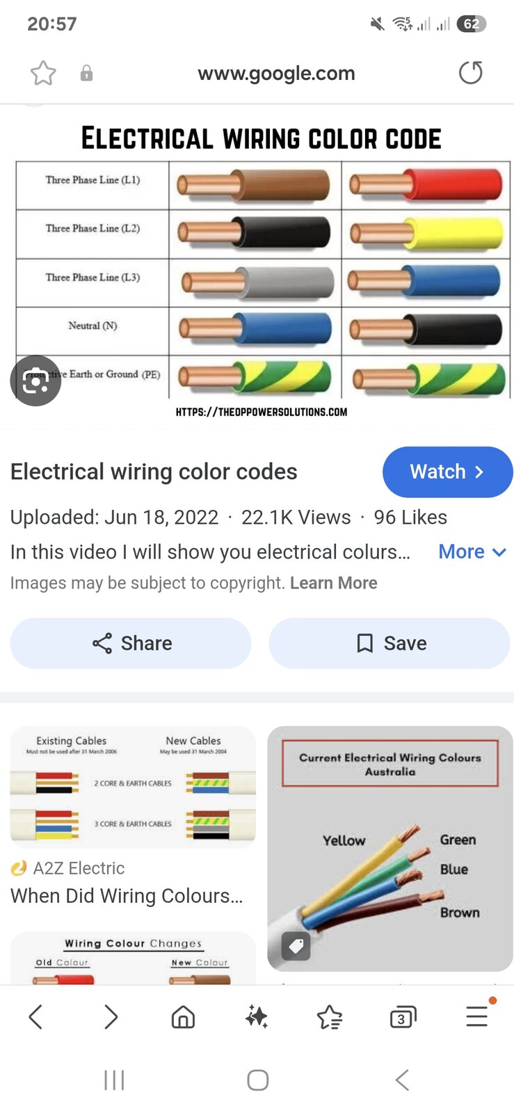

Is this accurate

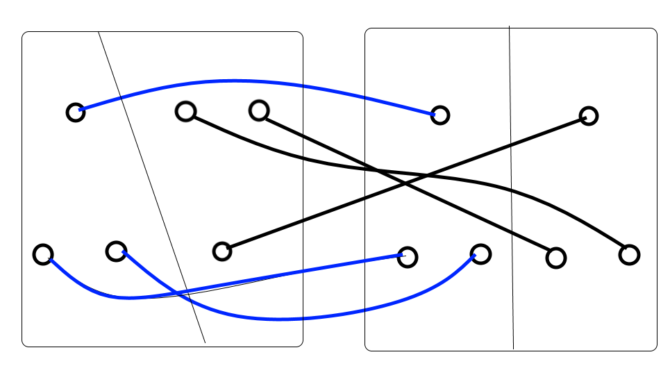

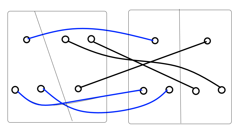

Just note that both switches are two triangles but on the old switch one of the triangles is upside down.
So - allow for this and just transfer the wires from old to new.
Do not mix up the wires of the same colour; mark them all first before disconnecting.
These are what you have but that doesn't really matter; just transfer the wires to the corresponding terminals.
So does the single blue and and red go into the 2 com slots
Right think I've got it. think it's clicked now. Very easy

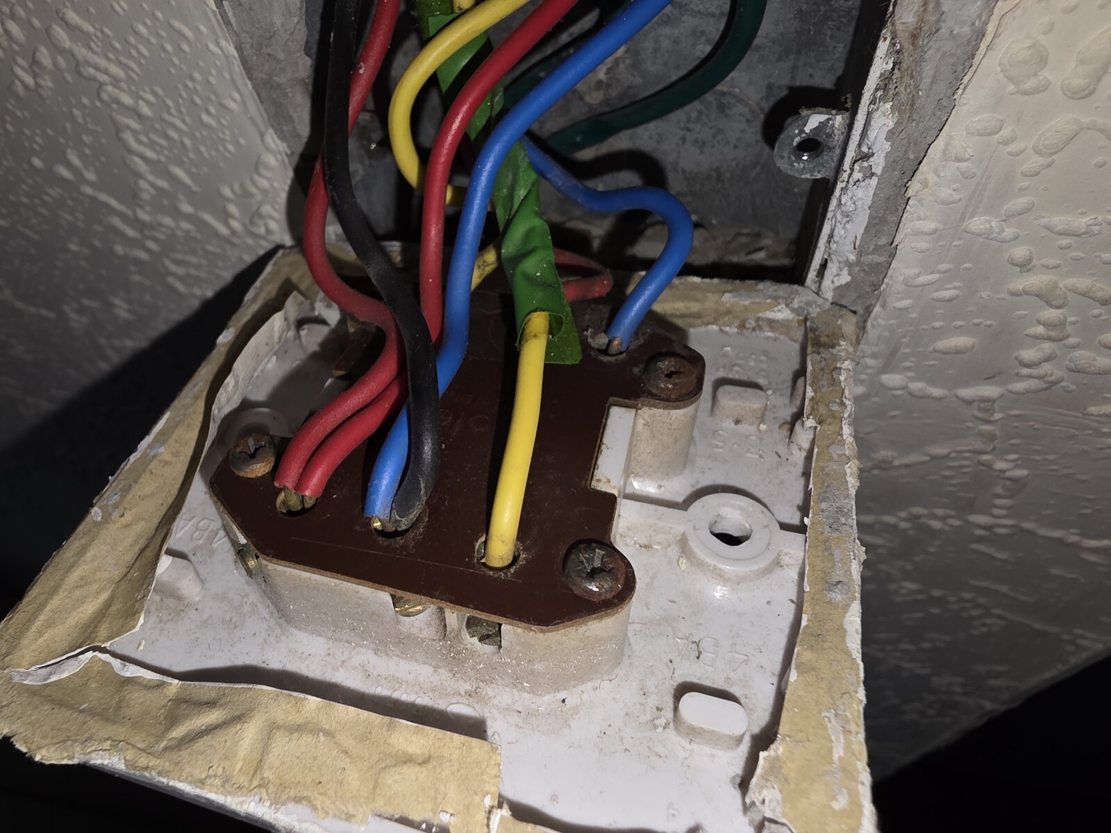

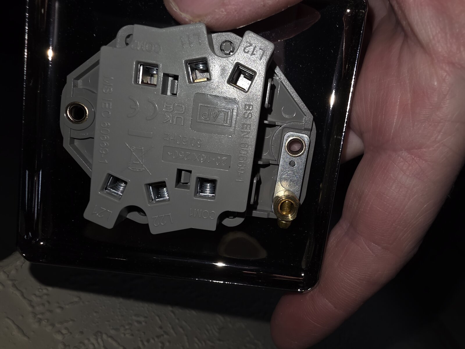

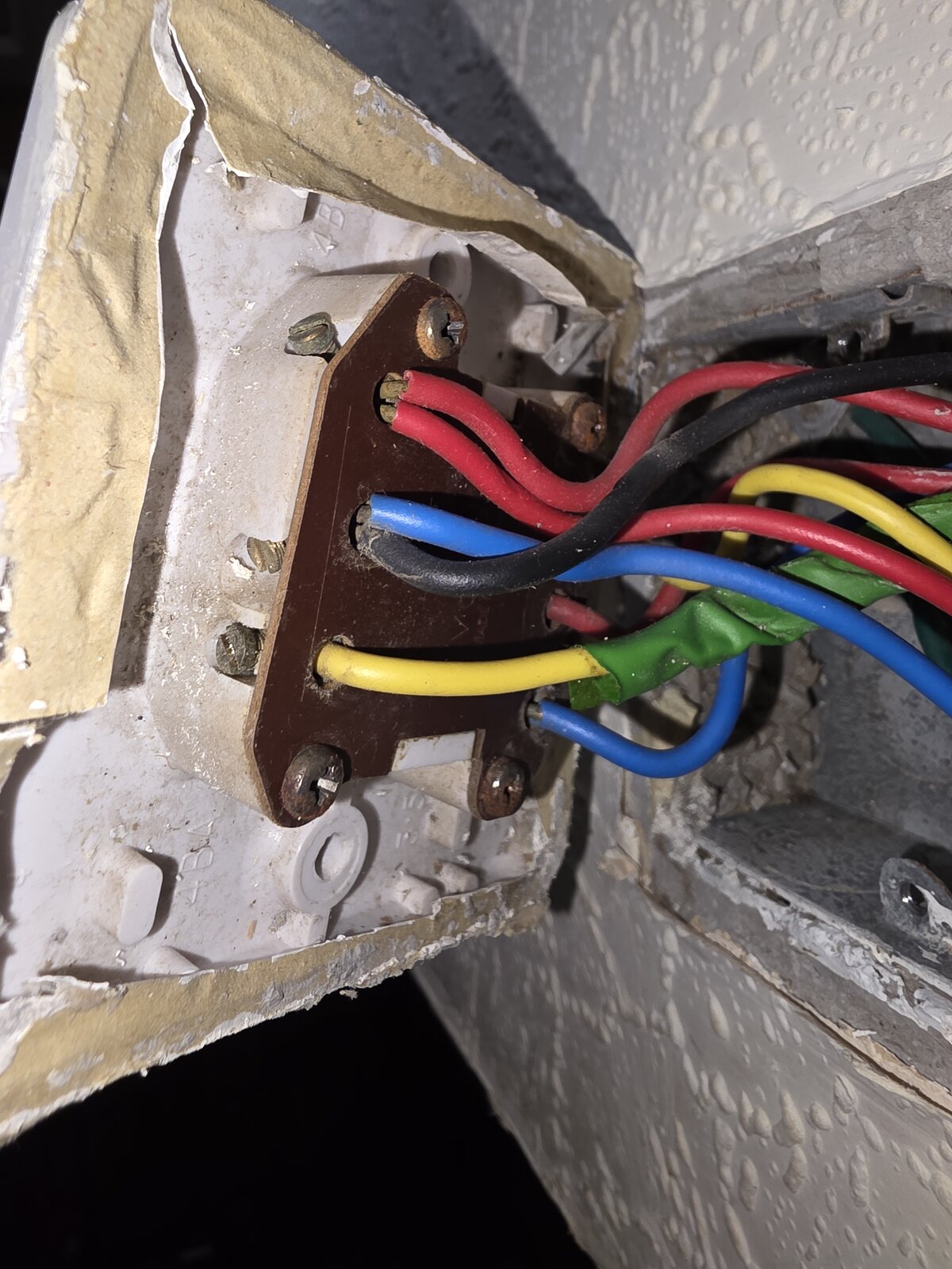

Sorry about this. The blood wife has changed the switchs to chrome.
So they are different no can anyone help me again with this
Thanks i did think that, but best not to guess stuff like this.
