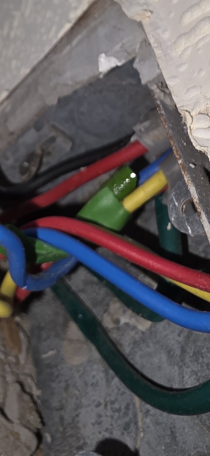

Older wires to change light switches
I can't remember seeing a earth wire on the back box. I'll check when I get home.
Can I ask. What are the 1 black and blue wire that are together on the old switch?
The black is the switched live and the blue is one of the wires with the yellow and red from the same cable that go to the other switch of the two-way system.
They will of course still be together on the new switch.
If there is no adequate earth, then it would be dangerous to replace a plastic faced switch, with a metal faced one.
Just looked at the photo again while at work. Is that thick green at the back the earth wire?

The dark green, at the very back - possibly, the dark green was the predecessor to green/yellow. It might go to a terminal on the back box.
Yeah I'm on about that one. I'll check when I get home later.
Thanks everyone. Learning loads here.
Yeah they is a green wire going to the earth point on the back box.
