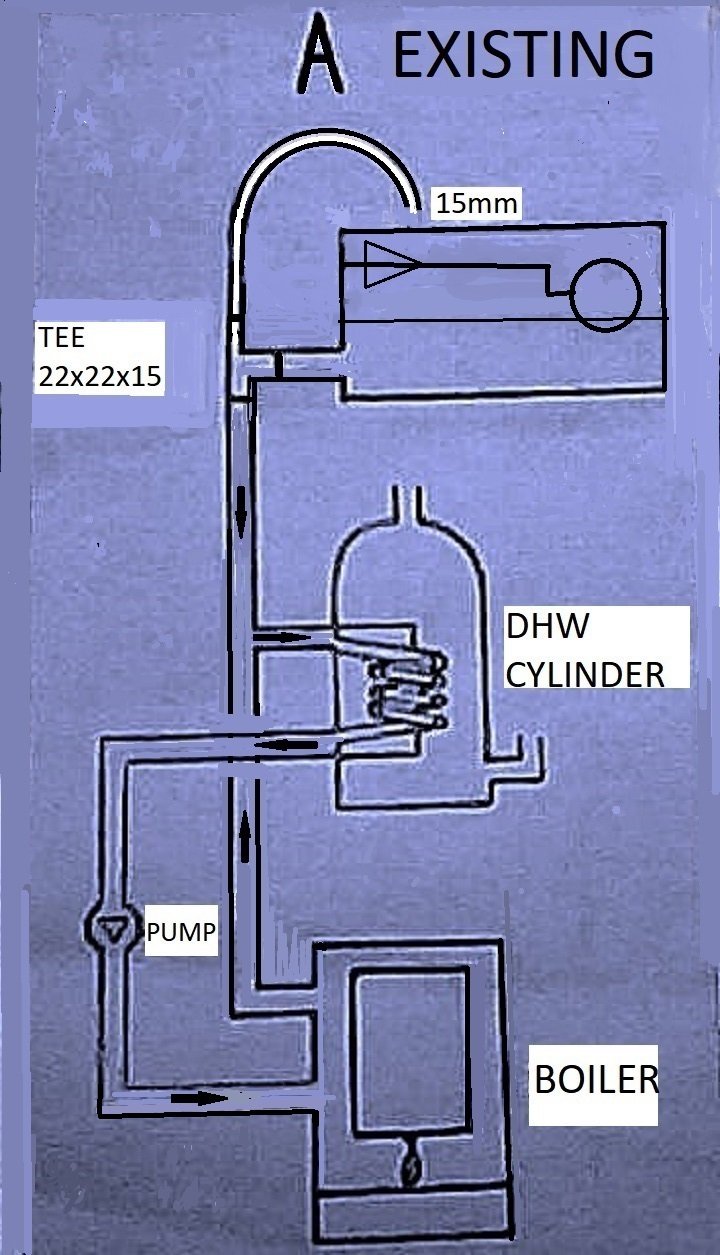

I am preparing to fit a replacement central heating water pump. Please see Diagram A, which shows the main components of the existing central heating and indirect hot water installation.
The existing installation uses a conventional gas boiler (Glo-worm SpaceSaver), a hot water cylinder with a heat exchanger, a single pump and two cisterns (one of which is shown on the diagram A.) So far as I know, the boiler does not have over-heat protection.
All pipes are 22mm throughout except for an open discharge over the cistern. This is a 15mm branch from the 22mm F/E pipe. This feature bothers me, given what I have read here that boiler safety relies on a dedicated open vent from behind the pump.
I would like to ask if the assembly shown on diagram A is a recognised working. By the way, any other advice about fitting a new pump will also be gratefully received.

As long as there is a clear, open, constantly rising path from the boiler to the Vent, that satisfies the safety aspect. Ideally the vent needs to be in 22mm pipework, given you seem to have a 22mm pipe up to the point where it tees to go into the Feed and Expansion Cistern it may be worth upgrading the last section if not too ridiculously difficult a task.
I would assume it has worked up to this point in time without too much issue, ensure Pump is correct orientation when fitting new and dont rely on the Pump Valves to shut off, you will probably be better to drain the system before attempting to remove the old pump. Refill and add inhibitor as required when finished and satisfied no leaks.
+1 - the standard for a combined feed and vent would be 22mm all the way.
Also, they aren't really a standard as they can be a bugger to fill and can be prone to airlocks if not done slowly, although, as suggested though if it's worked ok up till now. Combined feed and vents were usually used when there were problems with the standard feed and vent either pumping over, drawing in air or the F&E cistern vent/height was an issue

If it's worked OK in the past and it's just a case of changing the pump, should be no problem.
But I'm curious about the arrangement, where are the rads?
If it's pumping downwards as on the sketch, that's non-preferred. I'm not keen on combined feed and vent either.
Thank you for your interest, fixitflav. I have screwed down the floorboards temporarily to make safe. Until I lift them again, I remain unsure how the radiators hot and cold leave and rejoin the system but I think they're normal. I'll include then on diagram B. I have not shown the horizontal runs on the sketch, but. for example, the hot cylinder is next to the north wall and the gas boiler next to the south. They are connected by a run to the pump in the first floor void that then descends to the ground floor boiler. Me too. It's the combined feed and vent that most concerns, but what I'm reading here is that it's not fatal. Thanks again!
Before replacing the pump carefully note the mode and setting of your old pump and match the new one to these settings, as some open vented systems can behave very poorly with air ingress/pump over on the seemingly simple pump change out.
I have exactly the same type of combined feed&vent like yours for over 50 years, it can only be used with a boiler with a hi limit stat and never with solid fuel, I have a service valve on the cold feed to the F&E cistern ballcock which I allways leave closed, on the very rare occasions that I've drained the system I just crack open this valve and fill the system very very slowly, no problem when I'm not making a living out of it, I might have to do a small bit of extra rad venting after the system heats up but no problems really.

Yes, I would say start with it at minimum speed and only increase it if necessary, which is unlikely on most systems. With modern pumps higher performance there is a risk of stirring up debris in the rads and moving it into the pump or boiler, more so at higher speed.

As my boiler doesn’t have a hi limit stat, installing a separate open vent while I am making other changes is looking good. Thank you!

Pumped over warm??, are you saying that hot water is being pumped up and over the vent?, if so, blockage somewhere because its impossible (U tube) for that to happen in a combined feed & vent system.
