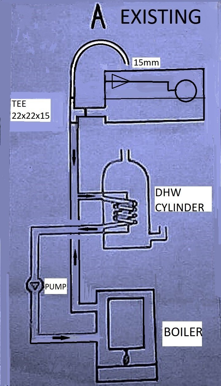

I am preparing to fit a replacement central heating water pump. Please see Diagram A, which shows the main components of the existing central heating and indirect hot water installation.
The existing installation uses a conventional gas boiler (Glo-worm SpaceSaver), a hot water cylinder with a heat exchanger, a single pump and two cisterns (one of which is shown on the diagram A.) So far as I know, the boiler does not have over-heat protection.
All pipes are 22mm throughout except for an open discharge over the cistern. This is a 15mm branch from the 22mm F/E pipe. This feature bothers me, given what I have read here that boiler safety relies on a dedicated open vent from behind the pump.
I would like to ask if the assembly shown on diagram A is a recognised working. By the way, any other advice about fitting a new pump will also be gratefully received.

Like for like replacement is the best bet IMO if an equivalent model is available which is generally the case. The gap tends to be a standard 130mm though. Buy a spare pair of pump I s o valves as the old gate valves tend to seize up. Pegler do a good quality full bore ball valves, albeit twice the price. Plenty of YT videos on installation of pumps, and safe isolation of the power and water
