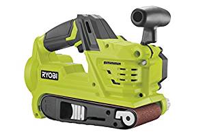

In that case we are back to Ryobi. Everything from a cordless trimmer, to a cordless nailer (in fact a whole slew of them in different gauges) to a cordless belt sander........

i have the ryobi belt sander and it as good as the old bxd mains
the only thing i found was the lever mechanism could hang up and stop the full tension so the belt could slip but ptfe dry spray into the lever slot problem sorted
it does off course cain the batteries so perhaps 12ah requires for fairly continuous use
