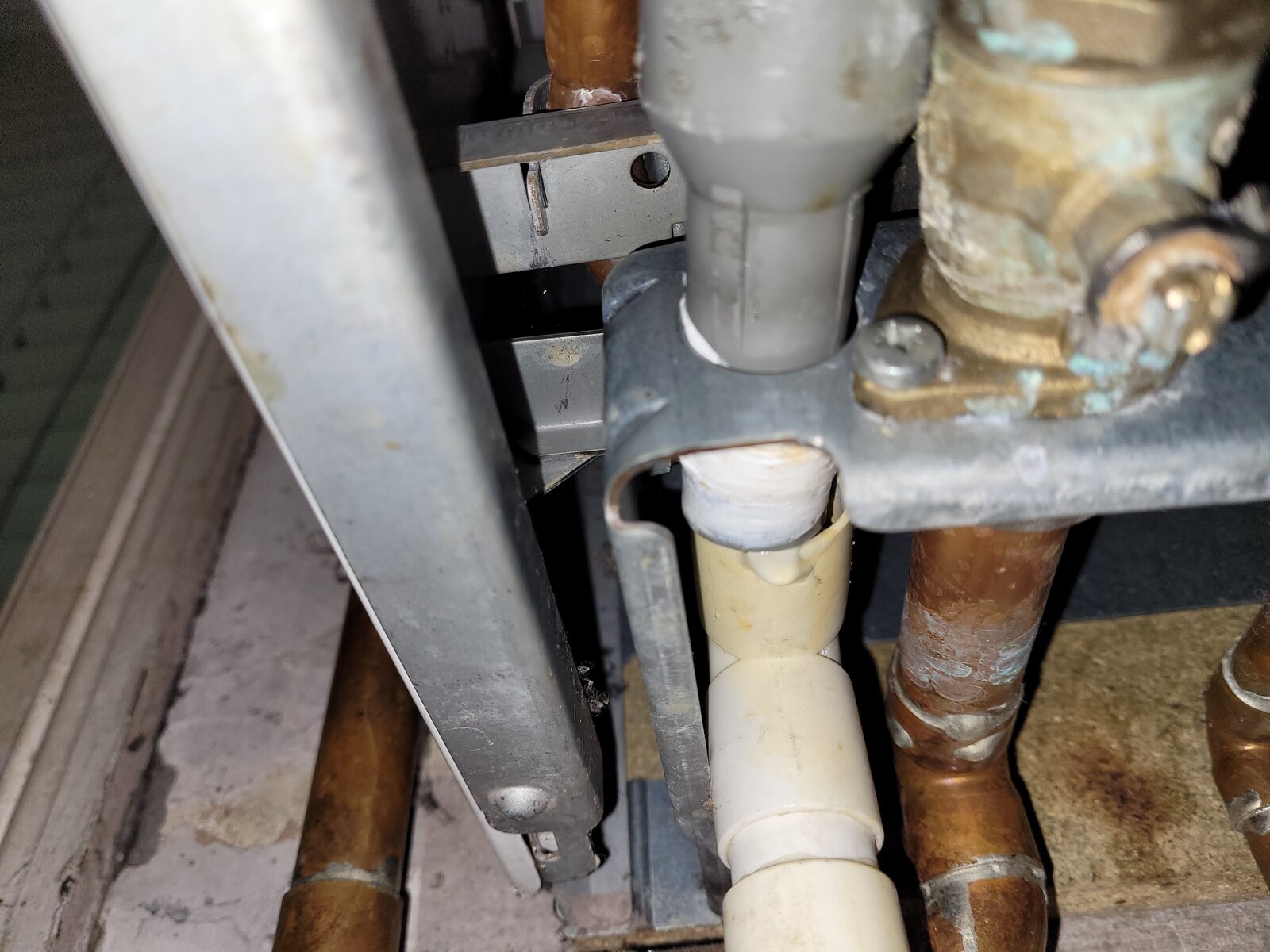

I have just had my British Gas branded Worcester combi boiler repaired by a British Gas engineer after it was slowly leaking mains water from what turned out to be a split manifold.
All was good for 2 days, now today the work surface underneath it and the floor under the washing machine below are wet through again, because it's dripping in a slightly different spot.
The dripping comes from just in front of the condensate pipe (no part of this will be frozen as it does not run outside but joins the washing machine waste). Interestingly though it isn't dripping all the time, but profusely when the central heating is running, and for a while after a hot tap has been used. Am I right in thinking this will be a leak from the CH system, or condensate trap? The CH pressure hasn't dropped yet.
BG can't come back until Monday :mad: even though I've claimed we have no heating (due to not daring to put it back on!). Just thought I'd ask if anyone had an idea.
Thanks!

OP it will be a condensate leak if its doing it mostly on CH.

Sounds like condensate leaking .
Can you show us a pic of where it drips from ?
Thanks for that suggestion, as it inspired me to get my head under there and have a proper look! You can see where the joint between the flexible pipe from the condensate trap and the plastic waste pipe has been dislodged! I have shoved them back together and fingers crossed, the dripping has ceased.
There is a messy clump of PTFE tape there, would you suggest I keep the BG engineer appointment and ask for the joint to be remade properly?
