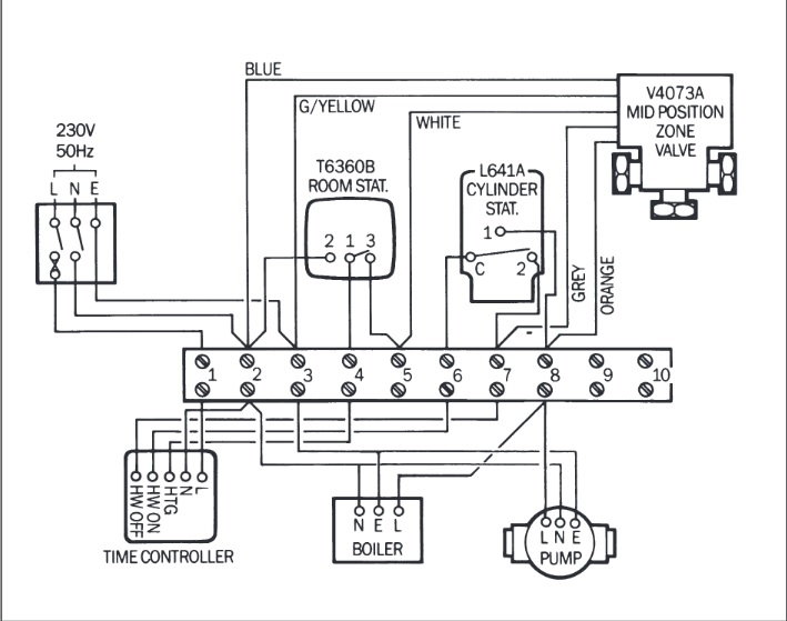

You must have 3 control wires from the cylinder thermostat (and maybe an earth if required).
The cylinder stat should normally be positioned a 1/4 of the way up from the base of the cylinder and in good contact with the surface and set to 60 degrees.
Start by checking all the wiring is correct and if necessary using a multimeter to confirm correct cabling...a surprising number of Y plans never work properly due to incorrect wiring.
For starters look at the Drayton MA1 manual but you will need to check your own cylinder, room thermostat and programmer for the appropriate terminals.

If the system worked fine a year ago ,the wiring then would have been ok ,so you only need to check any wiring that you have worked on.

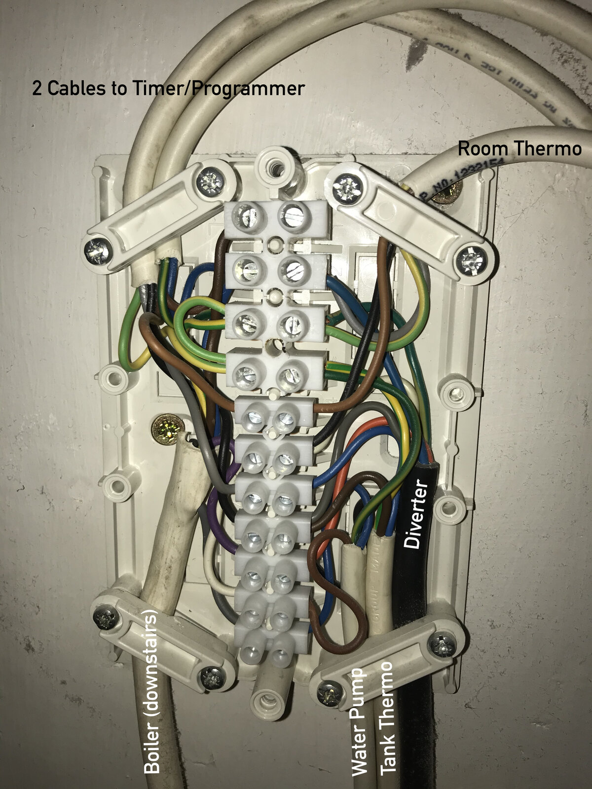

Can you post pics of the wiring centre ?
I can post pics, but haven't worked on any wiring. It's a matter of working last winter, staying on all summer except the room thermostat was turned down, and then turning it back up when it started to get cooler here but found the valve wasn't actuating. I'll look into posting a wiring pic tomorrow.

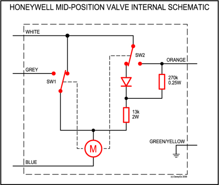

I will guess, and can only guess, that a micro switch has stuck inside the three position valve head. But you say you have changed the head.
So the boiler is powered direct from the tank thermostat and the valve should not move at all for DHW only.
With central heating only the valve moves all the way, and the boiler is powered from orange wire out of valve head.
For both DHW and CH the boiler is powered from the tank thermostat and the valve travels half way.
I changed out the synchron motor in the head, the PCB etc are unchanged.. I wondered if there was something in the remains of the unit that might not be working right.
Found it, grey wire comes from the tank thermostat and white from room thermostat, if the grey is not energised when the storage tank is hot then that would explain why CH does not work.
Reading again I think the tank thermostat may be the cause, some where I have a plan of how the valve works I will return when I find it.

I would find where the tank thermostat connects to wiring centre, disconnect it and link C to 2 and try, however if you look at plan grey, 2, and DHW off are all connected together, so if wired correct and tank thermostat faulty, turning off DHW at the programmer should mean you get CH even if tank thermostat faulty.
I have only worked on Y plan once, I tried using a meter, but did not have the plan of inside the activator, and the diodes and resistors resulted in unexpected readings.
As promised, here is a main view that I labeled to assist.. It doesn't appear that the installer used a layout that matches the diagrams above, and I don't have a dedicated mains feed; it must be coming up from the boiler or something but there's no cable from the mains panel to this closet.
The only thing that seems to conform is the wire colours from the diverter valve, and that may be able to deduce if the connections are correct but I doubt all the information is there, and I would understand how difficult it is to check through a picture. I'm going to tinker a bit today.
