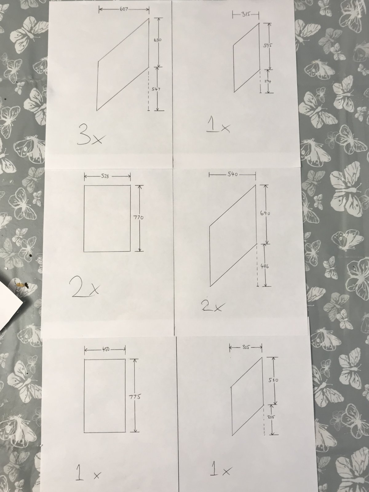

I got a price off the internet for 1 panel at £52 from StairBox so went to a local place and they quoted £75 for the same.
Is there a decent (cheap) lesser known online supplier?
Should I be looking at 8 or 10mm glass?
factor in postage etc as it will need to be sturdily packed.
I'd go for 10mm probably as it would look more expensive?
your local supplier might be willing to come down a bit?
I assume this is laminated/tempered whatever and is safe on a stair
Yes, i’ve just been looking online and it seems 10mm is cheaper so must be the standard. It toughened but not laminated.
First full price I have is £693 which includes a £100 delivery charge. That’s from made2measure.co.uk .
For components we often use Bohle in Dukinfield. Not sure how pricey they are, though. Glass comes from Padiham Glass or Halifax Glass for us
I’m somewhere between Padiham and Halifax so will try them both, thanks. Do you think there’s enough on this to quote off:
Padiham Glass just quoted £543 (y)
