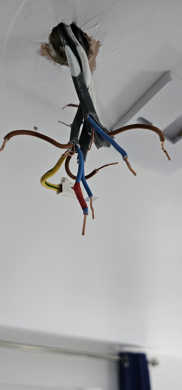

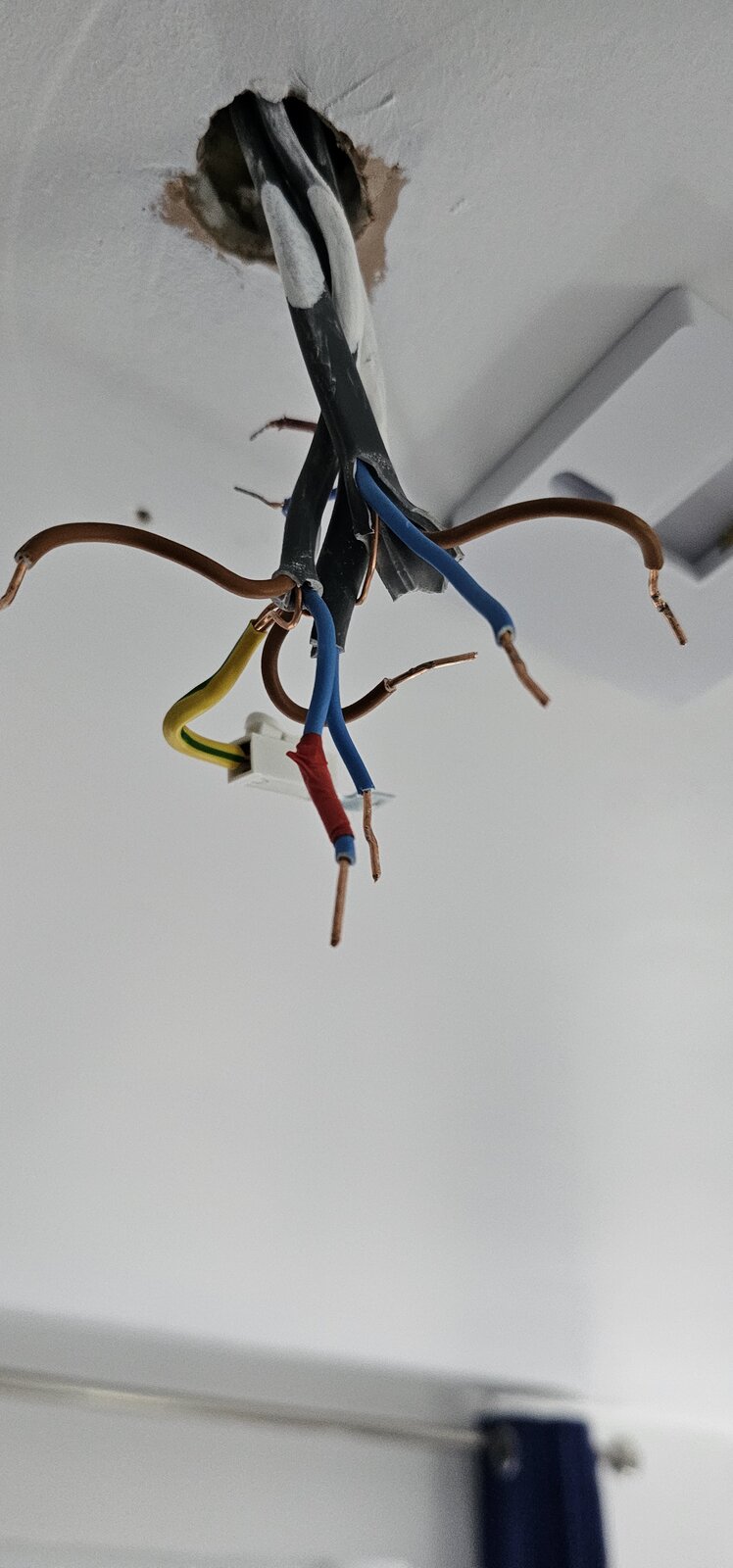

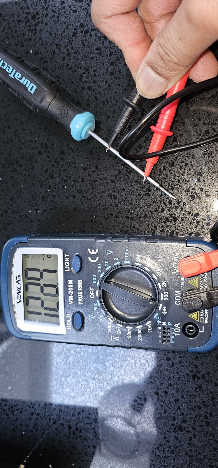

Only blue wires connected to my light

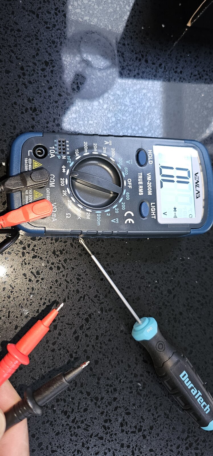

Multimeter just arrived.
Switched it on (pic 1)
Touched the screwdriver with both cables and it buzzes (pic 2). So I have the correct setting for continuity ?

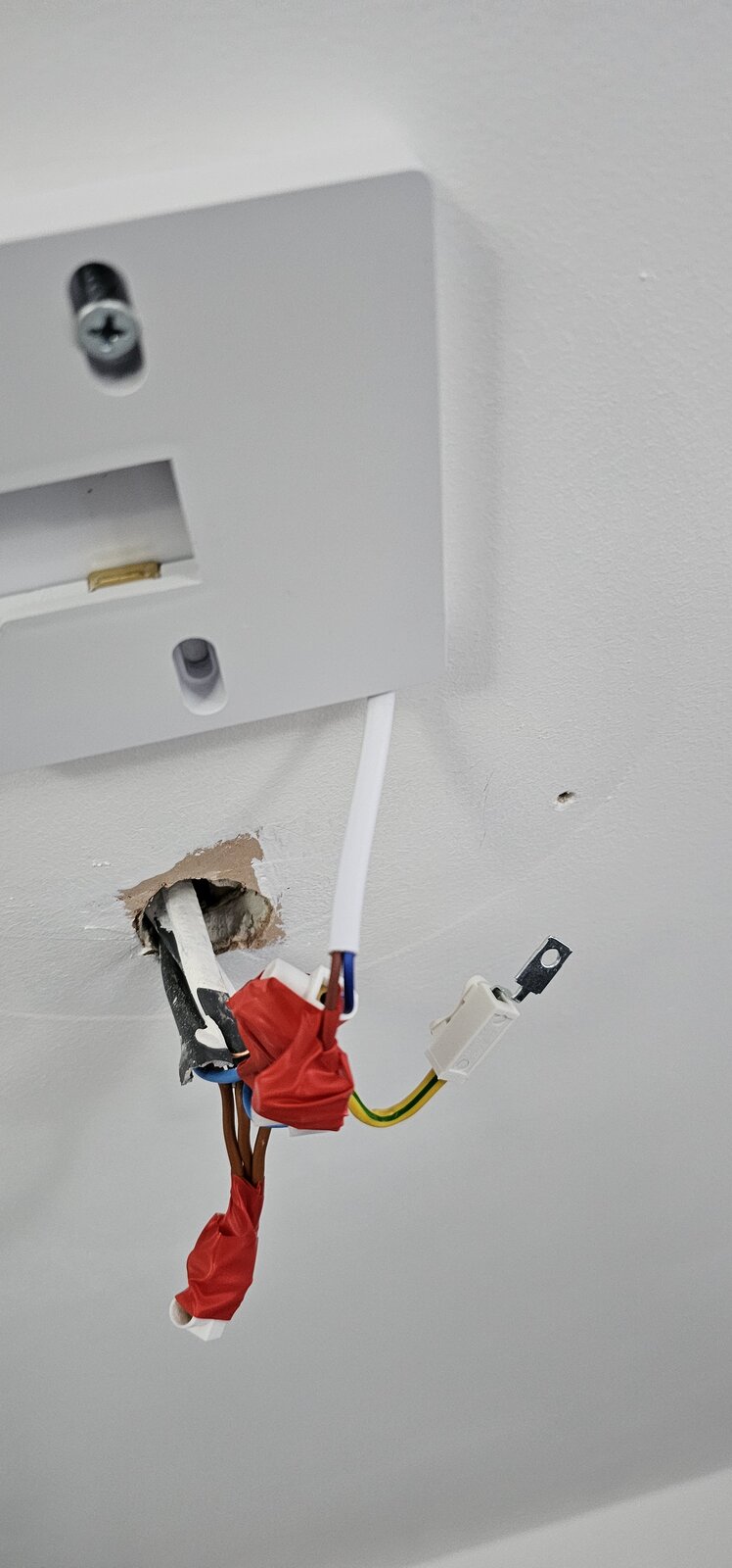

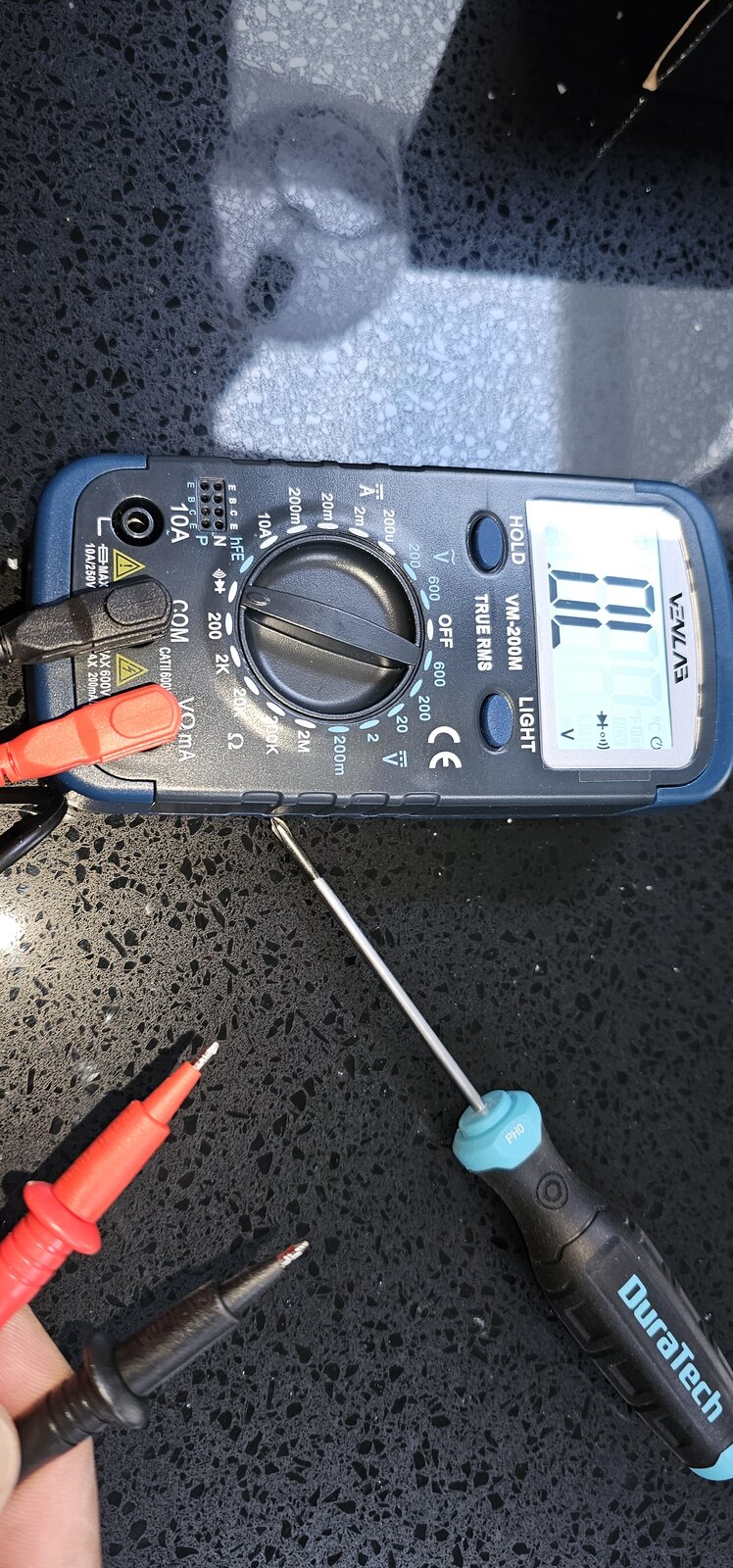

You guys are BRILLIANT! I done what you suggested and hey presto, one of the sets (a blue plus a brown) made the multimeter beep whilst the other sets did not beep.

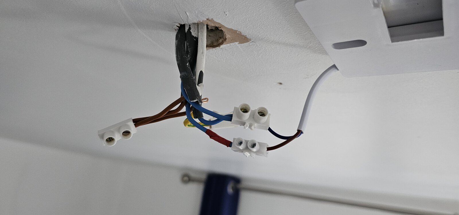

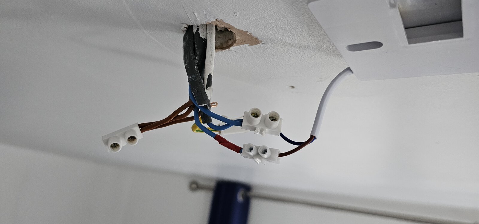

I have red taped the blue cable which beeped (image 1). I assume this blue (with red tape) is a Live to my new light plus I add one of the blue wires from the other pairs to make the neutral, then bunch up all the browns together in a connector block like image 2 (which is from the next bedroom light)??

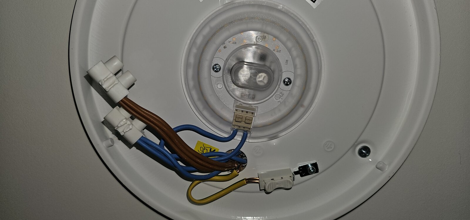

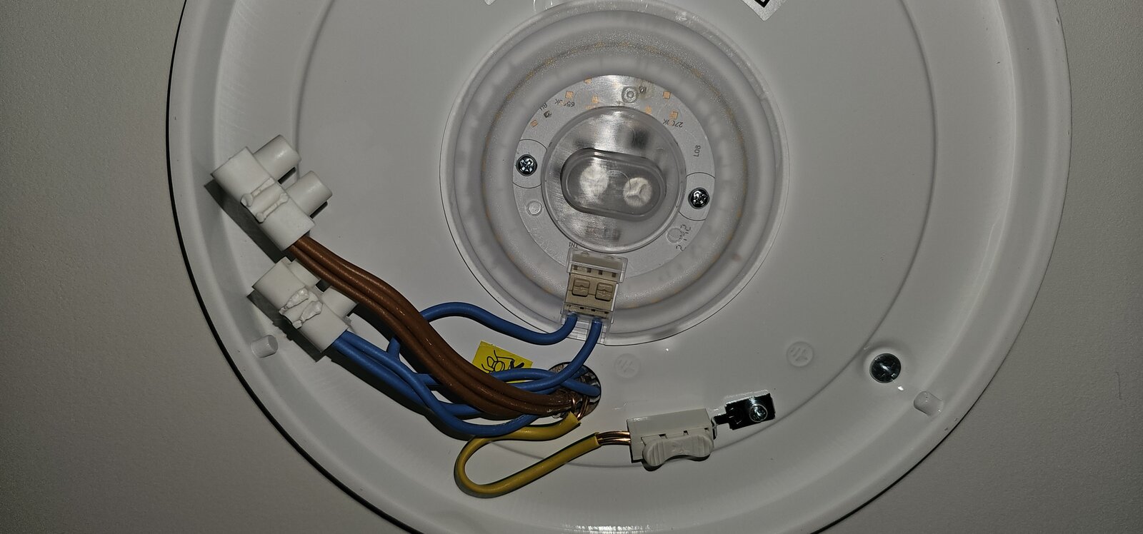

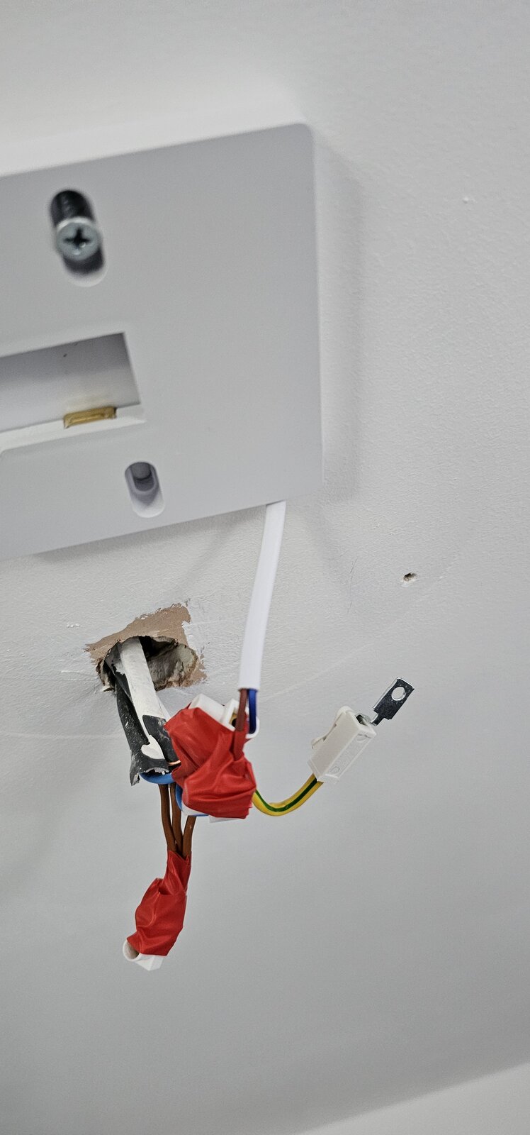

All done.... I'm so scared to try it now! I followed what you have said to the T

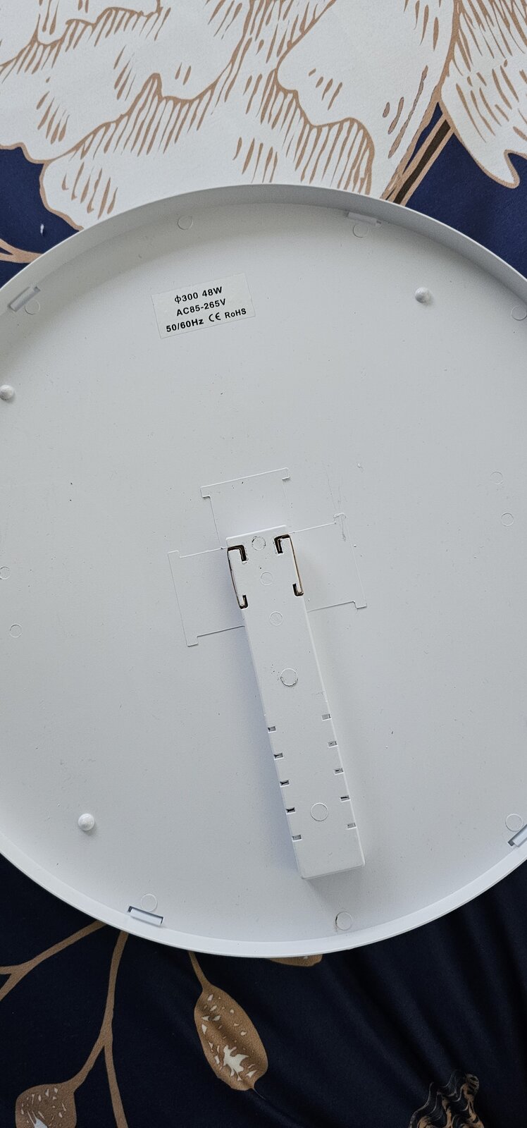

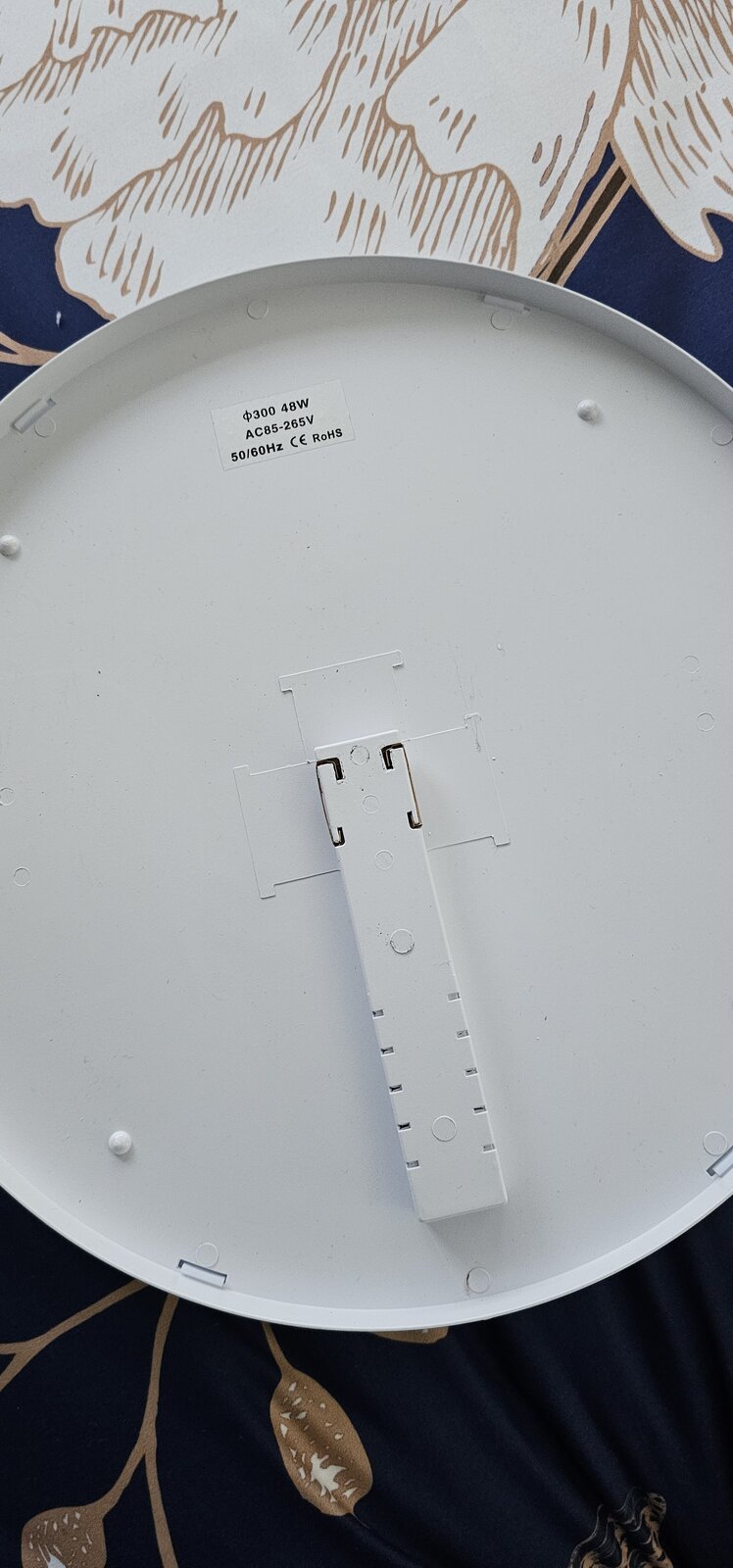

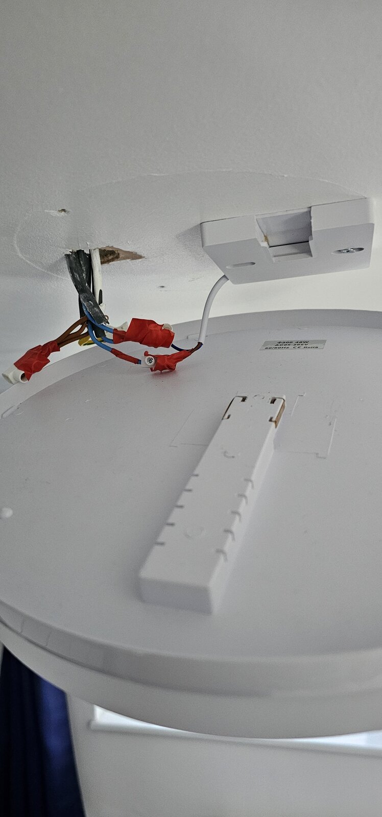

The light has to slot into to cable holder as in image 1.
But my new light does not have a Ground wire screw. Not sure if that's ok?

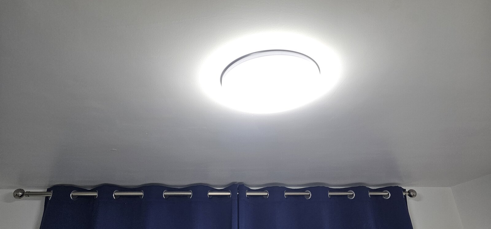

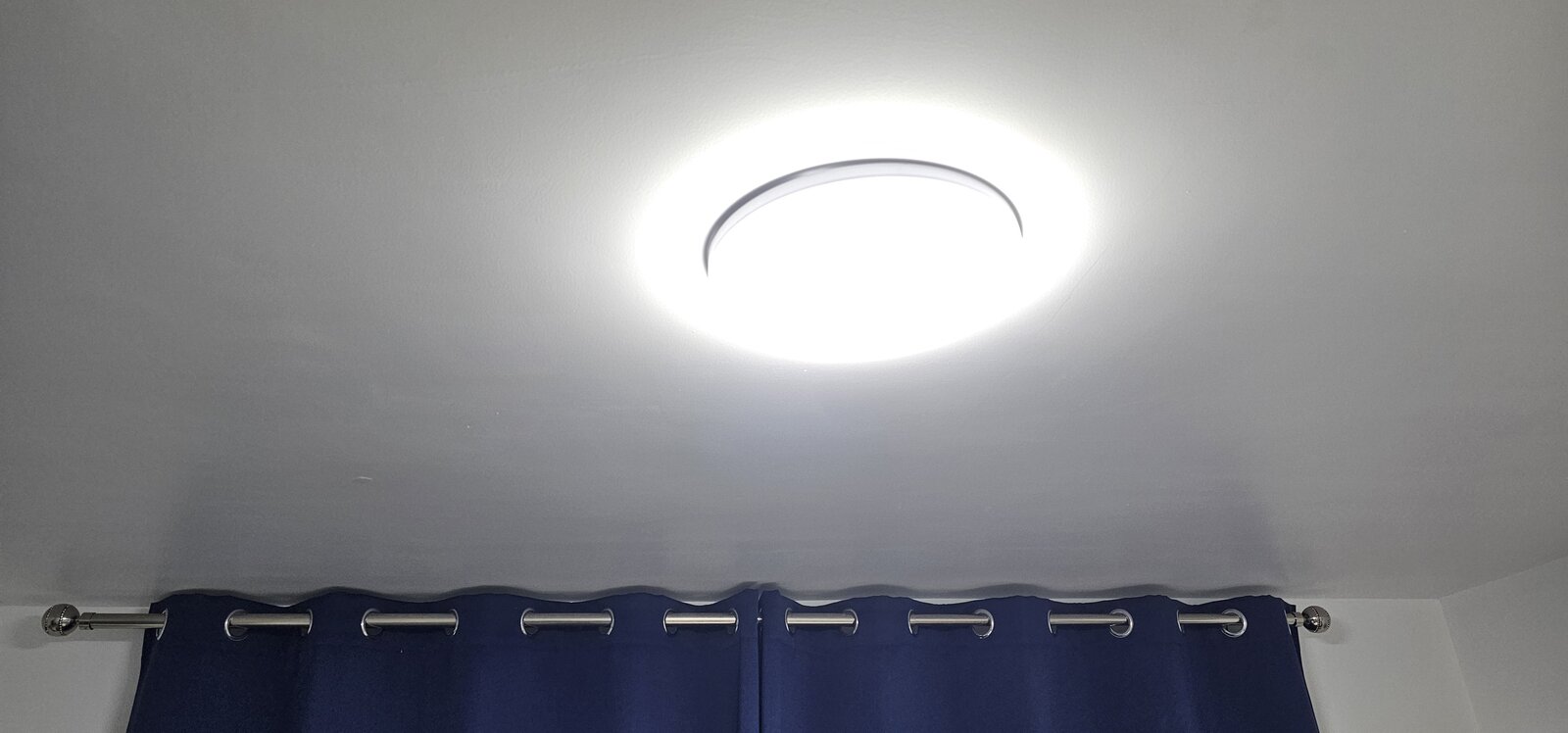

I am not sure if my words alone can express how grateful I am to this group for your patience, support and guidance. I could not have done this without your help.
Thank you ALL and Happy New Year...
