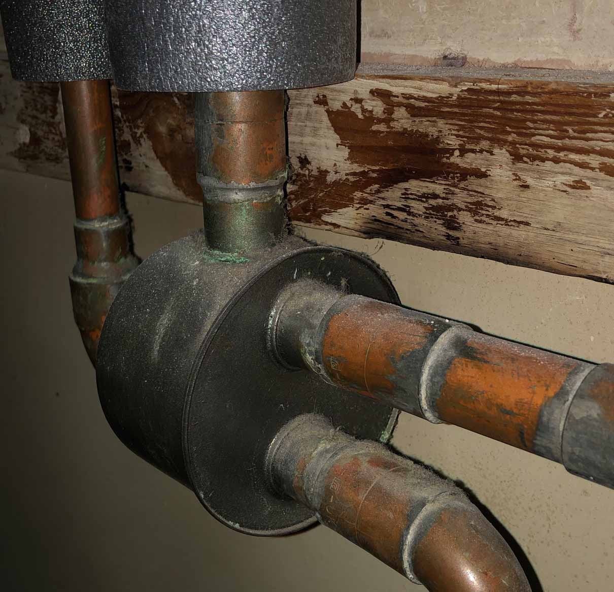

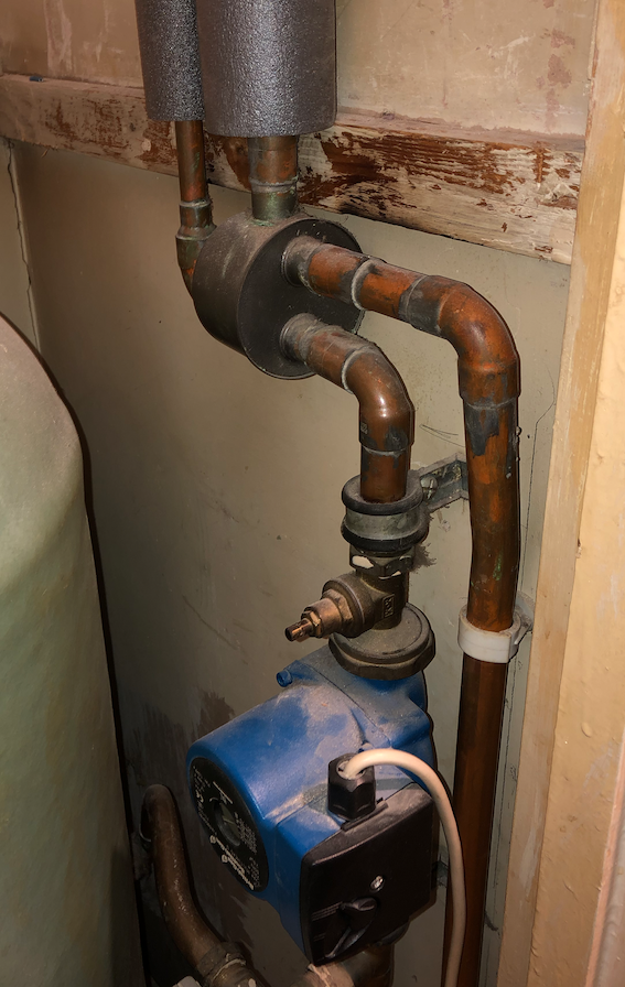

I think the pump is on the return and attached to the round chamber in the picture which also has the feed and vent going in to it. I assume this is just a common connection point as i have not seen one before?
I think it's the return as it is cooler than the flow although don't think it really matters as it has obviously worked before.

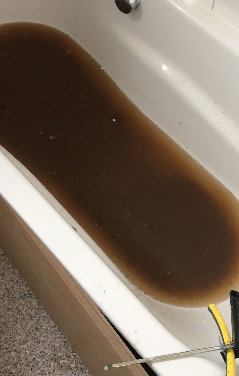

If i run the heating for an hour then the flow pipework that i can see ( i have some access under floors upstairs) is damn hot but the return appears almost cold so i am guessing a blockage judging by some of the crud i drained in to the bath?
I have tried blanking off the vent and using mains pressure connected to the feed pipe to flush through with the y valve open. We did manage to get loads of crud out but rads still seem cold.
Am i missing something here with my flushing technique? What is the round chamber with the feed / vent and flow and return on?

The round chamber with four pipes connected is an Aerjec air separator. Unfortunately they have a tendency to block up. Use a magnet to check the copper pipes near the device (not the device itself). If it sticks, the pipe is blocked.

All the crap in the bath is from draining the header tank and my hose was not long enough to reach the lav :)

1. Establish if pipework around air separator is blocked ,cut out and replace.
2. Check the pump is not clogged up and is actually working.
