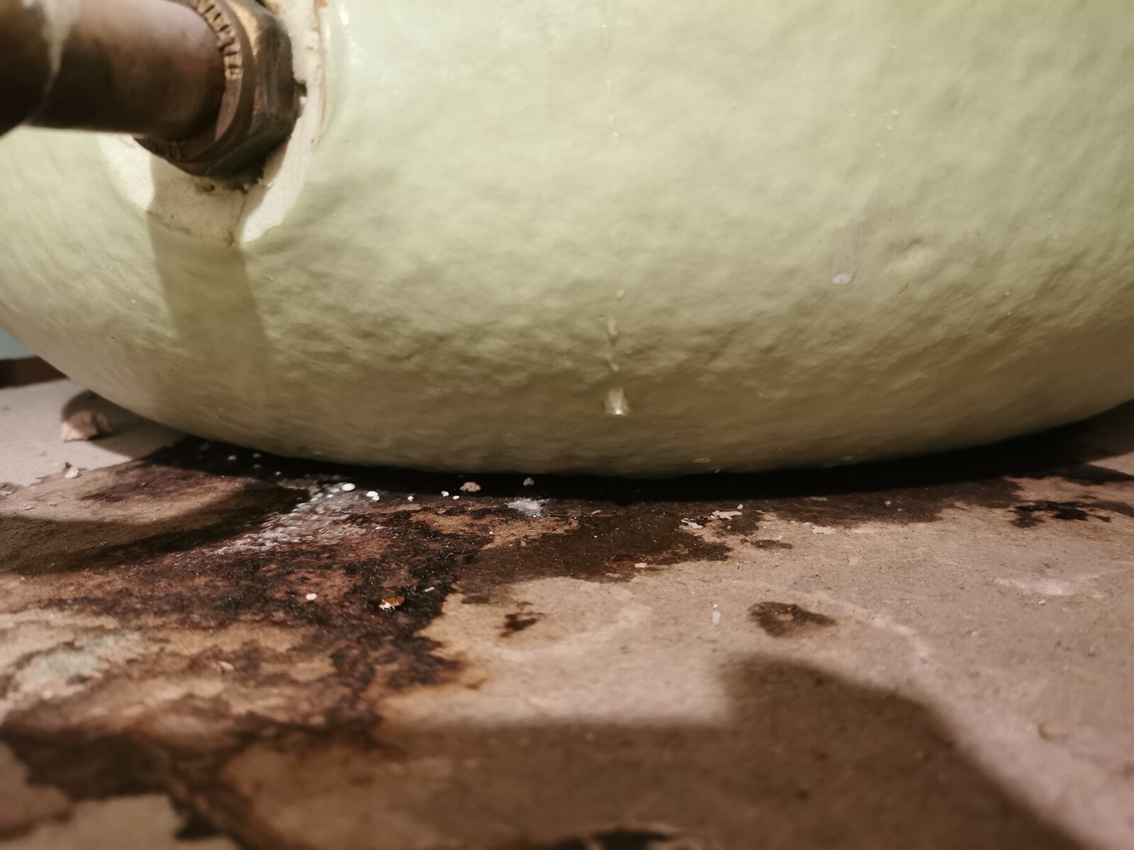

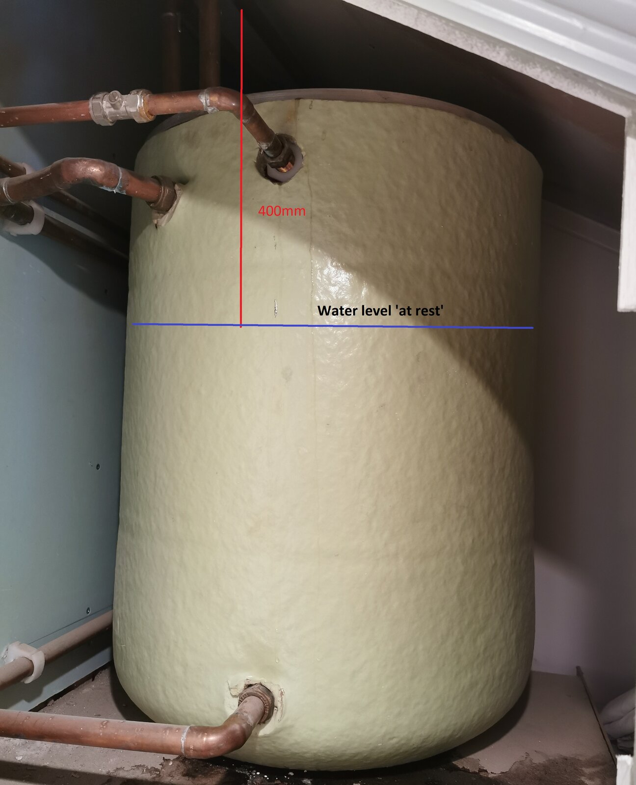

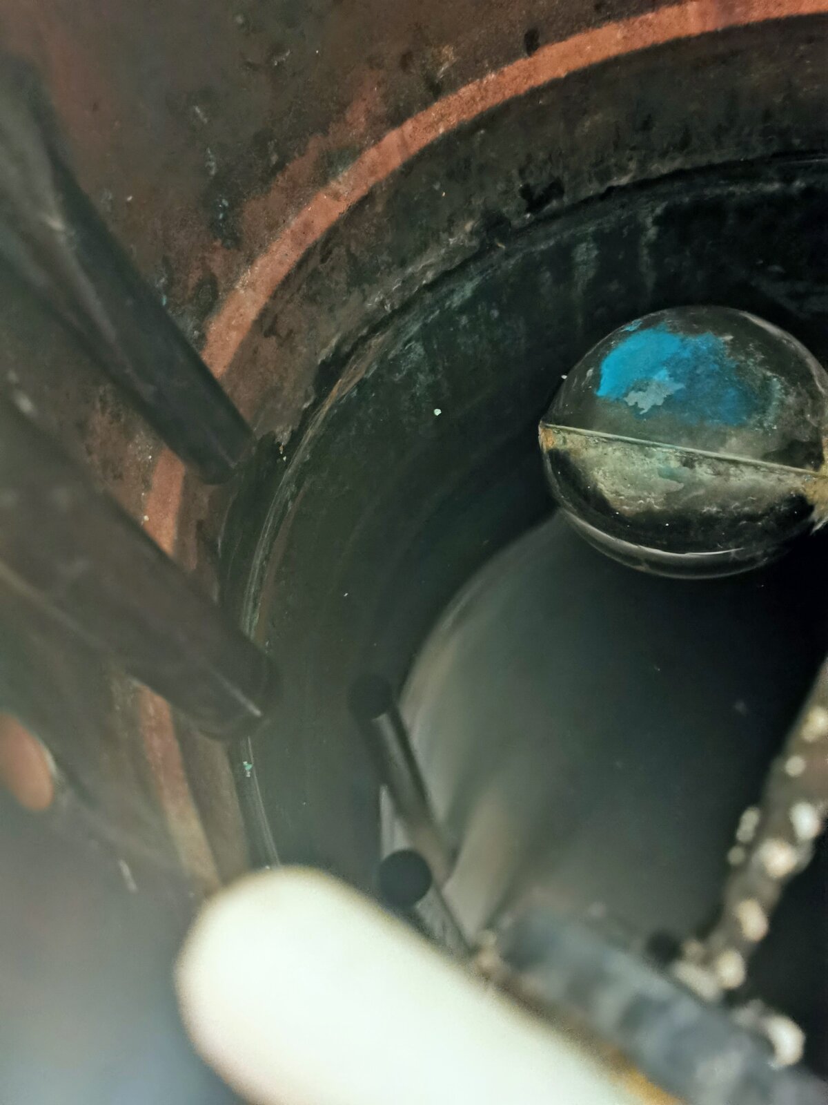

@oldbutnotdead Similarly - I knew the headroom would be close, so I've measured it - and it is around the 400mm mark! Also - I hadn't looked at this for a long while, as I need a ladder to get up there - but there is clearly some leakage occurring, likely over the top of the expansion tank. I have added photos to illustrate. It looks like it has been occurring for a while given what looks like white mould at the base of the F&E tank. I guess the question is - how can I test this theory that the level in the expansion tank is too high and by lowering it, the cycling over may stop?

I can't raise the height of the F&E tank, unfortunately, it is already right up to roof level.
Raising the tank wouldn't make a difference, if anything it would make it worse. IMO. As you would be increasing the volume of water further.
I don't think the expansion tank is big enough for the volume of water tbh. But I'm not the man there.

Expansion tank volume should be about 15% of system volume. Assume 100 l for rads, boiler, UFH etc plus 300l for the store that gives you a minimum of 60 litres which that tank looks not a mile away from.
Couldn't see white mould on the tank pics.
Might be worth dropping the level in the tank a bit (long as level stays above top of highest primary appliance it'll be fine).
Is there any evidence of that tank overflowing (water trails from the overflow pipe- if it was accessible I'd suggest hanging a bucket under it but good odds it splashes on the roof which should leave evidence)

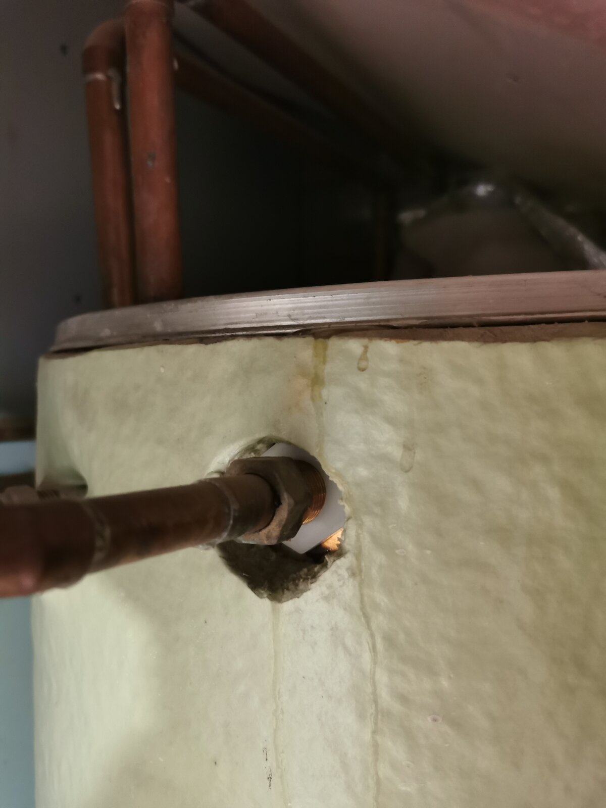

Interesting detail on that pic of the store- the expansion pipe comes out of the side rather than the top. Better for thermal efficiency but could allow an air bubble to form at the top of the store....
Got to say I'd be uncomfortable with the only expansion pipe for the system being on the store, especially with that long horizontal run from the woodburner. Do you get any kettling sounds from the woodburner?

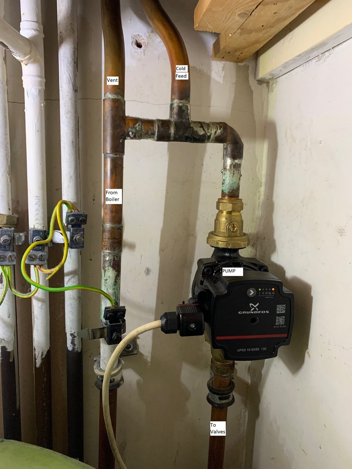

The normal tee in for the vent and cold feed looks like this, with the vent and feed no more than 150mm apart.

To soothe my paranoia my setup has an expansion pipe direct from the woodburner up to the f & e as well as one from the store. And even when I have run the thing a bit hot (top of the store got to about 90°) no sign or sound of pumpover...
Have you a pump on the woodburner and if so is it on the flow or return?.

@oldbutnotdead It was only a small amount of mould around the base of the f&e tank, on the platform it sits on. From observing today, I suspect it is caused by condensation on the lid of the f&e tank running down the outside of the tank. I've added another photo, but hope this is relatively trivial - solve the 'pumping over' and this goes away.
You put "Might be worth dropping the level in the tank a bit (long as level stays above top of highest primary appliance it'll be fine).". I assume you mean f&e tank - but I'm not sure how to do this to any great extent without changing the ballcock and arm. Is that what you meant, or is there another way to temporarily test the theory?
There's no evidence of the tank overflowing - but it's not easy to spot - it's an internal overflow pipe from f&e tank (see photo - I can't remember the proper term for it!).

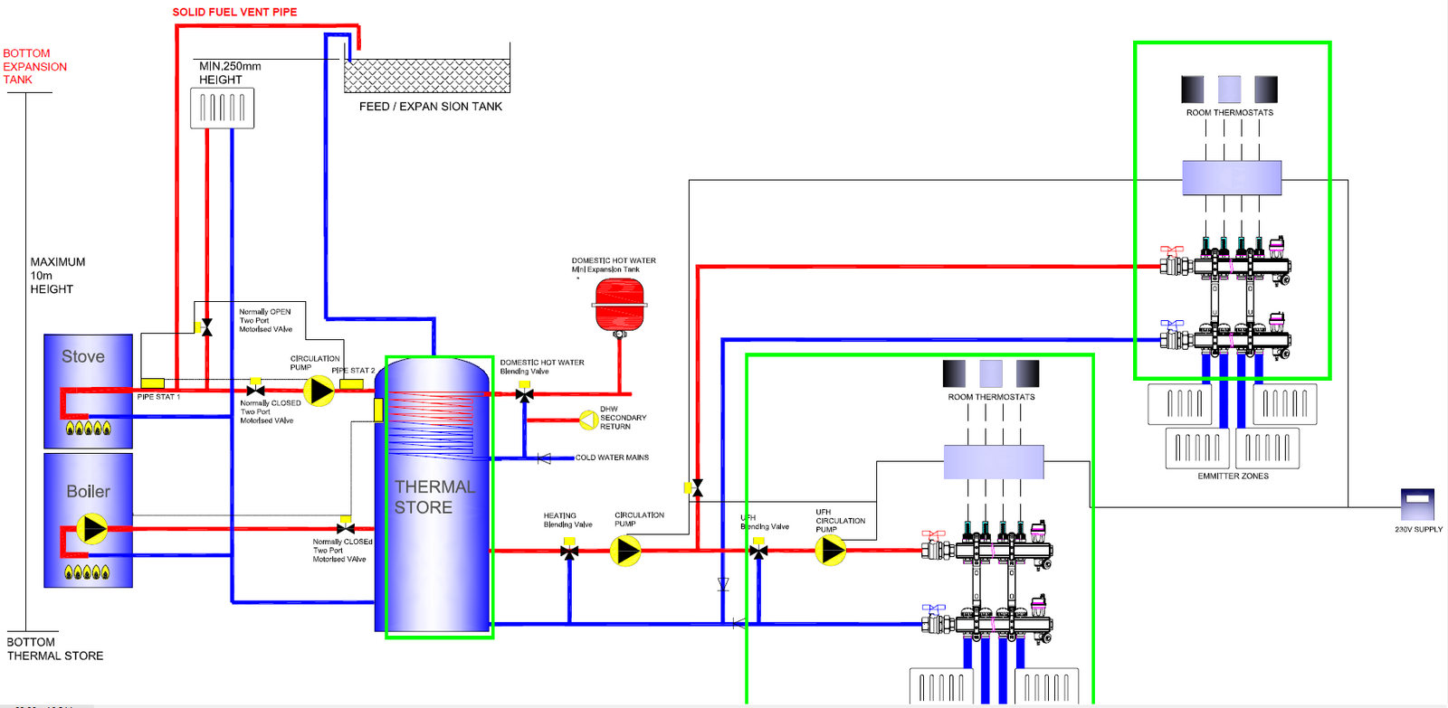

I've also found the original schematic - that might prove useful. I think we installed true to the schematic.

That original schematic doesn't show a cold feed going anywhere from the feed/expansion tank, wonder why not?.
Other than oversight, I don't know - there is definitely a feed out from the f&e tank to the store, as you can see in the pictures.

Neither of the expansion pipes are below the water level in the expansion tank - at the moment (photo attached). The fire hasn't been lit for a couple of days with being away. So, I'll light the fire, and monitor:
1. That the cycling occurs as soon as the woodburner pump kicks in (it definitely stops cycling when the pump stops - I'm just not 100% about the starting point, e.g. it may be when the pump kicks in and the water is hot enough).
2. The height of the water level in the expansion tank when the cycling occurs - and whether it rises above the height of the solid fuel expansion pipe.
Anything else I should check?
