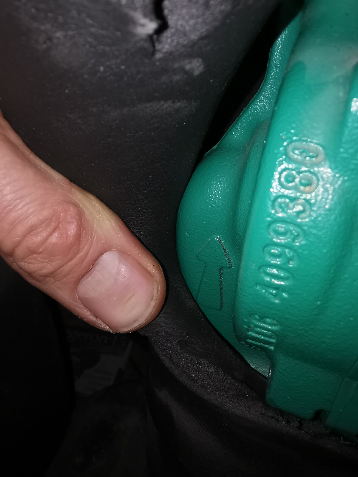

Ok thanks for that, you show a photo of a pump that’s on the flow according to the label, is the direction arrow on the pump body pointing down
I'm not sure that was my picture - was it the one posted by @Johntheo5 ?
I checked anyway - its pointing upwards / with the flow in the direction of the thermal store.

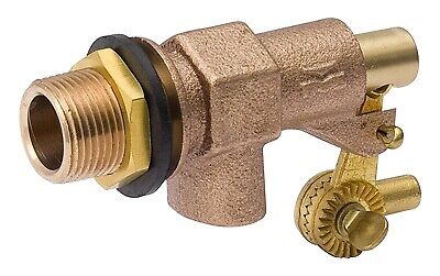

Is it worth trying to lower the ballcock to lower the water level in the f&e tank - as mentioned by @oldbutnotdead earlier in the thread? What's the best way to do this - ideally I'd just have an adjustable part 2 ball valve like this one: https://www.ebay.co.uk/itm/385299677704
But it's never that easy... so, I'd rather not consider importing one from anywhere - adjustable, part 2 valves must be available somewhere in the UK, but for the life of me, I can't find one. Has anyone got a link to a standard, recommended, adjustable ball cock valve?

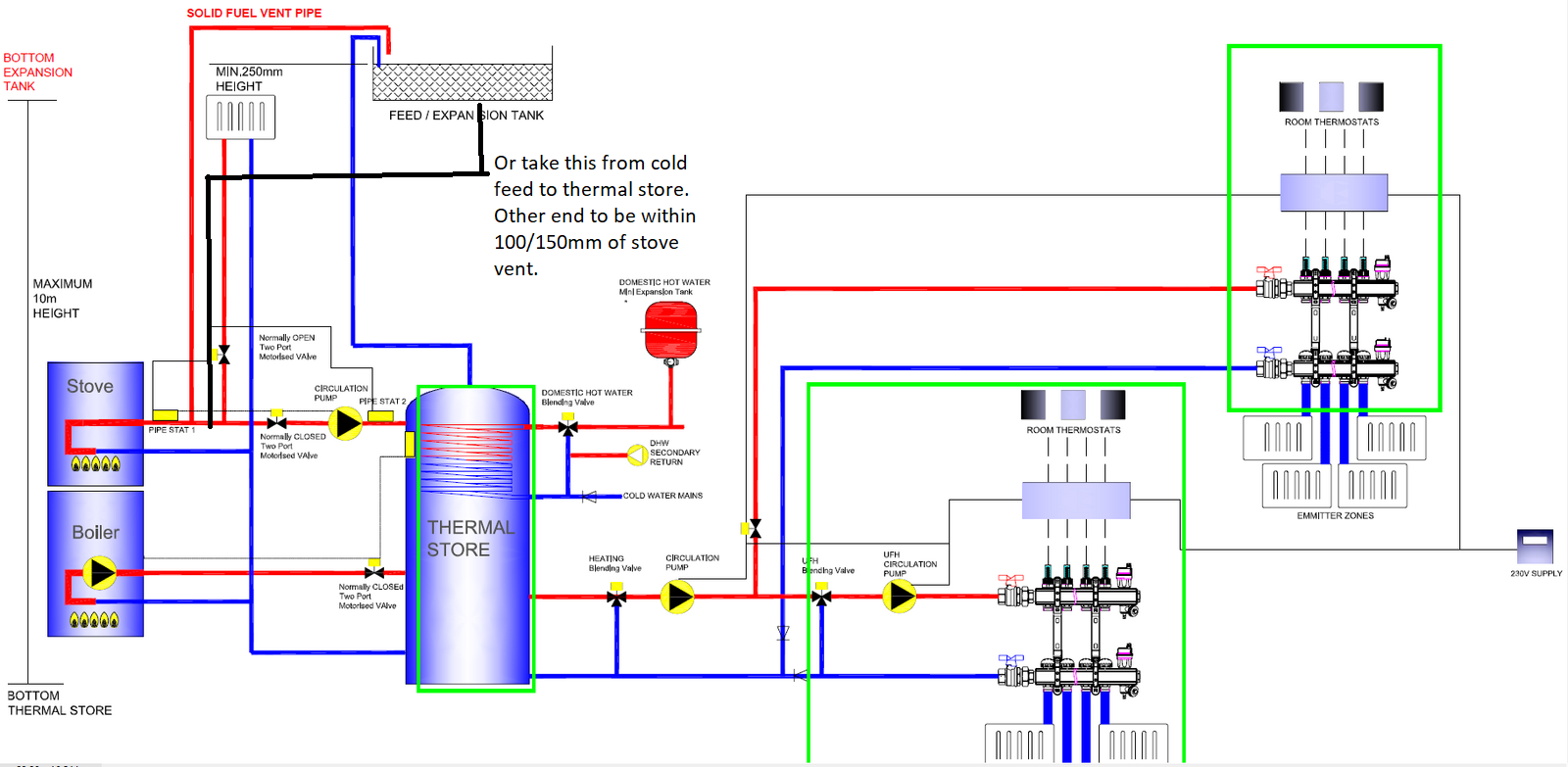

There should really be a cold feed teed in just after the store vent pipe, that should stop the pumping over.
I've been trying to think this through today - but, apologies, I can't work out exactly what you mean and where to put the tee. Are you able to clarify for me? Can I ask why you think that will stop the pumping over?
Normally any open vent system has its own vent and its own cold feed like I showed in post #21, it may but only may help to install a dedicated cold feed to the T.store as shown. What is baffling is that there is no pump over with with the boiler circ pump running at max speed but there is pump over from the T.store pump running at minimum speed, it could point to some restriction in the T.store circuit pipework, so maybe worth checking this out.
If the fire is lighting now increase the pipestat setting to stop the T.store circ pump and immediately manually latch open the normally closed 2 port valve before the circ pump, this will now give the hot water two paths (gravity circulation), one through the dump rad and the other through the T.store.
If it is circulating through the T.store you may (but I'm not familiar with normally open 2 port valves) be able to manually latch shut the dump rad 2 port, this will then mean all the circulation is through the T.store, if any problems you will soon see it venting into the F&E tank.
I presume you have previously checked that the 2 port valve before the T.store circ pump is in fact opening when the pipestat stats it?.

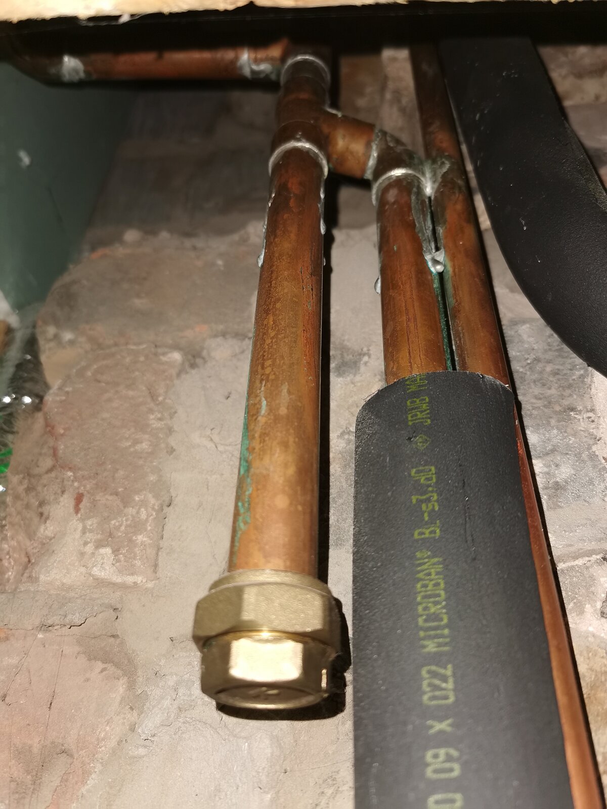

Thanks for that explanation! This is where it becomes unfortunate... I think we used to have this dedicated cold feed, but about 3-4 years ago, we asked another plumber to help us try to solve the cycling over issue. He identified that the cold feed was likely superfluous and could be contributing to the problem, so recommended that the feed was removed. I've attached a photo, looking up towards the f&e tank - you can see the cap on the pipe. The other end is teed in just before the woodburner valve (which is just before the pump).
Obviously, removing the cold feed didn't solve the problem and we've put up with the issue since, but I'm pretty determined to solve it this year!
I agree with your statement, "What is baffling is that there is no pump over with with the boiler circ pump running at max speed but there is pump over from the T.store pump running at minimum speed" (as a layperson here, it is driving me nuts trying to understand this! I always play the game of 'what's the difference' to try and diagnose issues and this is no different - but the boiler circuit is almost identical! So, your other point, "it could point to some restriction in the T.store circuit pipework, so maybe worth checking this out." seems to be an important one.
