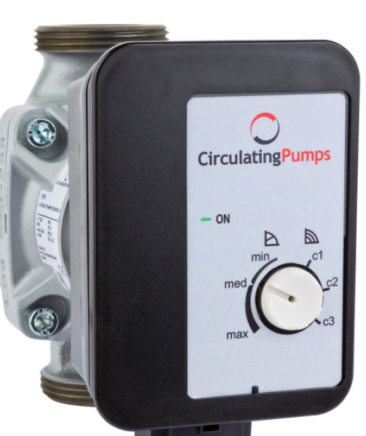

I just thought that I would follow up on this issue, as I received a lot of help and I always like to know the outcome. I did replace the pump, I used a was a 'Circulating Pumps CP50 High Efficiency Central Heating Pump', because it allowed me to run the pump at a low constant speed. All of the other pumps we discussed are no longer available with the manual regulation capability (I believe some regs have changed - but don't ask me which!).
This almost solved the problem - and the overflow was down to a very low trickle. I've managed to push up the overflow pipe about 1-2 inches higher into the roof space, and now we're are down to the occasional drop of water overflowing. I think that that is probably good enough - but if it does frustrate me enough, I could extend the current overflow pipe a little further towards the apex of the roof, to gain another couple of inches, which should completely resolve the issue. But for now, I'm enjoying the fact the system is (broadly) working as designed.

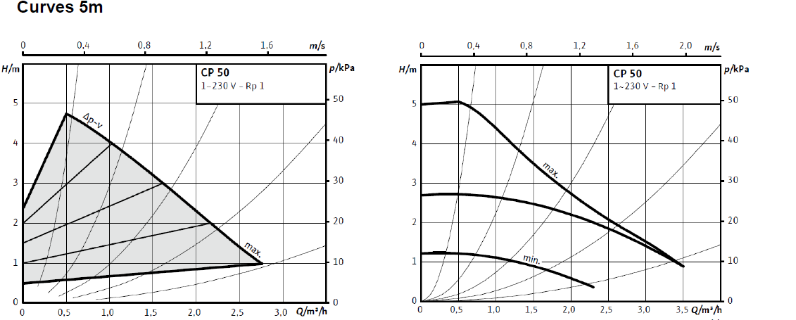

Thanks for posting back, I'm surprised that you now can't change the CP & PP settings (incrementally, in 0.1M steps), on the Wilos, however your CP50 should fit the bill even though it hasn't got a CP mode.
You say you can run the pump on a low constant speed, are you now running it at C1?, if so by chenging to PP mode you can certainly get a lower head which may stop that pump over completely?.
For example if in CC setting C1 and assume pumping 1.0m3/hr at 1.1M then changing to 1.0M PP mode will flow 0.78m3/hr but at a substantially lower head of 0.68M and maybe no pump over?.

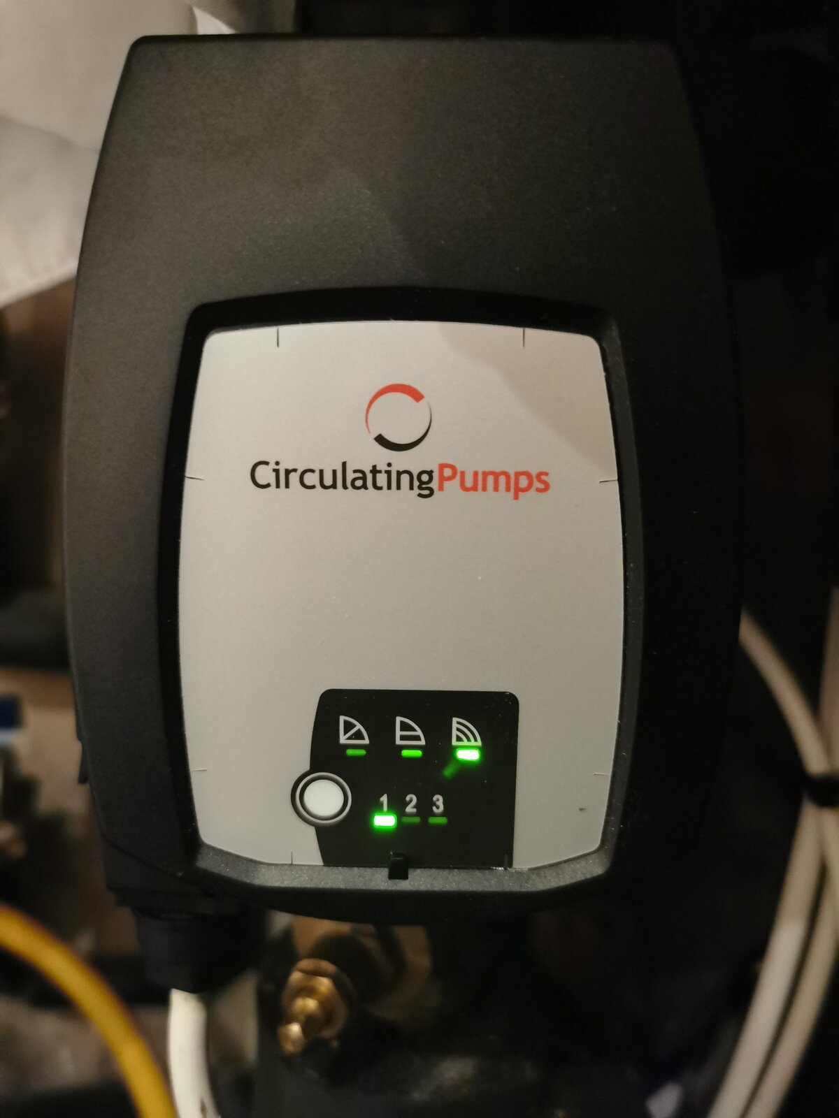

Thanks John - but this is exactly the issue that I found. The pump you post can't be purchased anymore - in spite of my best efforts. I know someone with the pump you posted, and I tried to buy the same. However, that is the old version CP50.1. All that is available now is the CP50.2 and that's what turned up - I've added a photo. Most websites still show CP50.1, and most technical spec sheets are also for CP50.1. I can't find the specs for CP50.2. This pattern is essentially the same for Wilo too (I took two of them back as they sold the new version, not the old as advertised).
I tried all 3 modes of operation on the CP50.2 at the lowest setting (variable differential pressure, constant differential pressure and constant speed). Only constant speed on the minimum setting more or less resolves the issue.
