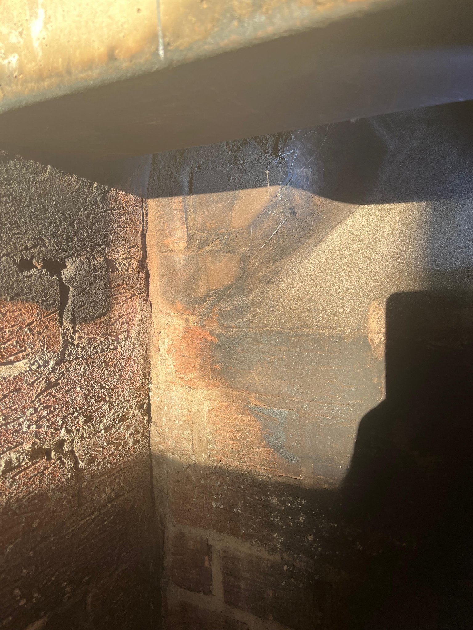

The light was just right, so I cleaned up the bricks near the gather and took a photo. Does this picture shed any light on the construction?
I can see that the jambs aren't tied into the back wall, they just butt up against it.
I'm not familiar with this method of chimney construction. What part of the country is the house? I'm guessing you've got solid brickwork back to the party wall that takes the throat and gather brickwork. Normally you have a fireback and throat lintel that does that.
It looks the same way to me... as in not tied into the jambs. The ultimate question is are the bricks there to fill a void or are they structural to support the 200mm chimney breast on floor 1 and 2. I live near Peterborough. Yes I would say I have roughly 230mm at the back of the chimney before I get to the party wall, so I've assumed that is 2 leafs tied together.
It's hard to believe that the entire structure relies on those 2 leafs due to the interleaving nature of brickwork. The load should be distributed to the jambs shouldn't it? Additionally... if they are load bearing... they'd be tied into the jambs - surely.
Going by the dimensions, the back wall is supporting the chimney breasts above more than the ground floor jambs. There will be a way to support it, even if it means knocking into the downstairs breast above the lintel. Depends how much work you want to get involved in. It does mean that widening the opening might not be so much of an issue.

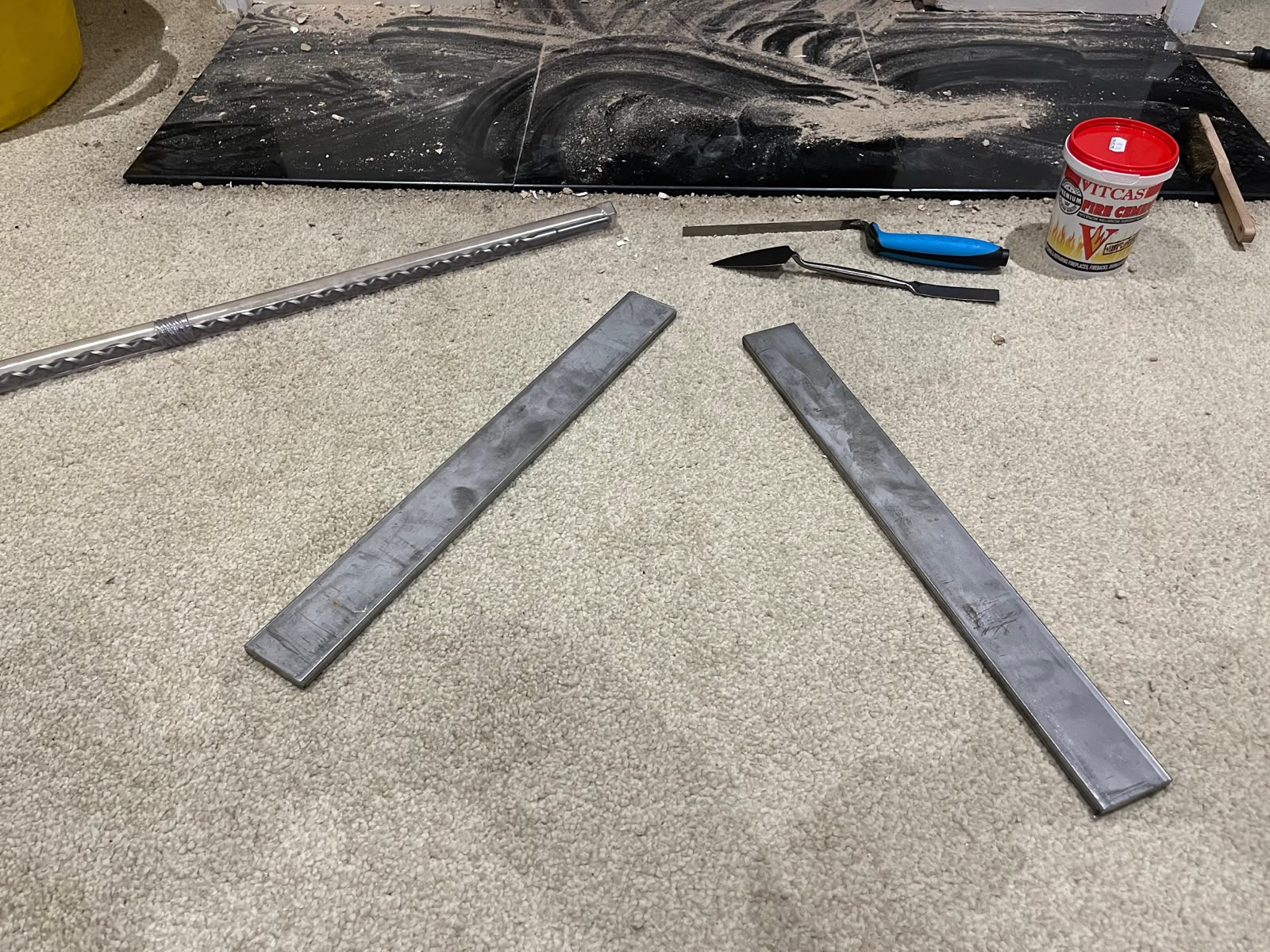

My original plan was to stitch these 2 bars underneath the liner from just above the lintel with some GP11. The bars were going to sit on the back leaf of bricks and not penetrate the party wall... I had thought all I was going to support was the bottom column of terracotta pots, but the fear of it being more structural gave me pause for thought. The only other option I can think of if that isn't suitable is to go in from the side of the jambs with some form of cantilever lintel. Not sure what else I could do...

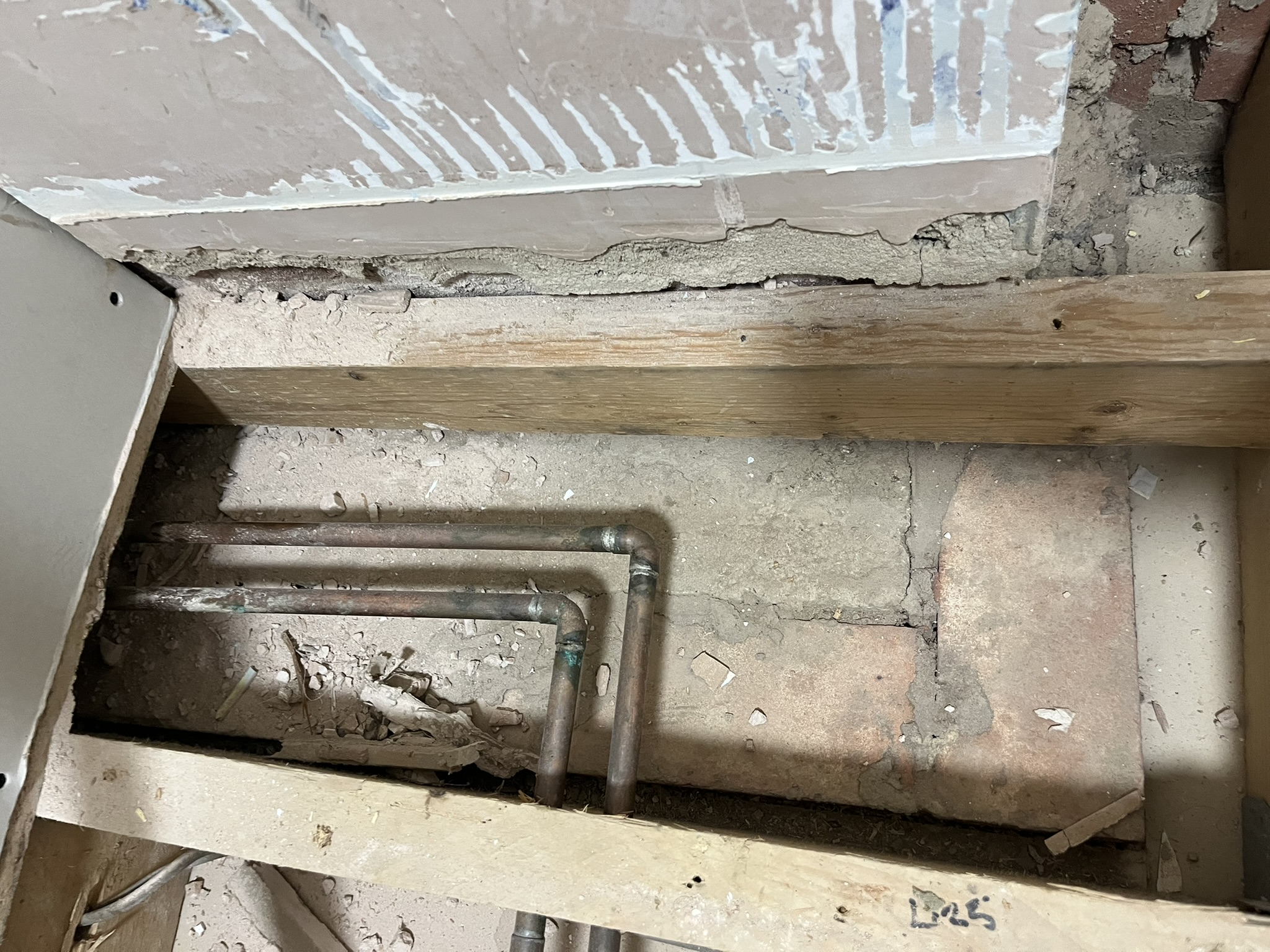

I've taken the floor up in the bathroom above the fireplace and you can see the step between the ground floor breast and the 1st floor breast. I did consider drilling an exploratory hole and shoving an endoscope in there... but it's just going to be full of bricks right?
I'd knock a few bricks out above the lintel and see what you have inside. You might be able to get a steel plate with a hole cut out for the flue which could sit on the brickwork and support what's above. Worth having a think about overnight.

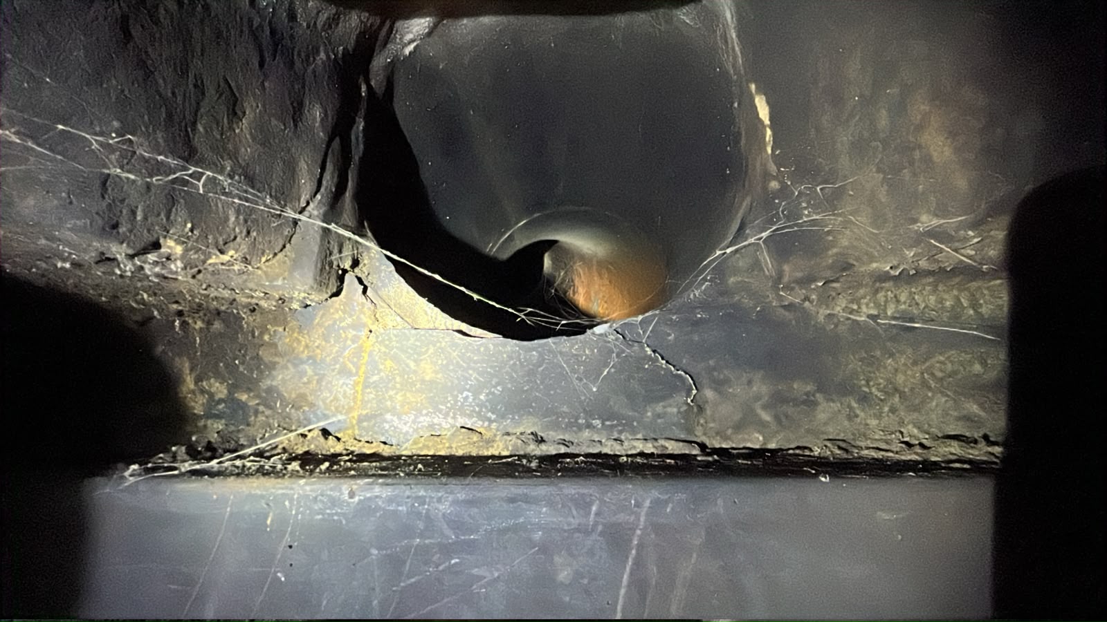

We're thinking along similar lines... I've just had a really good look up the chimney and I hadn't noticed this before, but the liner is partially supported by slate sat on top of the lintel and just under the edge of the terracotta liner at the front of the breast. I expected it to be steel... Seems an odd choice of material as a cantilever...
