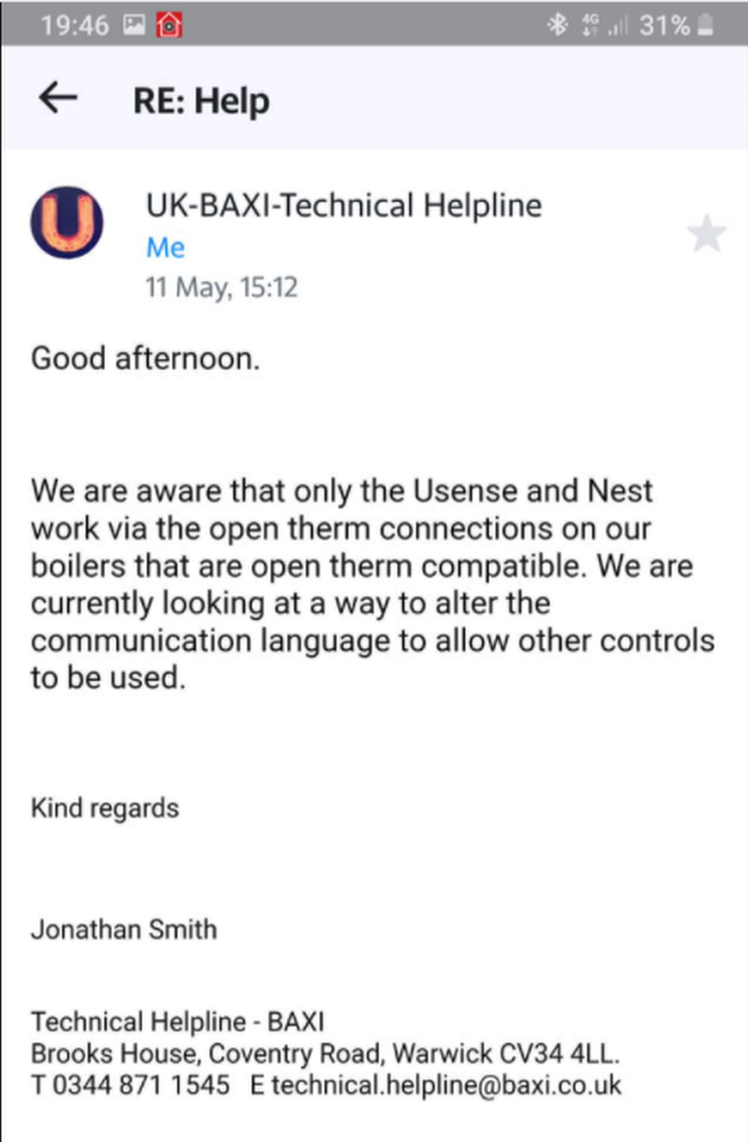

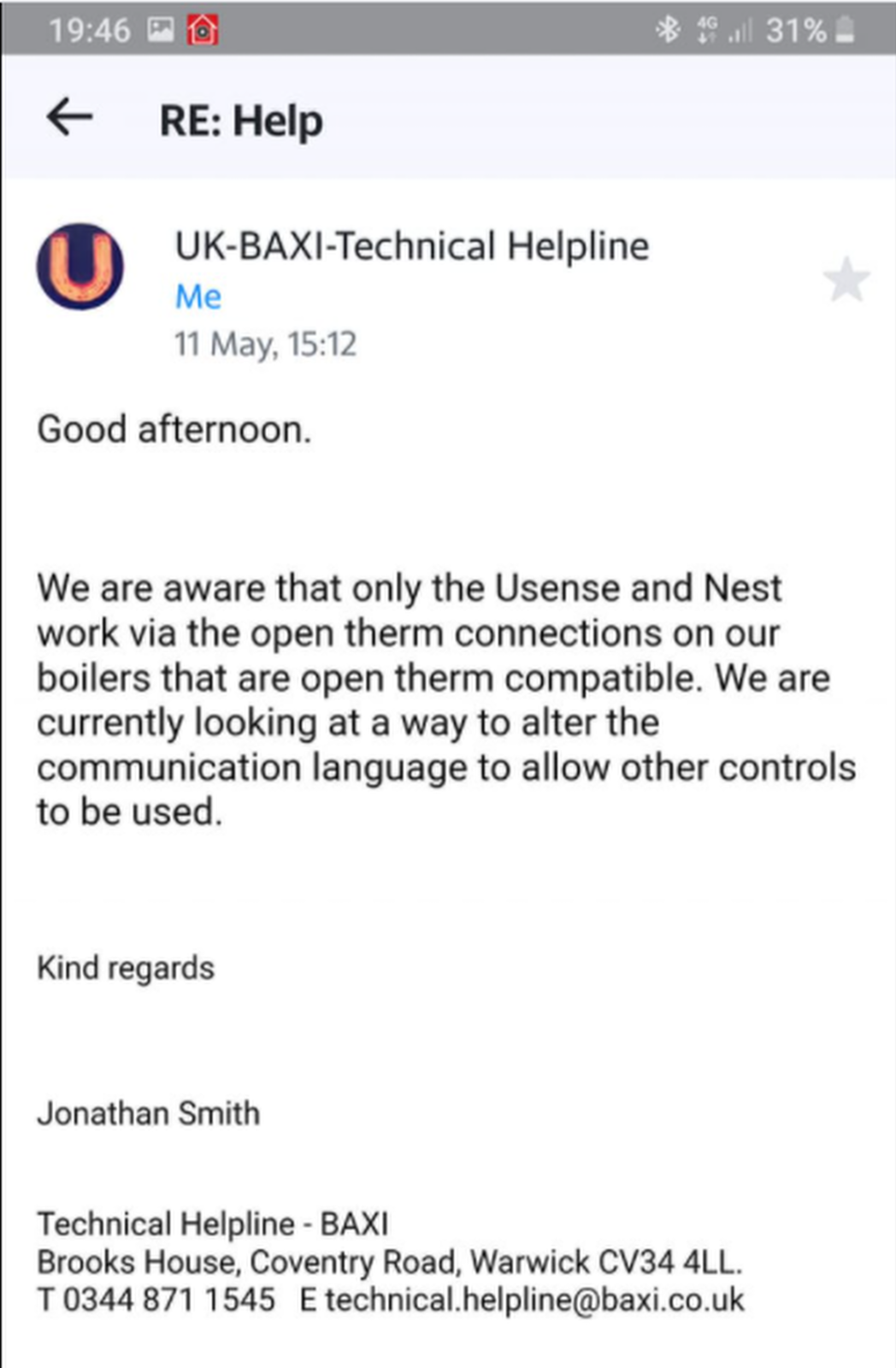

Ah, that may be your problem. The Baxi range is well known for being rather temperamental on OpenTherm. I believe it plays reasonably well with Nest, but not so well with some other controls. Baxi might be able to offer a firmware upgrade if you call them, but I don't know whether the issue has actually been resolved yet.
Here you go, found a relevant bit of info from someone who knows. Essentially Baxi have used some bits of the OpenTherm communication protocol to provide control, but they aren't members of the OpenTherm Association and haven't fully implemented OpenTherm in the way it was designed. Baxi boilers aren't OpenTherm certificated. Ergo, they only work with Usense and Nest.
I believe the new baxi boilers introduced Jun 2023 have a new pcb and are open therm certified, I don't know enough to know if that means they will now work with all open therm controllers.
