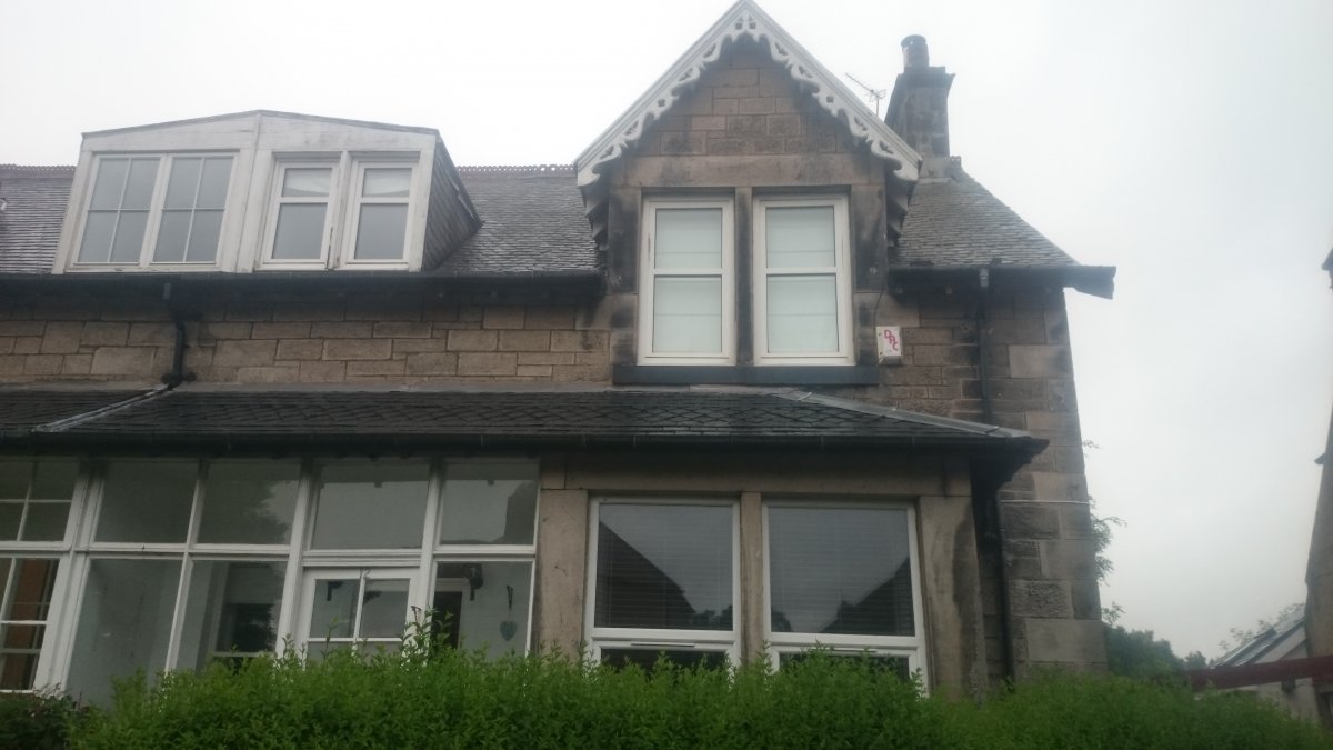

Hi - I was hoping you guys could give me the benefit of your experience on a quote I received for a re-roof on my 1900s 4 bed semi-detached property.
It's more than I was hoping to spend by a considerable margin... we're getting more quotes in but what do you think overall? I was thinking around 15k, am I just being unrealistic?
I'm in Fife in Scotland.

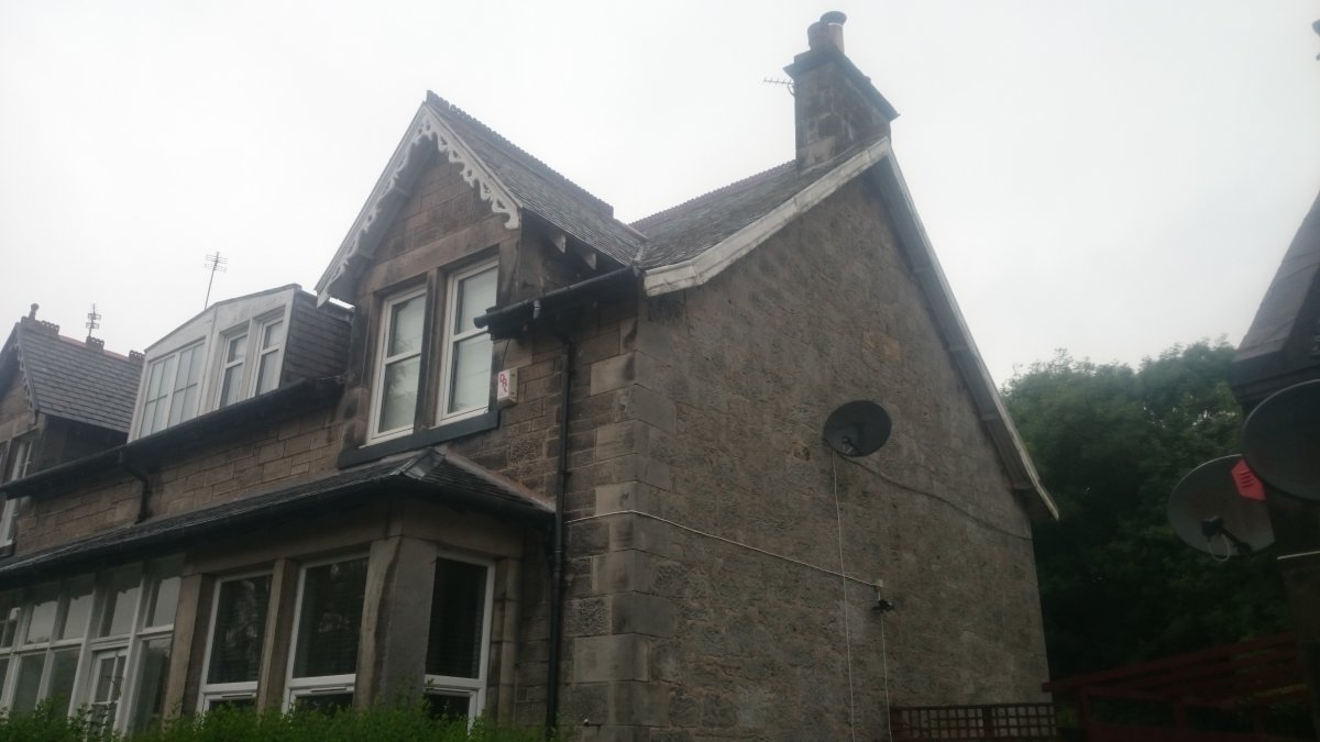

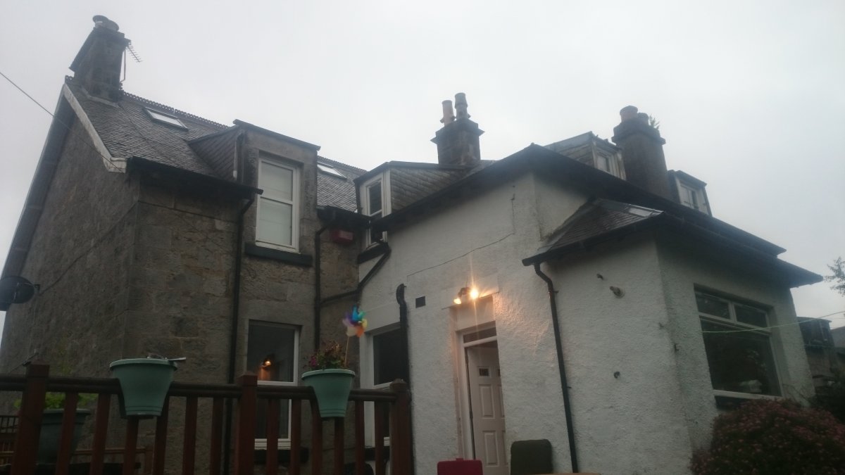

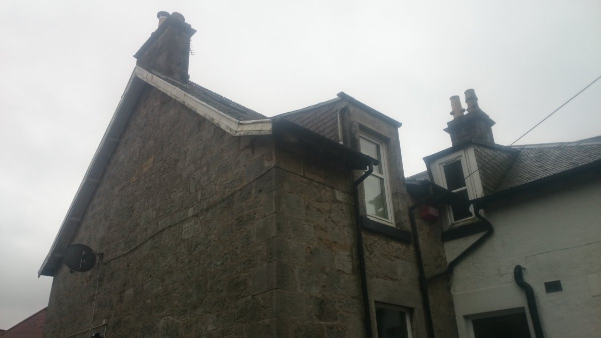

Ah sorry, that info would have helped, the quote doesn't actually have sizing on it.
The house footprint is around 90m2.
It's a hip and valley roof. There's a pitched roof kitchen extension at the back and a front dormer with flat roof as noted in the quote.
Apologies if these are absolutely no use whatsoever, but here are some ground level shots from front, back and side (I have none of the roof itself).
Thanks for taking the time to look!

Why do you want to re-new the roofing?
Its hard to figure out where your house ends esp at the rear?
How many dormers and chimney stacks do you have?
Is the front porch roof included?
On the face of it, your slate roofing looks to be in good condition - patches of uneven or tipped slates, sand & cement fillets instead of lead abutment flashings, & a lost cause of barge boards.
Nothing is said in the quote about fascias or roof insulation or rainwater goods.
What about the cheeks on the dormers and the front dormer looking pretty rough?
The original slates should be in good condition with only a few needing replacement - if you have heavy thick slates then they might be worth more second hand than the proposed new Spanish replacements.
Also, the use of expensive copper nails with cheap slates seems an odd one on the part of the roofer.
Thanks for the replies. I'll answer what I can.
- We were looking at re-roofing as the roofing company told us the roof is 'at the end of its useful life'
- We called them in originally as there was a leak coming through one of the window frames in a bedroom at the rear
- 3 chimney stacks, only the one at the gable is open and in use
- 4 dormers
- The porch roof seems to have been done more recently so is not included
Very interesting to hear re selling the existing Welsh slates and the use of copper nails, it's not filling me with confidence!

Had another roofer come round and he said the Welsh slate would last a lifetime and we should just fix the leak, spot repair where necessary and look into the condition of the timber (I presume at the eaves but I wasn't in).
He's going to pop a quote through the door next week.
