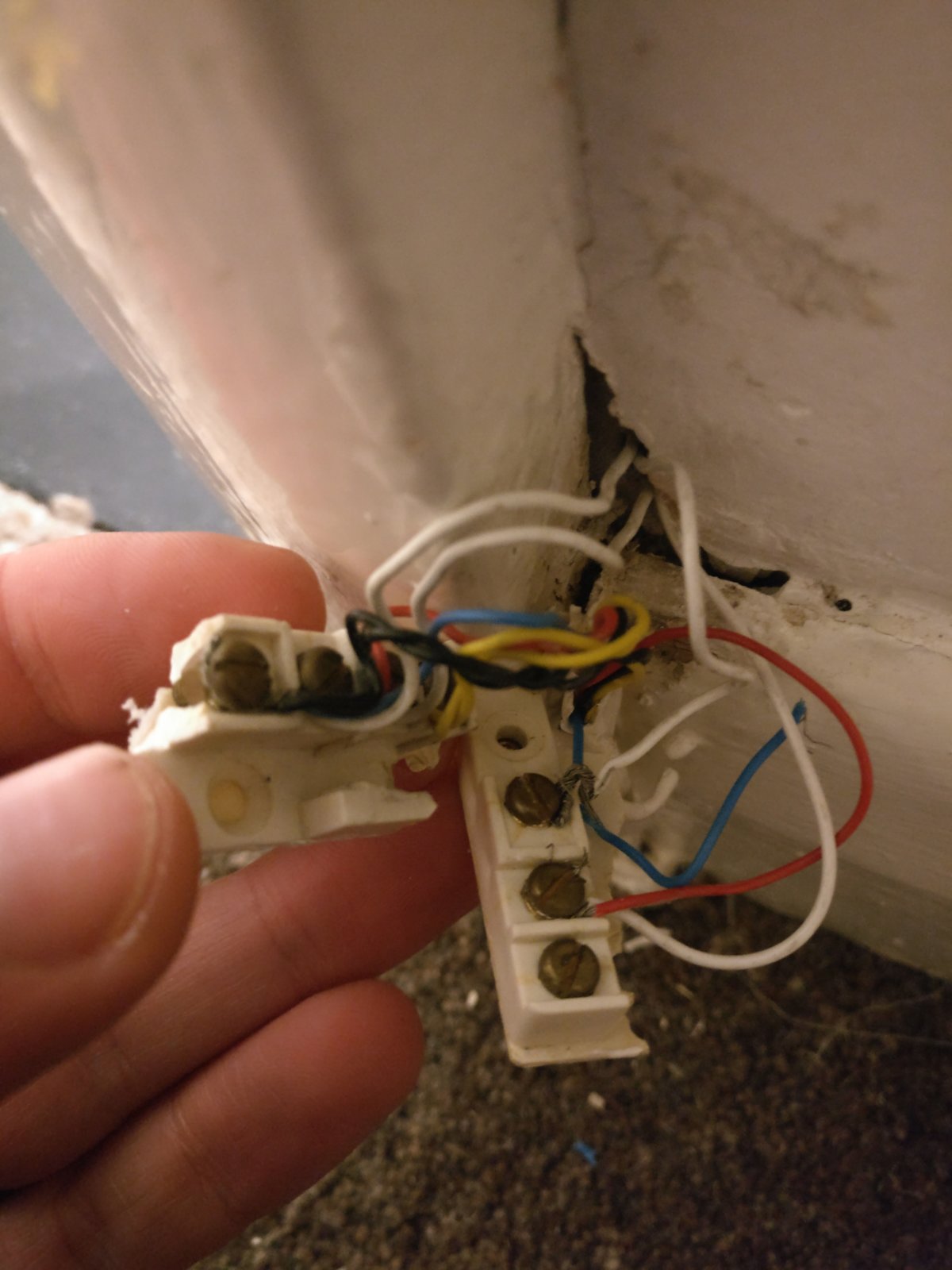

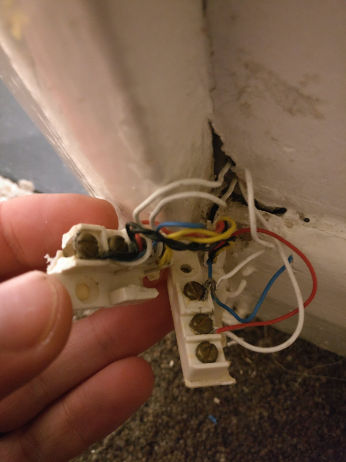

I was moving a large cupboard upstairs and managed to destroy one of the sensors on the skirting board.
I reset using my code but Tamper 4 is now flashing which i take it is the one I knocked.
Is there any way to bypass this one for the meantime? The wires where ripped out and housing smashed so can not put the sensor back together.
Many Thanks
Jamie
? Sensor on skirting ? Post a picture... it's either a junction box or a panic alarm
Could be a junction box! Pic attached

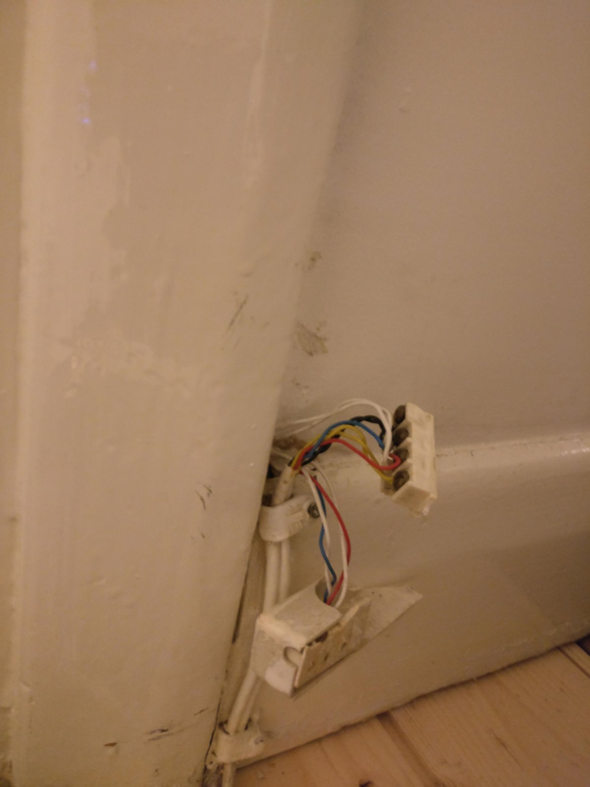

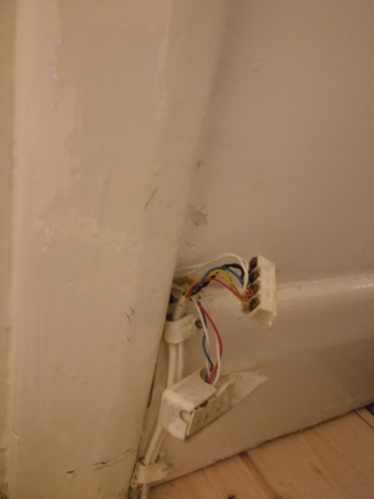

Need a better picture ...the wires that still have the case top on ...IF you have two single wires under a screw each , twist them together and press reset on the panel
Sorry for the late response, on further inspection it was just a blue wire that had broken in two. Connected together and the alarm returned to normal. Can I replace broken junction box with any standard one or block connector or does it have to be something special? I'm just thinking I buy a new one and move the connected wires over one by one?? Thanks
