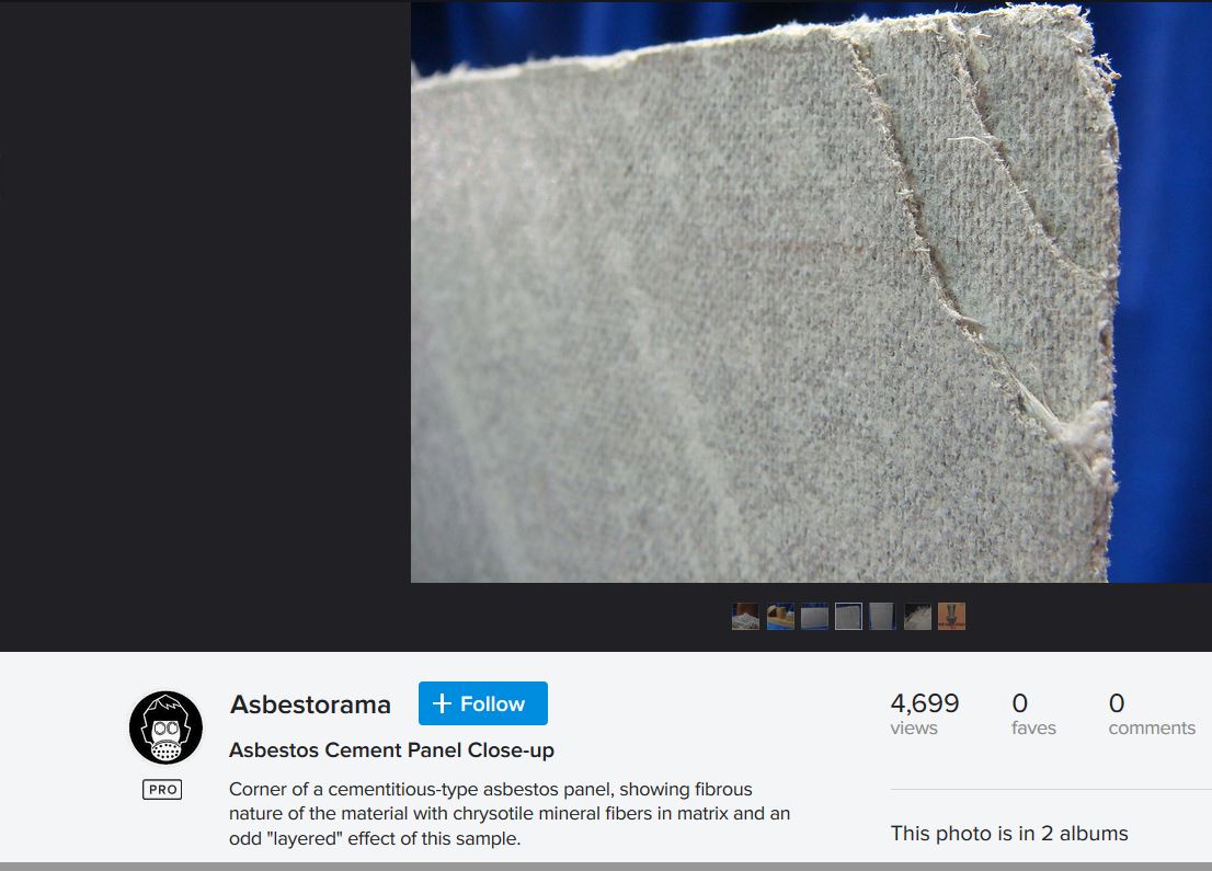

It would never be touched. The shower is just to the other side of it. The wall is tiled that side. I must just check no water is seeping through
Best get it checked anyway.

That wall is asbestos but prob asbestos cement as opposed to the more dangerous AIB but providing it doesn't get disturbed it's ok to leave. But it has already been drilled at some point
