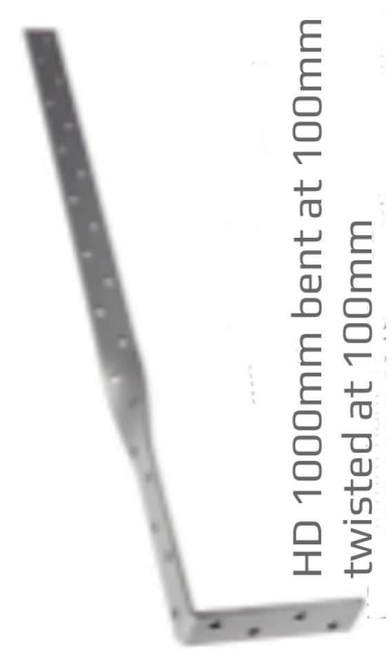

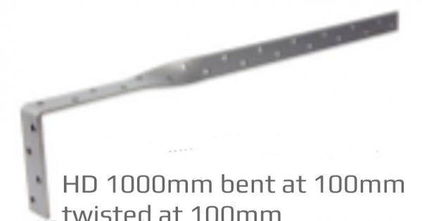

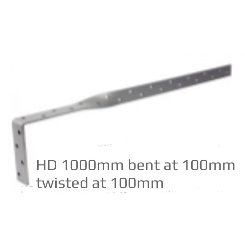

Here's a potentially mad idea - could I just build these into the bricks? I've rotated the picture to show my intended way up, the vertical part would be inside the cavity...
It's 900mm long, so if that bent bit is built in 10 courses down from the top then it would end up sticking up by 150mm above the wall top. It would need some careful placement to align with where the joists will go. They weigh 930g, so hopefully one brick and its kilo of mortar should hold it up on its own just by gravity before the rest are put on top of it.
Perhaps shorter would be better, if they exist elsewhere.
The bent bit is 100mm, but won't go all the way in due to the twist against the wall face. So it should be just under the pointing on the inside.
I might buy one to try building one in as an experiment while building the foundation courses, see if it's totally impossible.

Those ones with an angle and a twist shown above are pretty special. But I'm going to buy an angled only one from Toolstation to play with while I'm building the foundation courses, if a brick is capable of holding one in place before more are built on top then I'm going to buy those shown and build them in. There's no way anything could ever move if the joists are screwed to a tie that's built into the brickwork.

That would work.
However, get the medium duty or 2.5mm straps, as these are easier to bend/adapt.
You'll need to cut the angle part that will go into the joint, as these are normally more than 100mm. Paint any cut ends.
Or just get flat straps and bend to suit.
These would need to be built in at least 9 course/675mm down from the top. Bang a nail in at the subsequent bed joints.

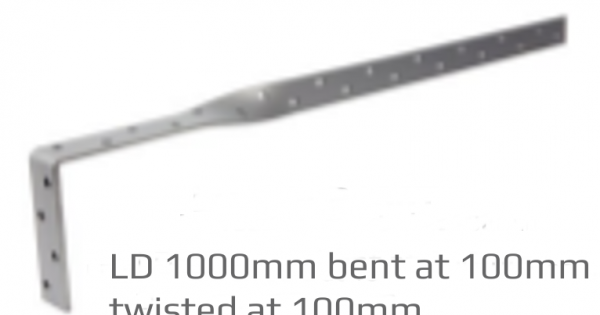

Thanks for the reassurance, I know I'm being a bit unusual with this. There is what they call light duty. These in fact...
This is 2.4mm. The shed is small and will have dozens of these, so they should be easily adequate. They only weigh 508g so hopefully won't topple about before the courses above are in. £2.40 each sounds good too!
These have a 100mm bent bit, so roughly equal to a brick width. But I'll need to leave it not quite full inserted to make space for the twist above, so probably only inserted about 80-90mm, so no cutting therefore the coating will remain intact and will be below the pointing so hopefully no rust stain in a few years.
As a test, I'm getting an untwisted near equivalent from Toolstation today (1000mm, light duty, bent but no twist). When I'm building the foundation courses next week I'll try building one in to see just how annoying it is. I'll jut it out slightly, pretending there's a twist to make space for.
I'll be using fibre cavity insulation, so it should bend and stretch around them OK.

If you use those brackets illustrated upside down, the small bit in the brickwork you won't be able to fix the length of it to the wall...just the wall plate/rafter.
