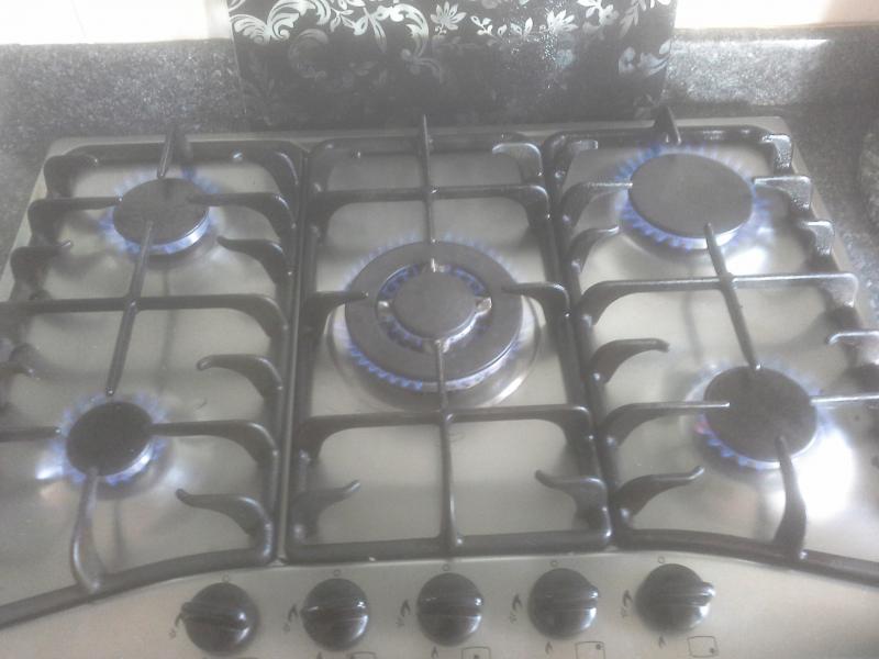

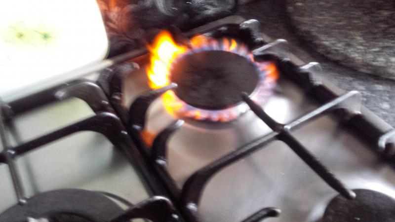

Sometimes my gas appliences burn with a orange/yellow flame as in the picture attached. Now I'm pretty sure it's not a fault with my appliance's as when this happens all appliences do it at the same time.
All four burners on the cooker and the central heating boiler burn orange/yellow at the same time...
Is this a regulater fault or is my gas supply contaminated in some way? Sometime the cooker burners seem to have 's lower flame output to...making me think I'm loosing pressure...will a lose in presure turn my flame orange/yellow?

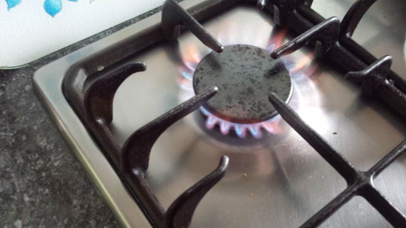

like I say its all ok for now, very intermittant. As per me now working pic

It may just be a failed meter regulator (Donkin etc). Looks too higher burner pressure coupled with the rust burning off.

Second picture is a classic "Baumatic" wet / badly fitted burner .
