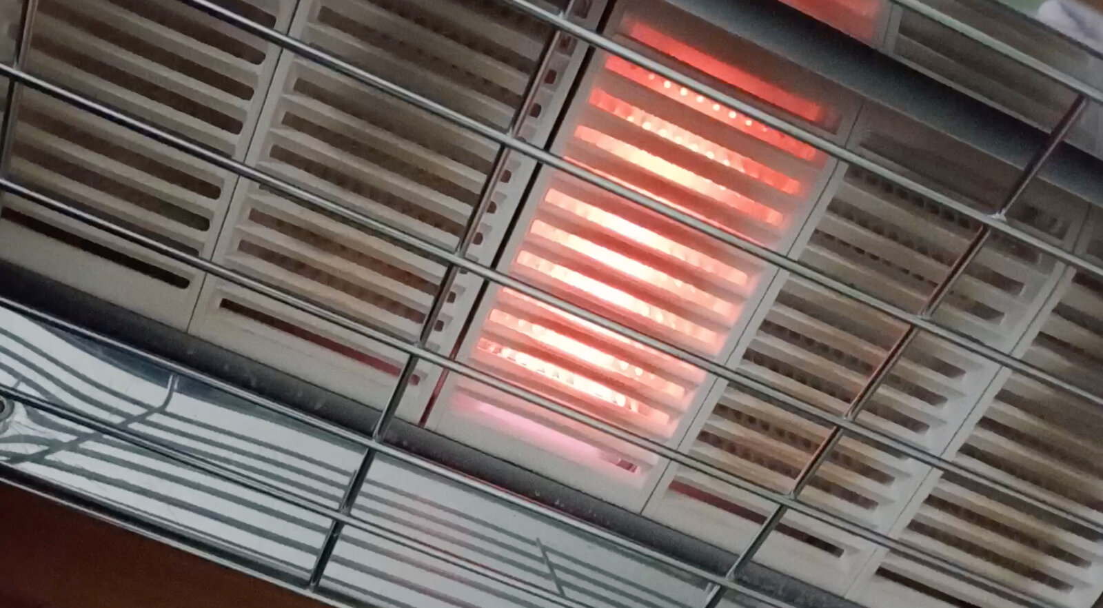

Harry, such is my mind-set, that a video would never have occurred to me! (It didn't occur to anyone else, either, did it?) They say a picture is worth a thousand words, and in a case like this, it is worth many more than a thousand. I did take a short video and tried to upload it to this reply, today. Unfortunately, when I try to select it on my desktop, after clicking on "Attach files" (bottom left-hand corner, here), the file is greyed-out and cannot be selected for uploading. It's an mp4. With still images, there has been no problem in the past. I shall need to take a screenshot from it, which will show the bluish flame well enough. I suppose you (or rather, gas112) will just have to believe me, when I say that occasionally, there is a yellow flicker. Sometimes this may be as high as one and a half inches, at other times, only half an inch. In all cases, they are only momentary. If I can find out how to get the video to this forum, I shall send it. However, even if I succeeded, it would only be an elongated version of the still photo, as the video does not show any yellow flickers occurring.
The radiant looks rather dull red, but I suppose it varies with the demand for gas, at different times of the day.

I would consider a very occasion yellow flicker as a piece of dust or fluff being drawn into the fire and being burnt and would not be any concern. If the flame becomes more yellow more often and/or there is sooting/blackening evident at the top of the radiant, then that would be a greater cause for concern.
Again though, this is only guess work and only an on-site GSR engineer is really the only one that can make that decision correctly.

Thanks Madrab. At least you — like Harry — allow for a possibility that a brief yellow flame is not necessarily the end of the world. By the way, there never has been any soot on the radiants.
