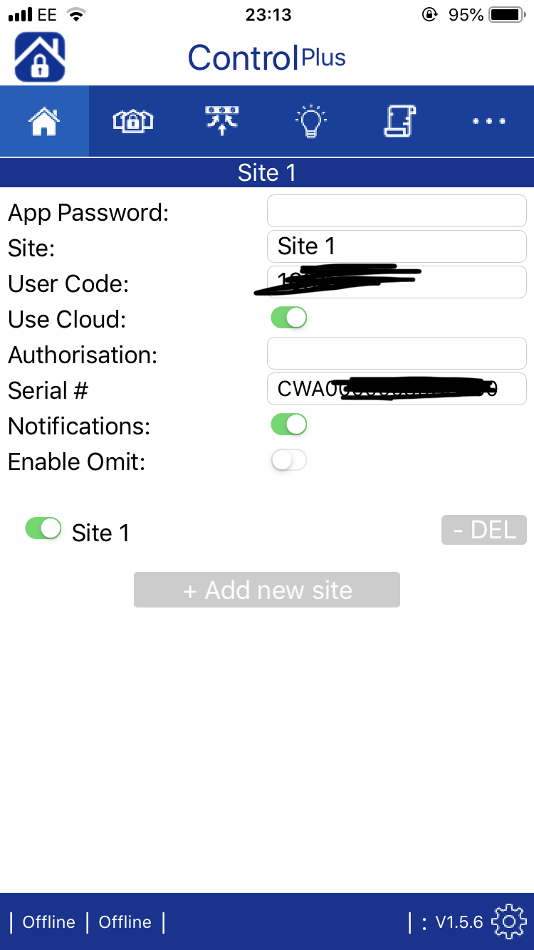

Had this alarm fitted and have an iOS app called ControlPlus which works with the system inside the house.
The alarm has a Wi-fi connection to my router.
Outside the house, the app doesn’t function. It can’t connect.
Does anyone know how to configure the control unit or the app to work remotely ?
Thanks!

if it works inside the house only then I suspect it is only working on the local network so that could be port forwarding.
unfortunately these systems are sold to installers only and its even more closed than that, ie as an installer if I an installer doesn't buy from them they don't offer them support, or at least that's what they told me.
You should go back to the installer, if they don't or wont help you give us a shout and I will see if I can help but cant make any promises.
told its cloud based, so should work from anywhere.
so I would check your mobile data connection, as there shouldn't be a local connection option.

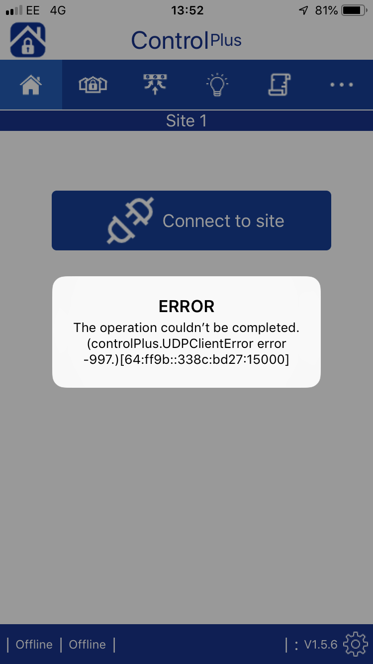

It’s not that I’m not telling full story, I’ve only had this system in a week so still figuring it out. I was told that with the installation it comes with one year of app service included. The app works well when I’m at home but if I try to connect remotely it has an error message (see below)
Yeh I just downloaded it this week. In the settings I can’t see any way of inputting an IP address or anything so I’ve no idea how it’s meant to work remotely, but the app details in the App Store shows it does.
Can’t find very much online at all about this app.
