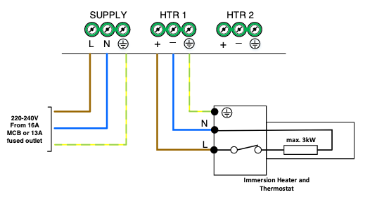

    Judging by your pic, you have an inverter that converts the DC from your panels into AC
    Presumably it feeds the AC into your household circuits and the network.
    I can only see one supply cable into your iBoost, which presumably comes from your household circut.
    I therefore do not believe that your iBoost is capable of supplying DC to the immersion heater.

    I believe the principle is that a remote sensor measures the current at the meter and when the solar generation has spare capacity ( more than the network will or can accept ) the excess is routed to one or two heaters.
    The image has HTR1 and HTR2 and both are labelled + - which strongly suggests it is a DC supply to the heaters,

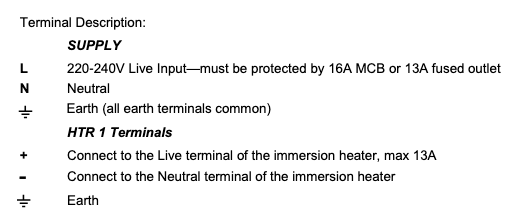

    Bernard,
    I would agree that + - suggests that it is a DC supply to heaters as that is how I also read those labels.
    BUT, the manual, although it does not say DC or 240Vac, it does say Live, Neutral and 13Amps - all suggesting 240Vac.
    So my reading (feeling?) is that the diagrams suggest that the heaters (and so the outputs) are 240Vac:

    it sends power to the heater when current generated exceeds current used in the house. i.e. when it detects current flowing down the meter tails instead of up (subject to a small de minimis).
    But the inverter changes the DC into AC before it goes into the meter and the house circuit or network. The FITS payment is calculated in proportion to the amount of AC sent into the house and network (the inverter and meter don't know where it goes)
    I see no cables carrying DC away from the inverter or into the iBoost. It only receives AC from the house circuit.
