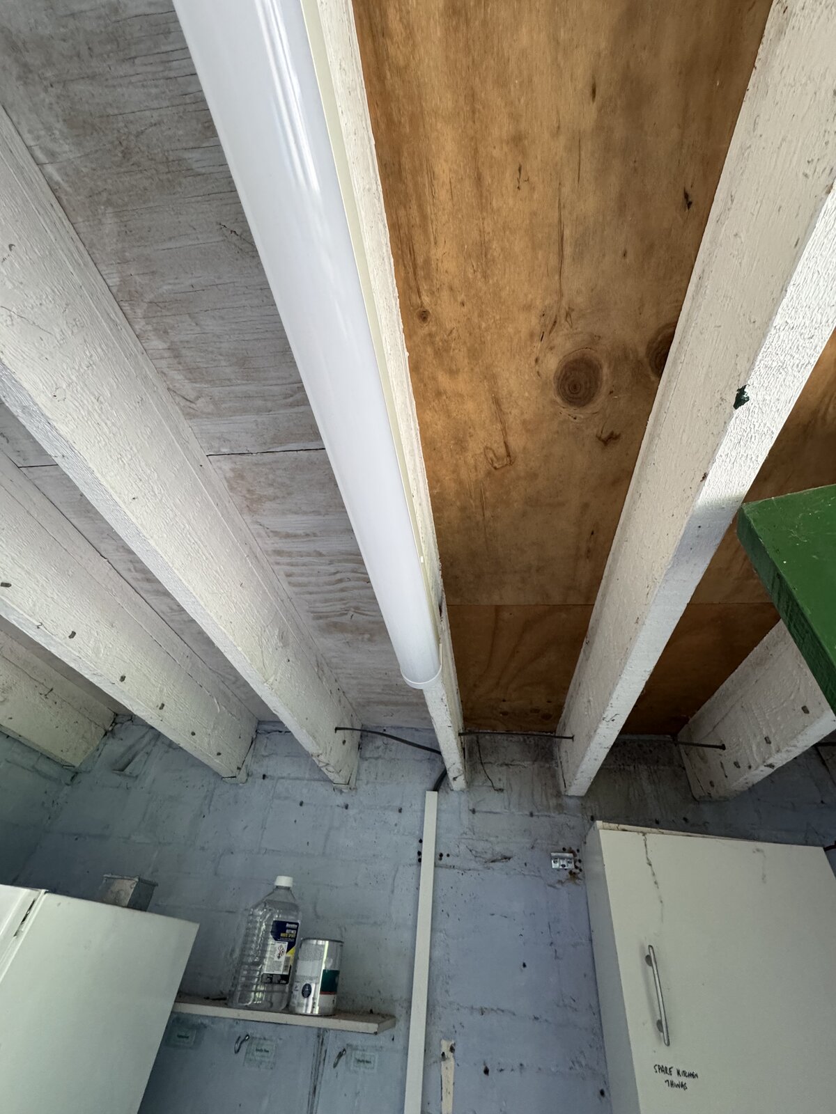

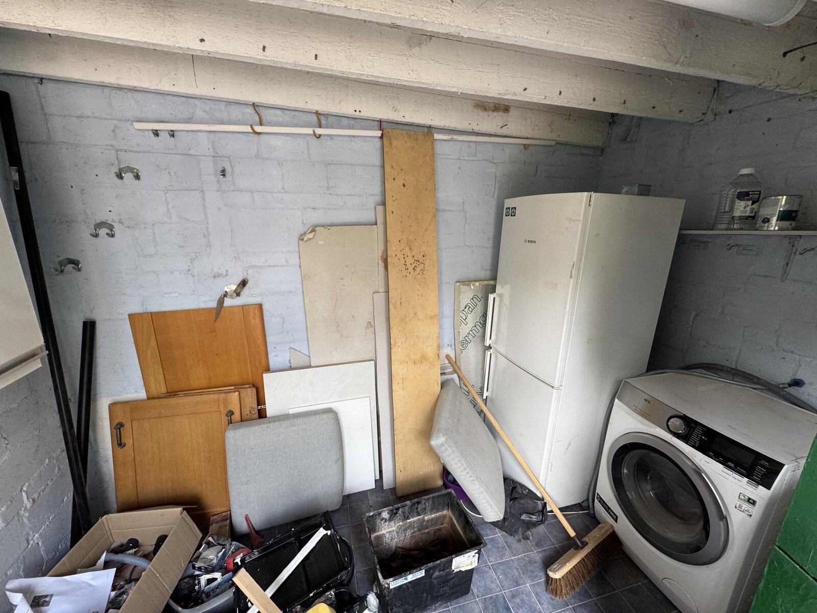

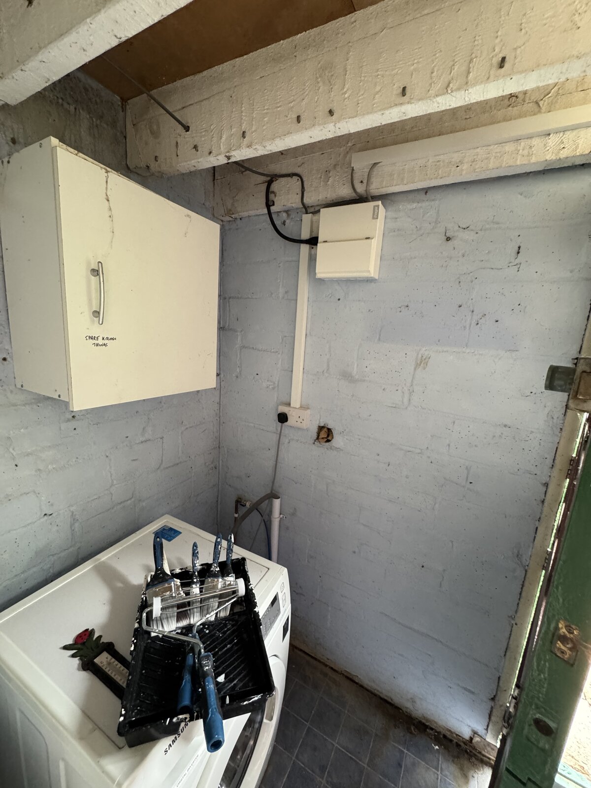

Afternoon,
First time posting and pretty much a total novice, so apologies if lingo isn't right or anything is unclear, but I'd be very grateful for ideas / help.
Recently moved into a new home, and we have an outhouse, which we've had plumbed to contain the washing machine - all great. However, it's a single-skin wall, we've no idea how it'll feel doing laundry in January and it really could be more useful than it is today.
There's the previous owner's fridge (I believe this is now my beer fridge) and we'd want to keep that in, plus a few cupboards / areas to store things. I'd like to get rid of the stuff on the walls, cupboards, hooks and everything.
I think the simplest way to make it a nicer place to go in, and less owned by the spiders, would be to insulate / board / plaster / paint it. I've read and seen I could frame it, insulate with a gap and then plasterboard on top, or I could 'warm batten' it? It doesn't need house level insulation I guess....and it will probably need ventilation to stop damp if washing machine used a lot in winter? It's electrically sound now, electrician has wired a few more plugs and a fuse box as well as light, which he'd help me with place on new boards or whatever as needed.
Plastering I wouldn't go near, but I'd like to try and get to the point it could be plastered. I'm just torn as to which route to take to not lose lots of internal space and not go too OTT as a first-timer.
Pictures attached, but it's 308cm wide, 245cm deep, 210 to the joists for roof and 229 to top of ceiling.
