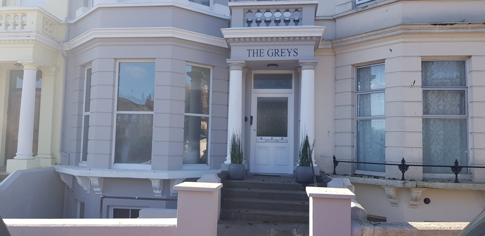

Hi All,
The Outside light has not been working for a while and looking to get that sorted and so to get the best option possible moving forward.
as per picture attached, bedroom are located in the front of the building so we want something quite dim rather than the usual flood flash light.
1 - Either something with sensor that will detect movement
2 - or something that will come on by itself when it is night time.
3 - We thought about just normal light that could be left on all day long too or that could be switch on from the inside.
Any suggestions and considerations for each of these options?
Many thanks,
Jeremy

There are lights out there that will do all three.
They can detect the light level and come on, or detect movement and come on or can be overridden with a switch.
I just fitted some 14w LED ones in my company toilets that will do all that but are bright so you need a lot less than 14w.
Cannot remember what the make/model is - why not go look at a lighting shop, and ask them?
(I'm including online stores in this)
The sensors in either 1 or 2 will consume about 3 watts 24/7. A quite dim light that you require wold be something like a 5 watt LED. Having one of the above sensors on 24/7 plus light when required would consume about the same amount of juice as having the light on 24/7.

A nice building like that will look tacky with a light going on and off, i would use one with a built in photocell so on all hours of darkness, a low wattage led with nice base, not a cheap plastic one.
I would also look for a warm white 3000k too as not so harsh
A plastic robus golf wont look to bad though.

For once, I think that agree, in concept, with winston ... given that you only want a small amount of light, anything that detects motion, or switches on a time basis, will coinsume a small amount of electricity - such that, in terms of energy consumption, you probably might as well leave a very small LED on 24/7.
Having said that, my daughter has one like this (click here) (only £6.99) by her front door ... being solar powered, it consumes NO electricity at all (and needs no wiring). It comes on very dim throughout the hours of darkness, and then brightens up (to quite a reasonable level) when it detects motion. Hers is still going strong after about 3 years in service (which is hardly bad, at the price!) ...
Kind Regards, John
What's wrong with the light already in place? It looks like a 2D fluorescent, if so it might only need a replacement lamp or at most it'll only want a ballast replacement
