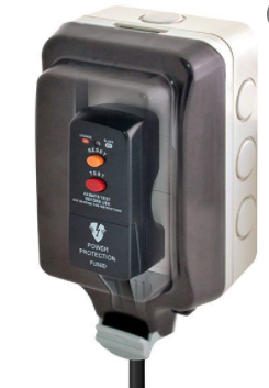

They do make an outside socket with a cover big enough to accommodate a 'wall wart' adapter.

An outdoor socket only works if the power brick has a regular plug and cord rather than being supplied in wall-wart form *and* the power brick is waterproof. There is also the worry of misuse as you suggest.
Fitting a socket inside a regular weatherproof enclosure solves the space issue and if the enclosure requires a tool to open mitigates the misuse issue but creates another problem, how to get the cable from the light (which will likely already be terminated at both ends so can't be passed through a normal gland into the enclosure.
Timeguard make a couple of wall mount enclosures with a socket strip inside and with cable entries designed to accomodate cables that have stuff on the end. It comes in two versions, a smaller one with a 2 gang socket strip and a larger one with a 4 gang socket strip. The instructions don't say how the lid is fixed down but from the pictures it appears to be screwed down which reduces the probability of misuse.
https://www.tlc-direct.co.uk/Products/SMWP401.html
https://www.tlc-direct.co.uk/Products/SMWPM02.html
An outdoor socket only works if the power brick has a regular plug and cord rather than being supplied in wall-wart form ...
As sparkwright has said, one actually can get outdoor sockets designed to accommodate wall-warts etc. - such as ....
