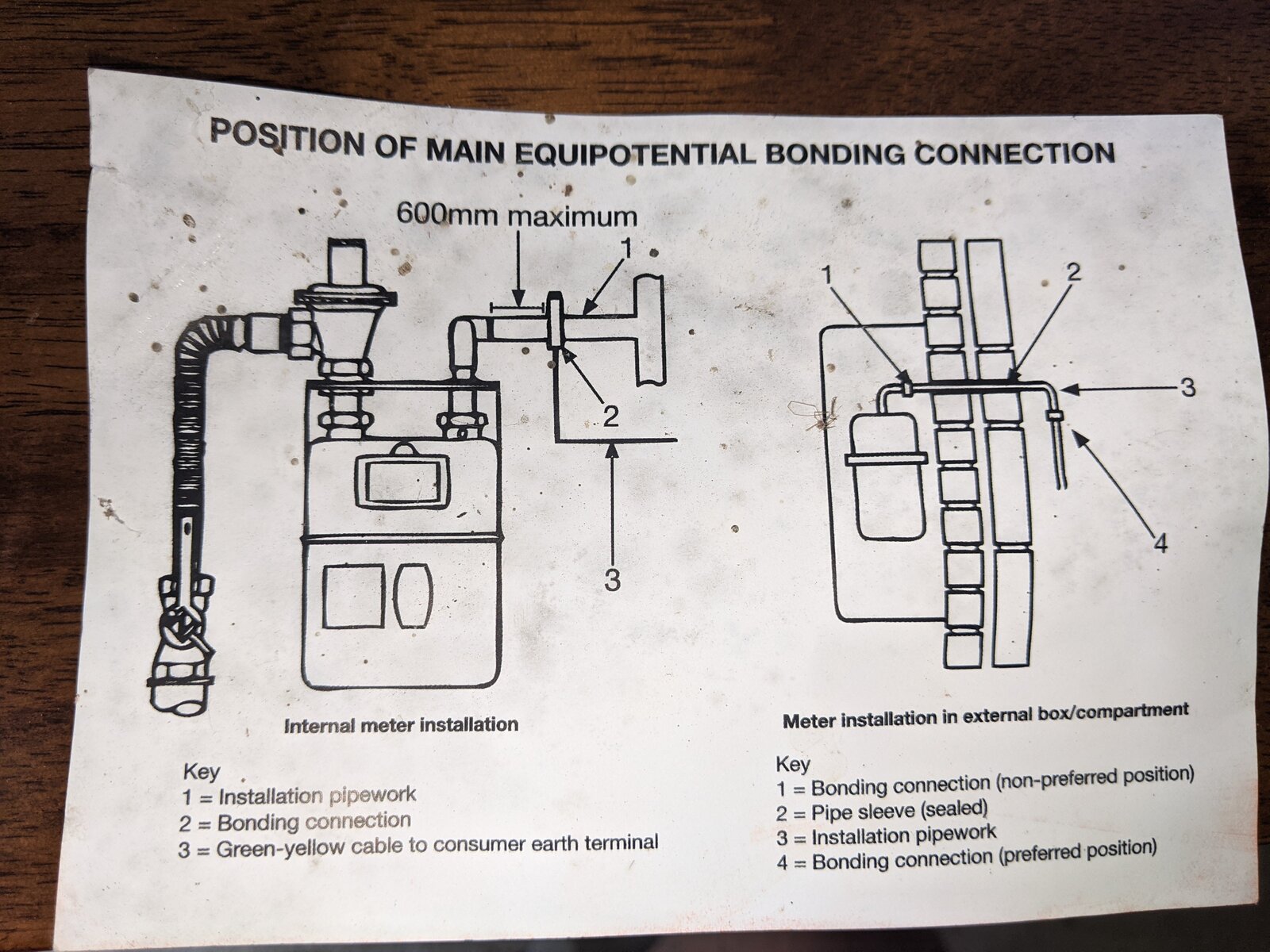

Btw the keen eyed among you may have noticed the bonding cable on the gas pipe. There was a note in the gas meter chamber about this (see pics). Seems like a simple fix though - I'll just move the bonding to the inside of the house - before the pipe exits the building.

The pictures you show only apply when the meter is inside - no they don't. Look at picture two more closely. There are two diagrams on it; one is for when the meter is inside, the other when the meter is outside

Ok. It is also wrong. Position 1 is perfectly acceptable.
The SIEMENS diagram also says that position 1 is perfectly acceptable. Just not Preferred. The problem with my setup is that it is not Position 1. Position 1 is where the bonding is inside the meter box.
My set up is that the gas pipe travels externally outside the meter box - then enters the property. I think the siemens document is saying in that situation the bonding should be inside the property (or inside the meter box as a secondary preference)/. The easiest thing for me would be inside the property. I'm thinking they are basically protecting it from the elements?
Or just on the outside of the wall.
Then you are mistaken.
Gas bonding should be connected at or near the position it enters the property. That can be inside or outside. If outside, the clamp needs to be suitable for use outside.
600mm is a recommendation, not a requirement.
Gas persons are often clueless about what is actually required, and there are plenty of examples of supposedly 'official' documents and labels which are wrong.
It was put there because meter installers have a checklist of things they need to see, and if they can't see those, they must leave a label, notice or whatever else.
There was no understanding or consideration of what might be required for your particular installation. Just a checklist of 'yes/no' items.
This is what's actually required:
Within 600mm from the meter outlet where practicable and where the meter is inside.
If the meter is outside, it's at the point of entry to the building or as near as practicable, which can be inside or outside.
The connection must be accessible, which is why it's often easier to put it outside.
The point it enters the property may be concealed behind kitchen units, boxed in or similar.
