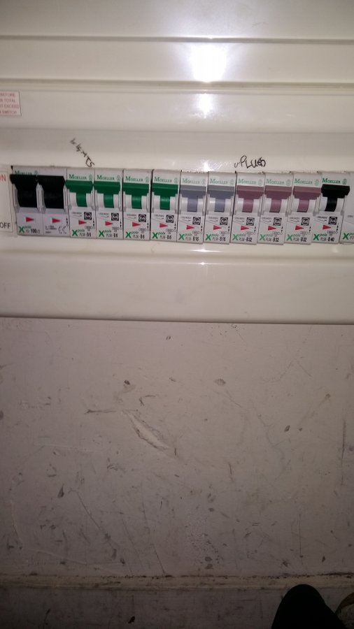

I have a electric hob that is connected to the main cooker supply, am planning on getting a new cooker also electric, can i wire the cooker to the same connection as the hob or will i need some sort of dual way connector. Thanks in advance

Ok the hob is 6.2 kw, the cable is 6mm,the new appliance is a oven and grill to be hardwired the oven is 0.79kw and the grill 0.99kw , as for the breaker size in the fuse box they all say 230/400v

It's the current rating of the breaker on the cooker circuit we need to know about - it will probably say something like "B32".

The oven has no plug, as above the oven is 0.79kw, the grill 0.99kw...

They also say B6, B16, B32, B40.....
