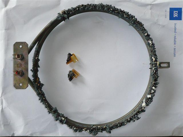

candy oven stopped working, pulled back off to find element had burnt out, all split and puffed up (taken on an appearance of cauliflower)
I replaced it with a new one, which has worked for the last two months but has just gone again!
Clearly something else is also at fault. I'm guessing the thermostat?
Any ideas chaps?
Possibly a bad connection caused by the first failure of the element. Look closely at the bit where the element connects, is it worn, pitted, gunked up etc? if so you need to get it looking as clean and bare-metal as possible for a sound connection (wire brush etc, mini torch, lots of cursing . . .)
And don't forget to power down first :!:
I very much doubt that the thermostat is faulty because that would result in over-cooked or charred food from the oven.
It's more likely that the replacement element was sub-standard - and sadly the next replacement won't be a lot better.......

I think you've nailed it Prince of Darkness, I couldn't find a part number on the old element so I looked on the internet to find a replacement based on wattage and dimensions.
The replacement element was only £12, which as you suggest was probably 'sub standard'
I guess the old adage is true - you get what you pay for!

Presumably a fan oven?
Is the fan working? Free to rotate?

yes Frank the fan is working fine.
I've taken a photo to show the damage to the element and also the plastic covers on the spade connecters which have melted.
Incidently, the original element was rated at 2.2kw but the replacement was 2.5kw. Although I don't know how much difference this would make as the thermostat would surely kick in as soon as it got up to temperature anyway.
Any more ideas guys, or is simply the fact that the replacement element was probably of poor quality?
The element should have been replaced with the correct wattage one even if it was a pattern part, the 2.5 kw one will heat up a bit quicker but will draw more power down the wiring loom than it was initially built for.
Some ovens (indeed many white goods) have been modified during their production run, you need to check the serial/batch number as well as the model number.
With some ovens due to problems, lower rated elements have been fitted and in some cases safety stats removed or replaced with lower temp versions.
Some part sellers will not make you aware that your particular model may have been made slightly differently and require different parts.
Reputable parts sellers should take the part back and provide a replacement as it is less than 12 months old.
